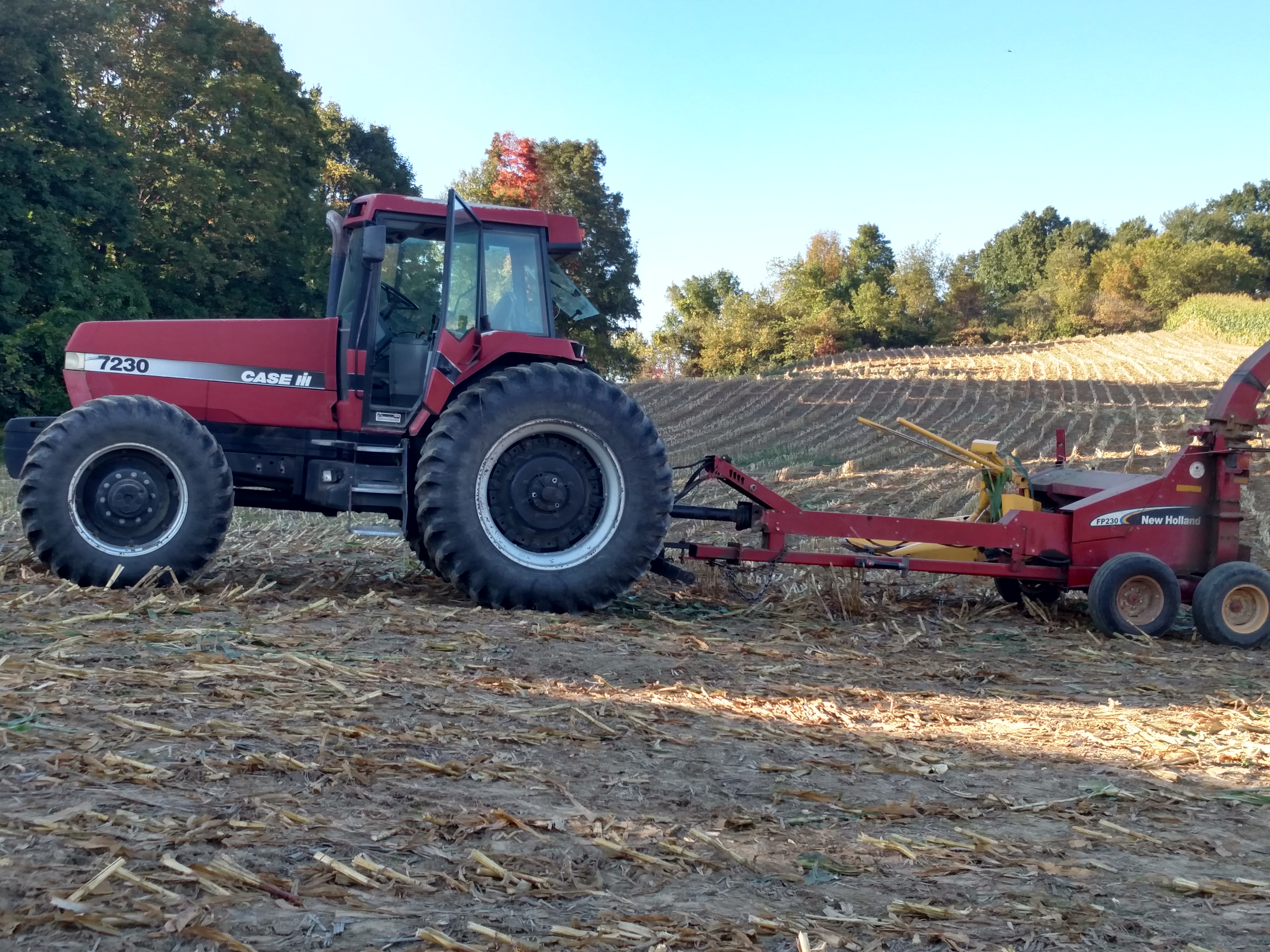

The taxes and regulations are all that keep this state out of being one of the better, I was born and raised here grew up on a dairy farm, and still help my
brother on the farm but he has switched over to beef now.
View attachment IMG_20170922_164715949_HDR.jpgView attachment IMG_20170922_164916413_HDR.jpgView attachment IMG_20170922_164558816_HDR.jpg
