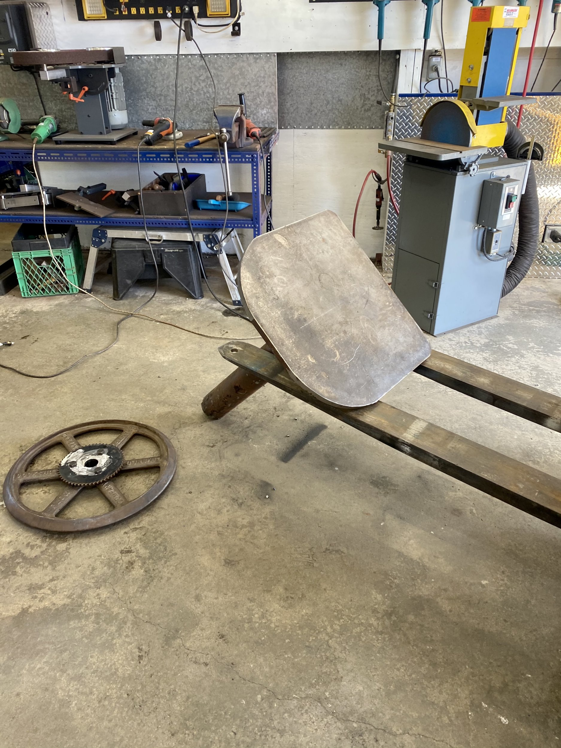

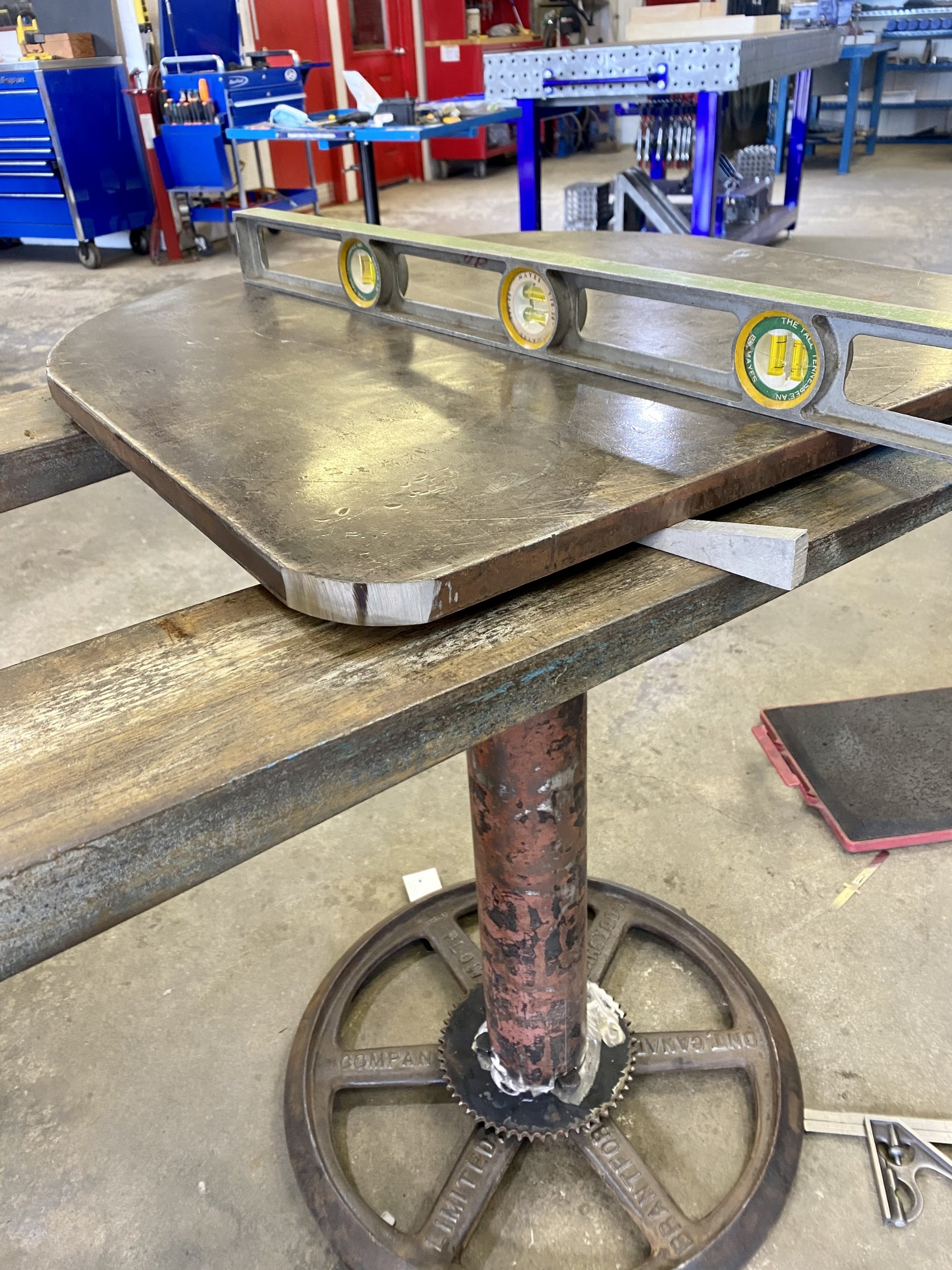

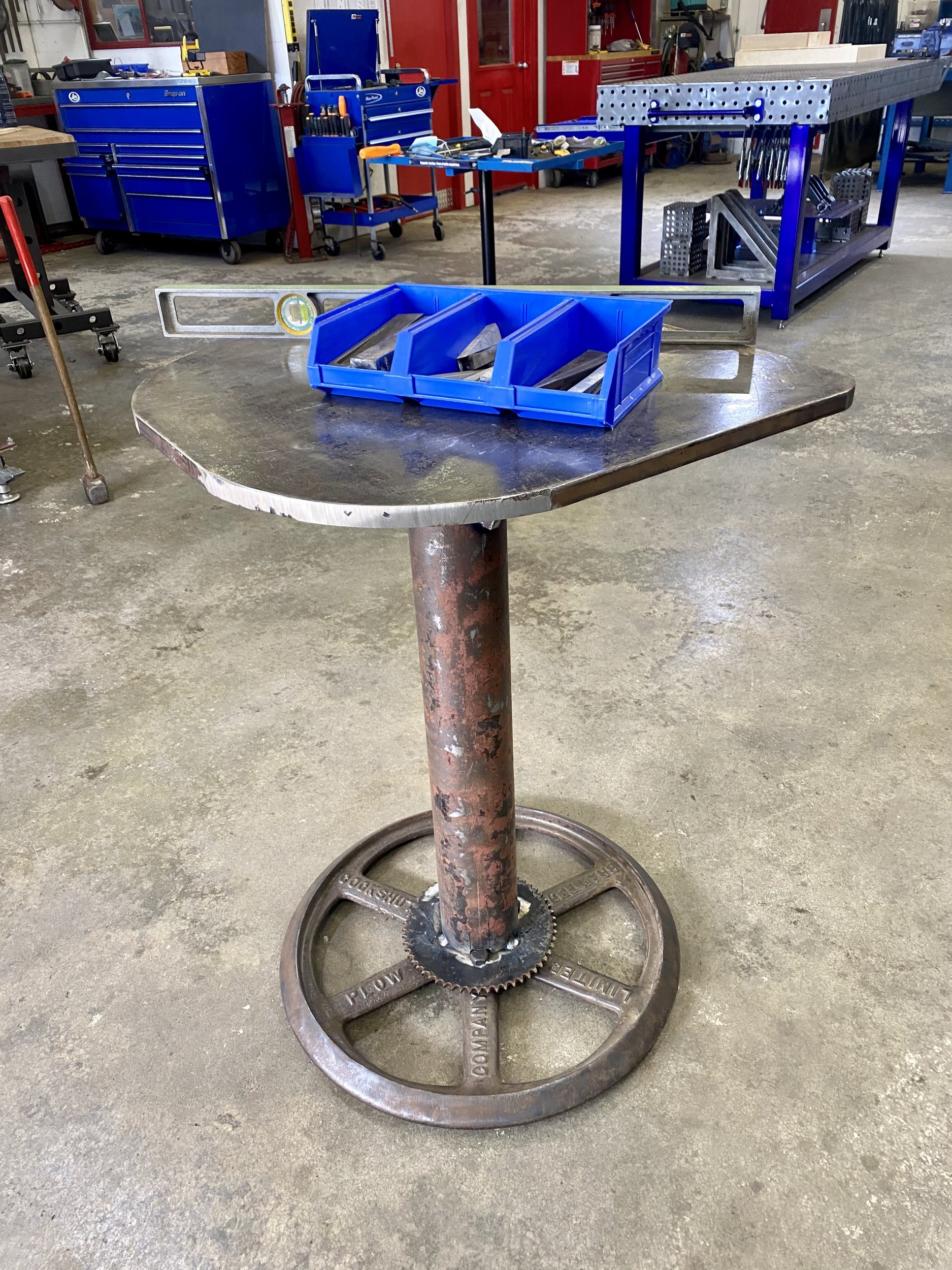

I decided to use this scrap piece of 3/4" plate for a little welding table
Here it is with two corners radiused and ready to have 6" heavy wall pipe welded for the pedestal.
old cast iron seeder wheel to be used for the base. Holes tapped for 5/8" bolts
Sprocket drilled for matching holes.

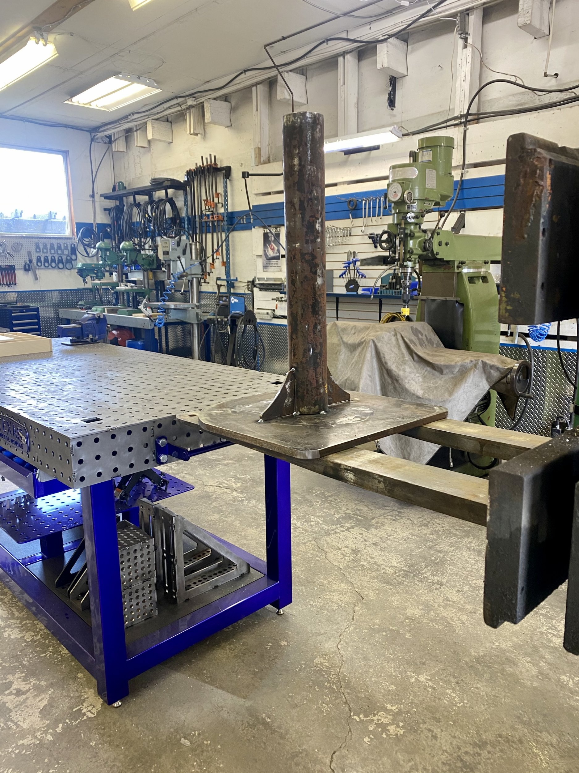

All tacked up....
