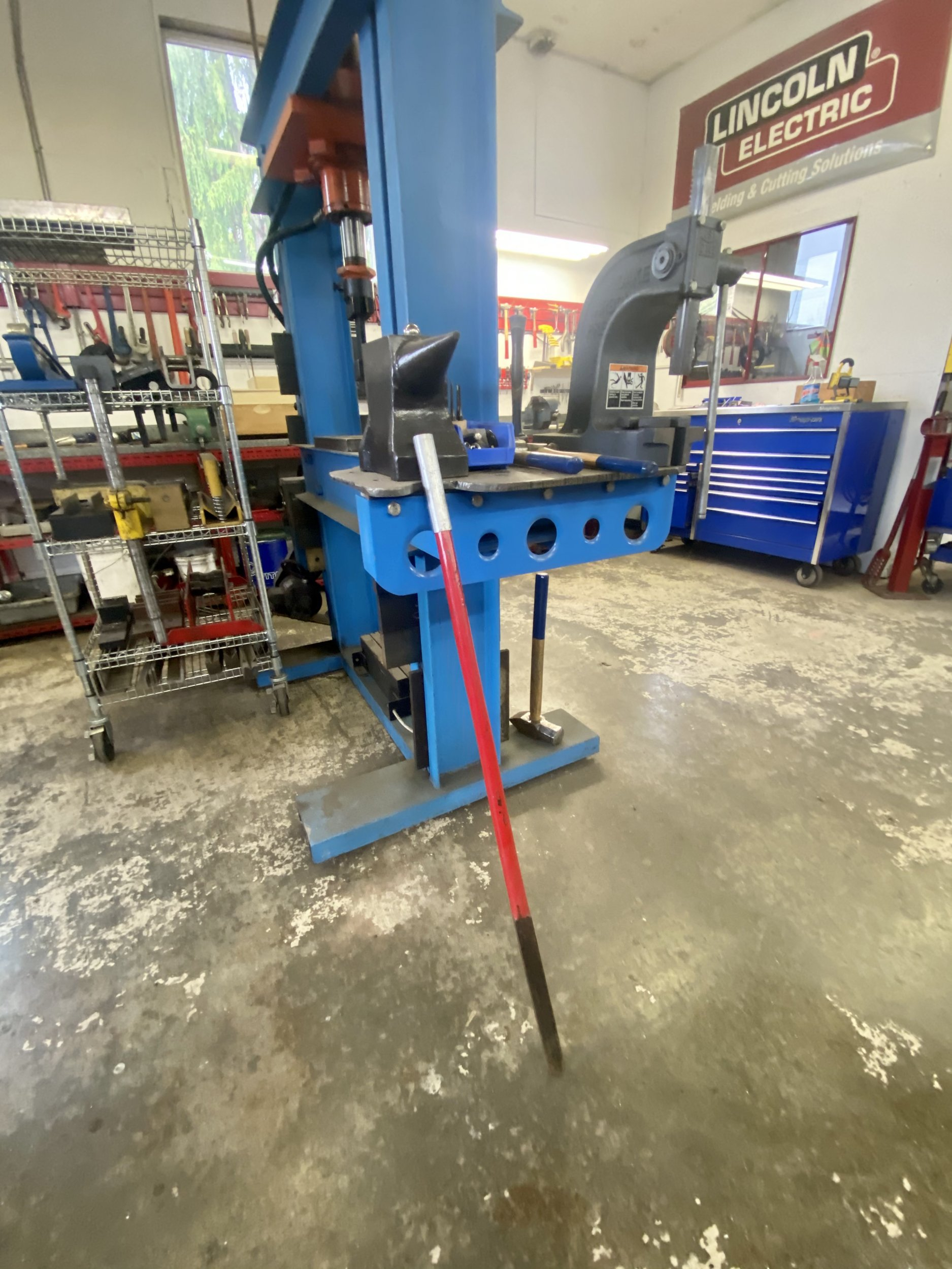

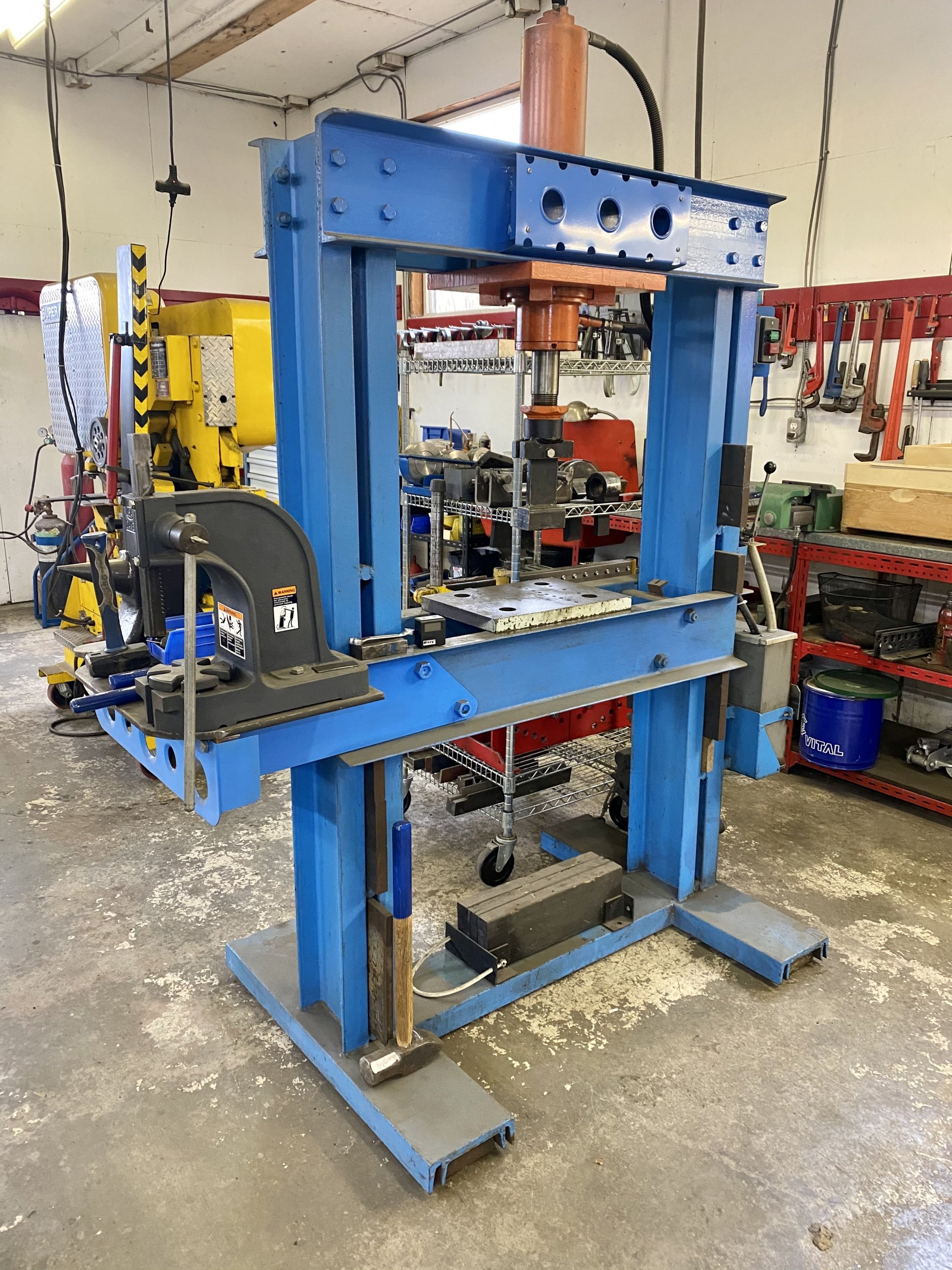

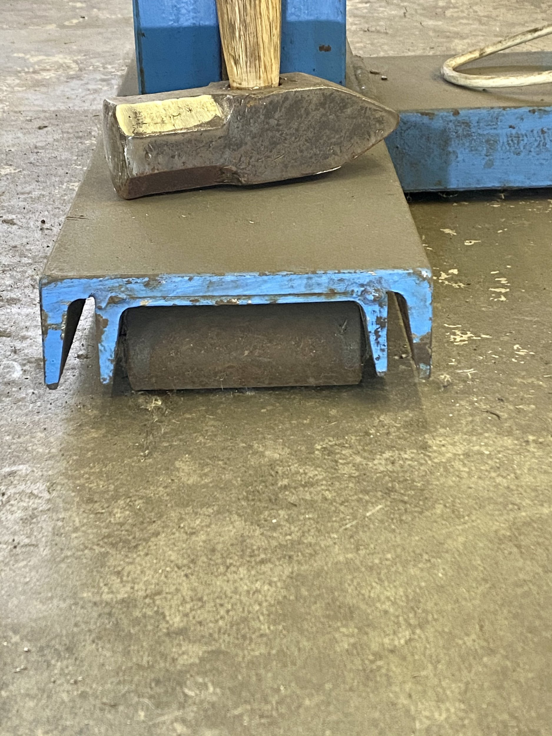

I'm not sure what mine weighs ....
but when I built it I machined rollers out of heavy walled 2 inch pipe....
It is easily moved by two NFL players or me with this pry bar....

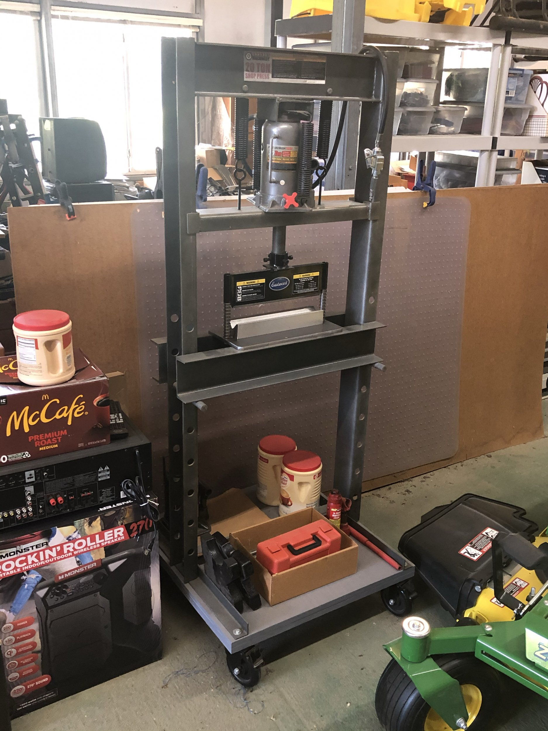

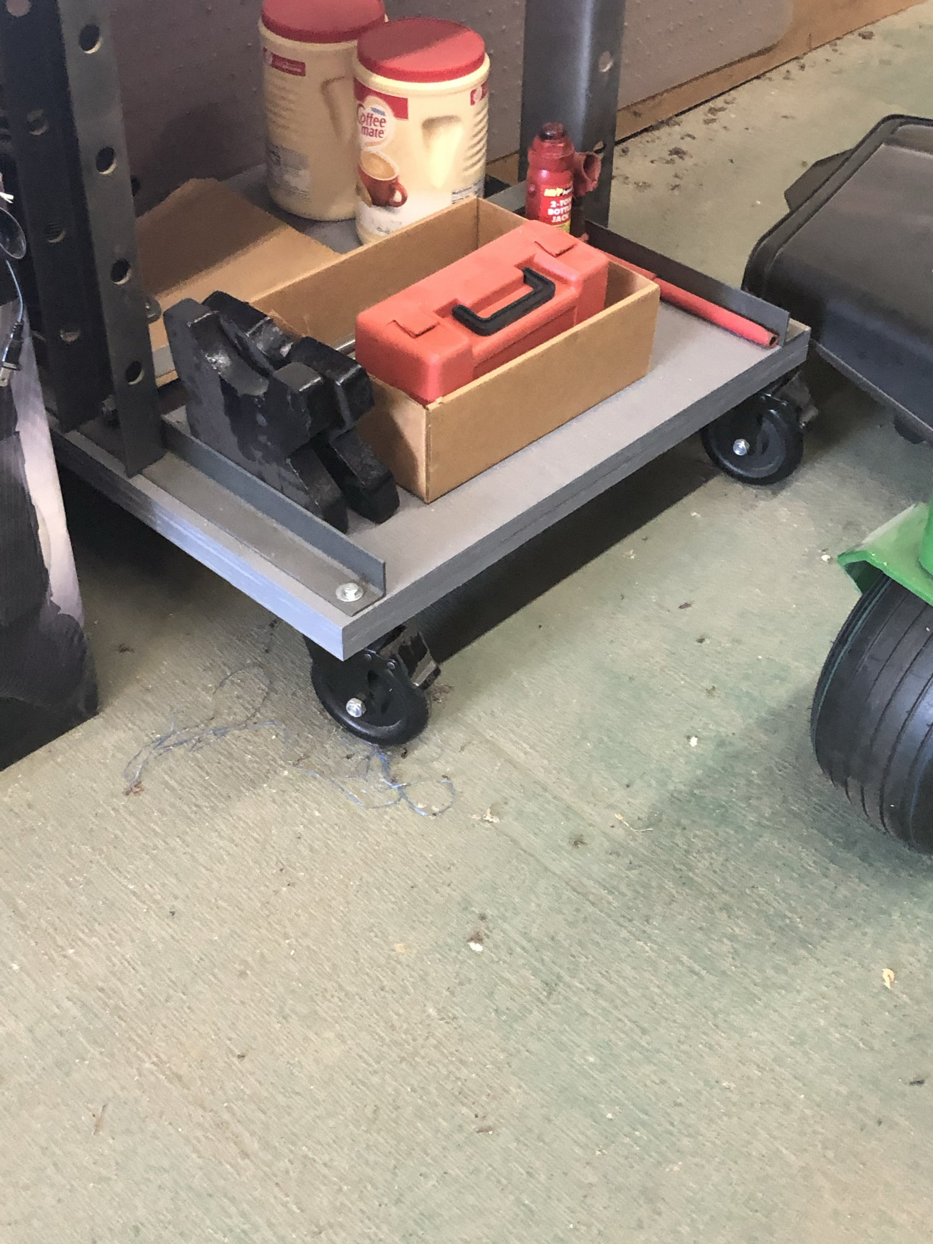

Yep... with my cramped shop almost everything including my press is on casters. Even my tall metal storage cabinets. About the only thing that is not, is my solid wood work bench.
