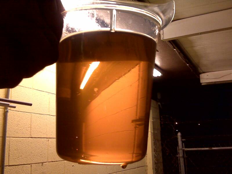

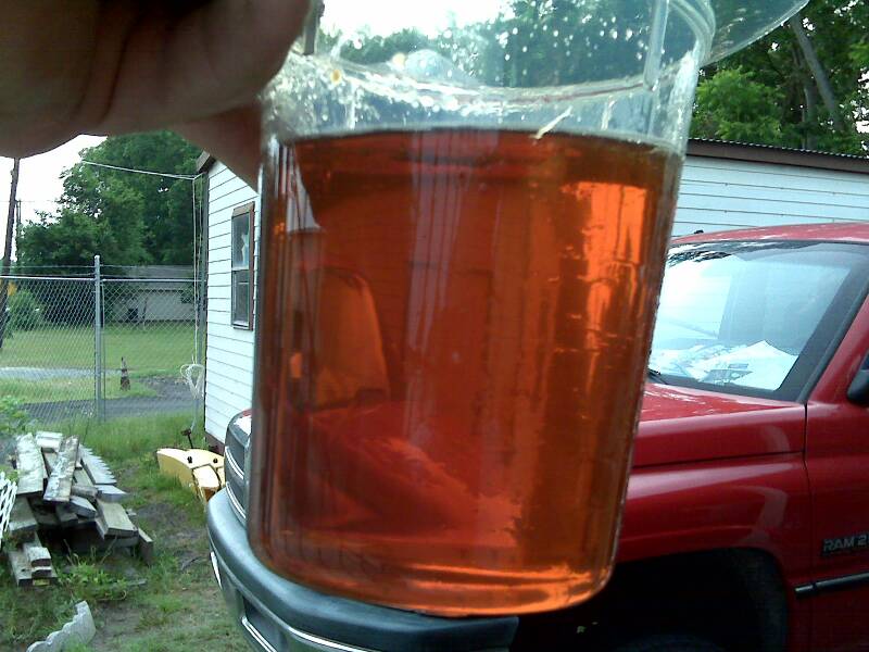

Biodiesel is good stuff. I've made thousands of gallons of it.
