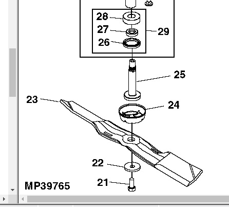

I have a 2011 JD 2520 with a 62D Mid Mount Mower. In preparing for mowing season, I pulled the blades off the mower, sharpened them, and reinstalled. This I've done at least twice per season since 2011 without issue. Today though, I complete the process of installing the deck on the tractor. With the deck raised and medium RPM, I engaged the PTO as a test. There was a terrible thunk, so I quickly switched off the PTO and shut down the machine. Upon inspection, two of the blades slapped each other as they passed. There was evidence of this in the metal. As I rotated the blades by hand, sure enough they hit each other.
Have I just gotten lucky with the alignment all these years? From the output end, does the first blade need to be positioned North and South, second blade [middle] East and West and the third blade North and South? I honestly do not know if this makes a difference or if I've done something else incorrectly. Sorry for the dunce question, but I could use some input. Thank you!

My guess would be that one blade wasn't centered on the spindle which would offset one maybe an 1/8" or so.
I never heard of tractors having timed blades. Little garden tractor types but they have special belts also.

Agree with wrong mounting of blades. Once mounted correctly, they won't hit each other..
   / Blades Collide on 62D Mower Deck #5
I wonder if you have two blades mounted wrong (not over the spindle shoulder). On my 62D I don't think one mounted wrong would cause a hit. Upside down won't make a difference in clearance. Take them off and start over and you should be fine.
   / Blades Collide on 62D Mower Deck #6
Maybe you didn't get the blades fully seated on the spindle before putting the nut on. It should be a close fit with no slop, and with no question about north/south and east/west orientation.
   / Blades Collide on 62D Mower Deck #7
Yep, I'm with most others here. You didn't get them properly seated on the shafts. This should be evident by the fact that the blades aren't tightened up against the spool, bit of a gap on top of the blades??

As someone else mentioned, only way to stay "in synch" would be notched belt and pulleys. By design the blades are "creeping" all the time.
