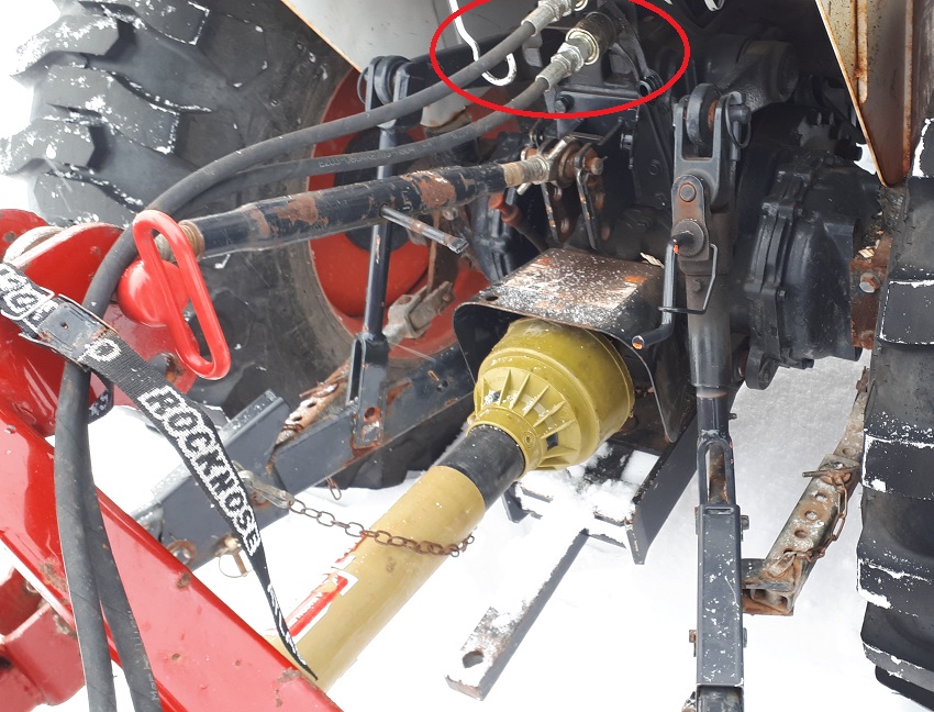

The 3 point will only work if the remotes are centered in the N position.
I see two hoses hooked up to the tractor, what are you using the remote for that it has to be engaged all the time?

Hello !
these two hoses are connected to an electric valve to power my snowfall.

Seems to me the snowblower is driven via the rear PTO. One must assume then that the hydraulic flow are to control the chute rotation. If an electric switch is involved, what does it do? Does it rotate the chute? If so, I'd think you need to remove it and it's hydraulic mechanism and rotate the chute via your rear remotes. I'd to one without the detent.

Im guessing the OP has one remote on his tractor which is connected to the snowblowers 2 electric valves which operate the rotator and deflector.
