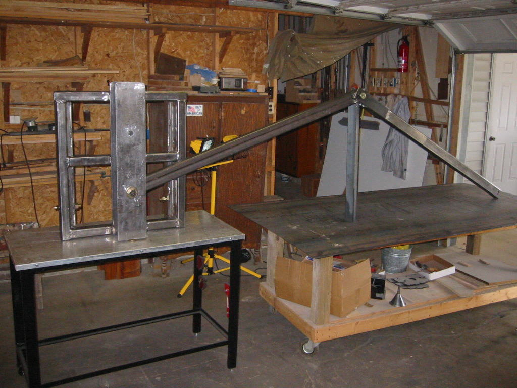

   / Boom mower deck Help
Here is a pic of the boom assembly.
If anyone has used a hydraulic motor to power a mower, I would like to here from you. Would like to know about motor size what rpm the motor would turn.
I need to order all my hydraulic stuff, so I am open to suggestions.
Thanks, Joe

   / Boom mower deck Help #8
Pics look good. I'de like to know about a hyd. motor too, but do you have the hyd. on the machine to run it all while still mowing? Problem I ran into and still looking for the solution.

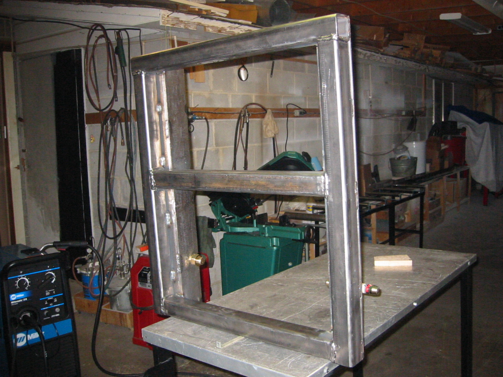

#9
I am going to mount a hyd. tank on opposite side from boom for some counterweight and setup a complete hyd. system to power the cutter blades.
Looking at a 12 gpm pto pump to supply the fluid power and some kind of freewheel motor control valve to control motor. I am not sure how many rpm's
the hyd. motor needs for good blade speed. This will probably effect the size of deck I build, which is next project.
The attached pic shows 2 in sq. top tube so 1 1/2 in sq. tube will fit inside to mount tank.
Joe
