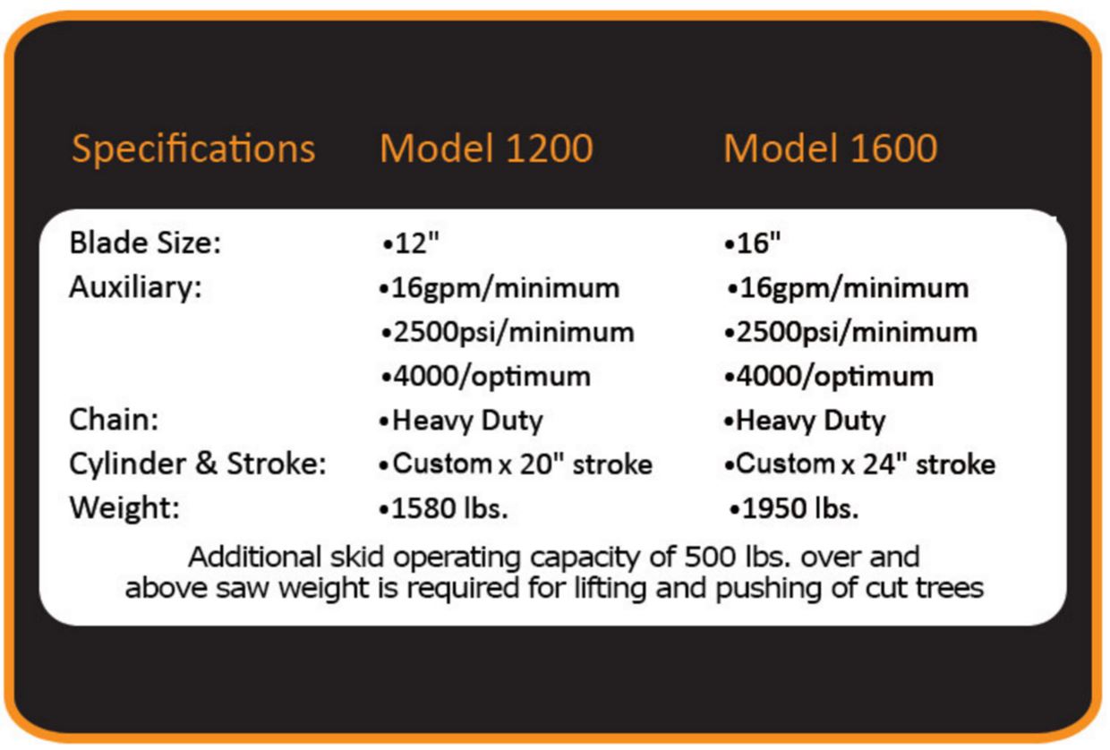

Don't think your tractor is big enough. Here are the specs: Marshall Tree Saw - Models/Specifications
The best way to run a tree shear on the front would be with a PTO pump and a hydraulic reservoir.
