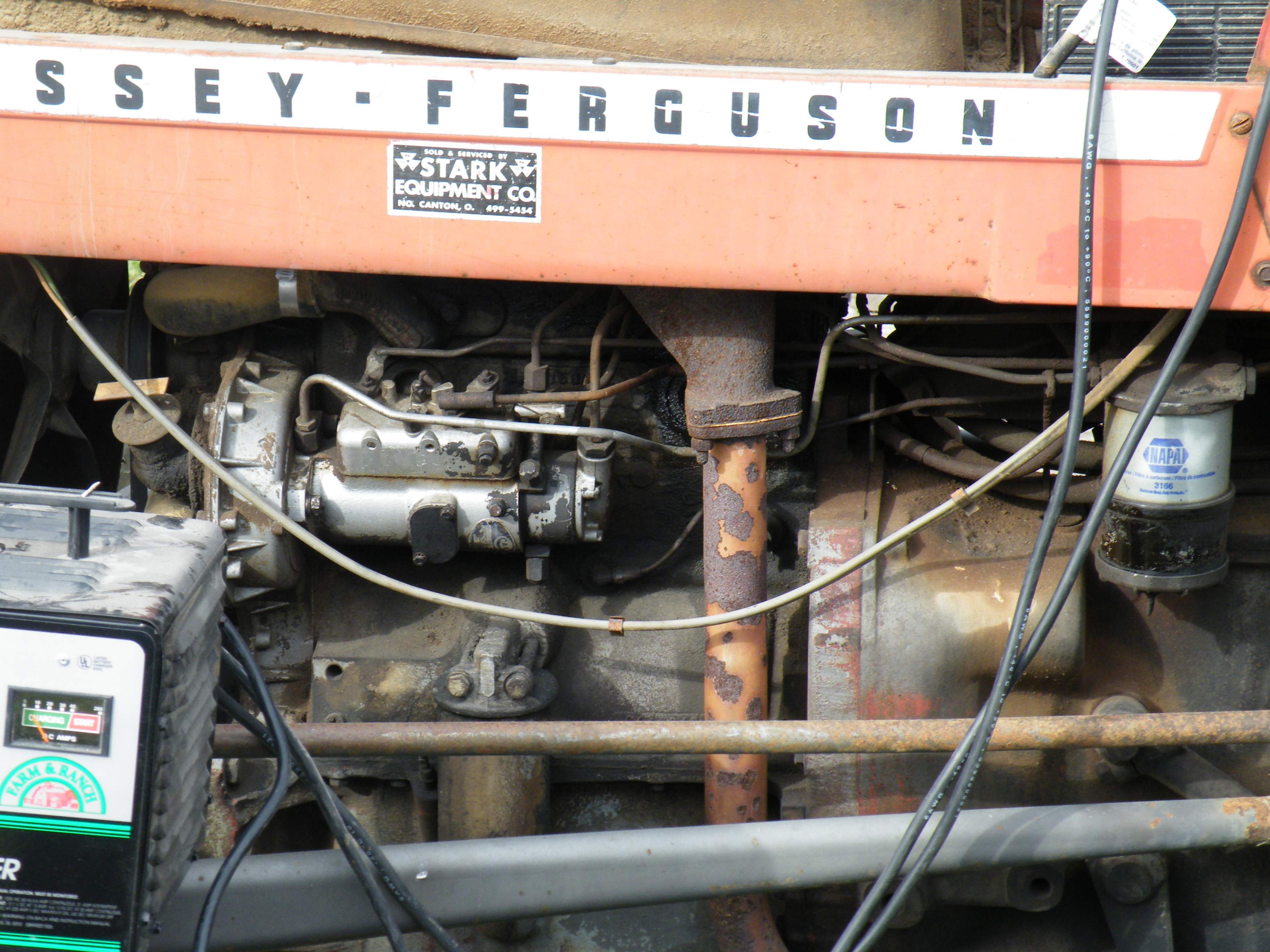

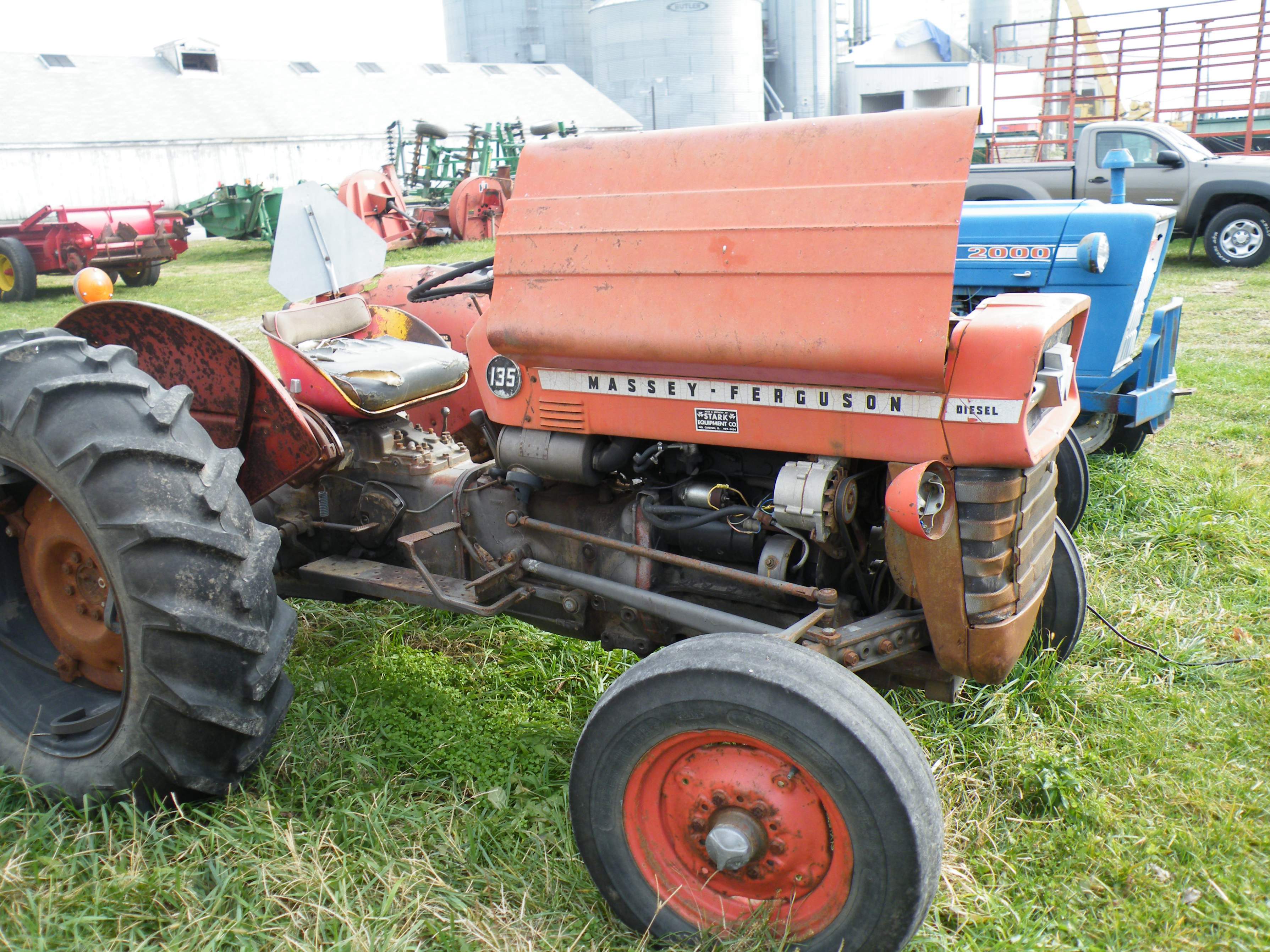

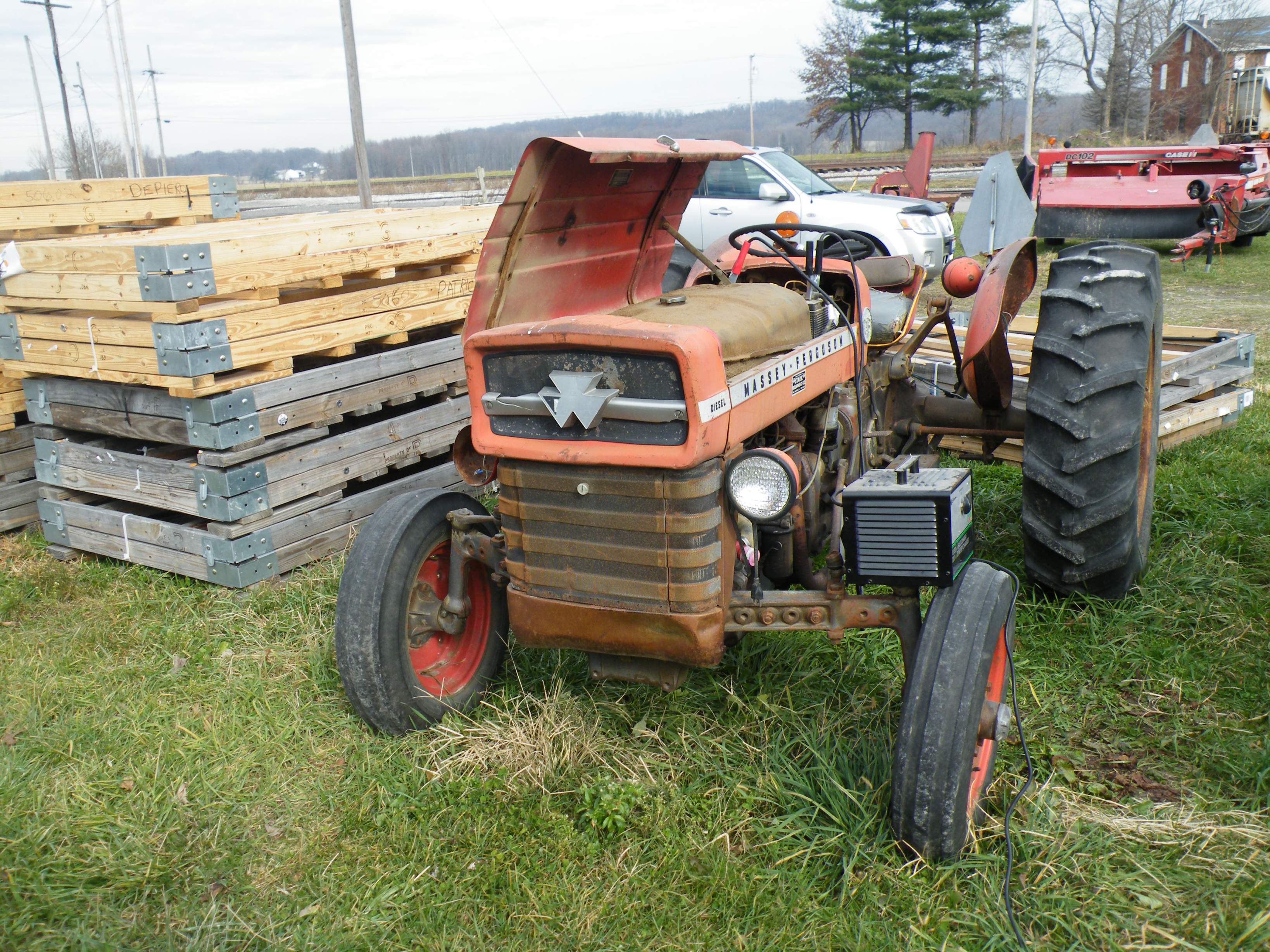

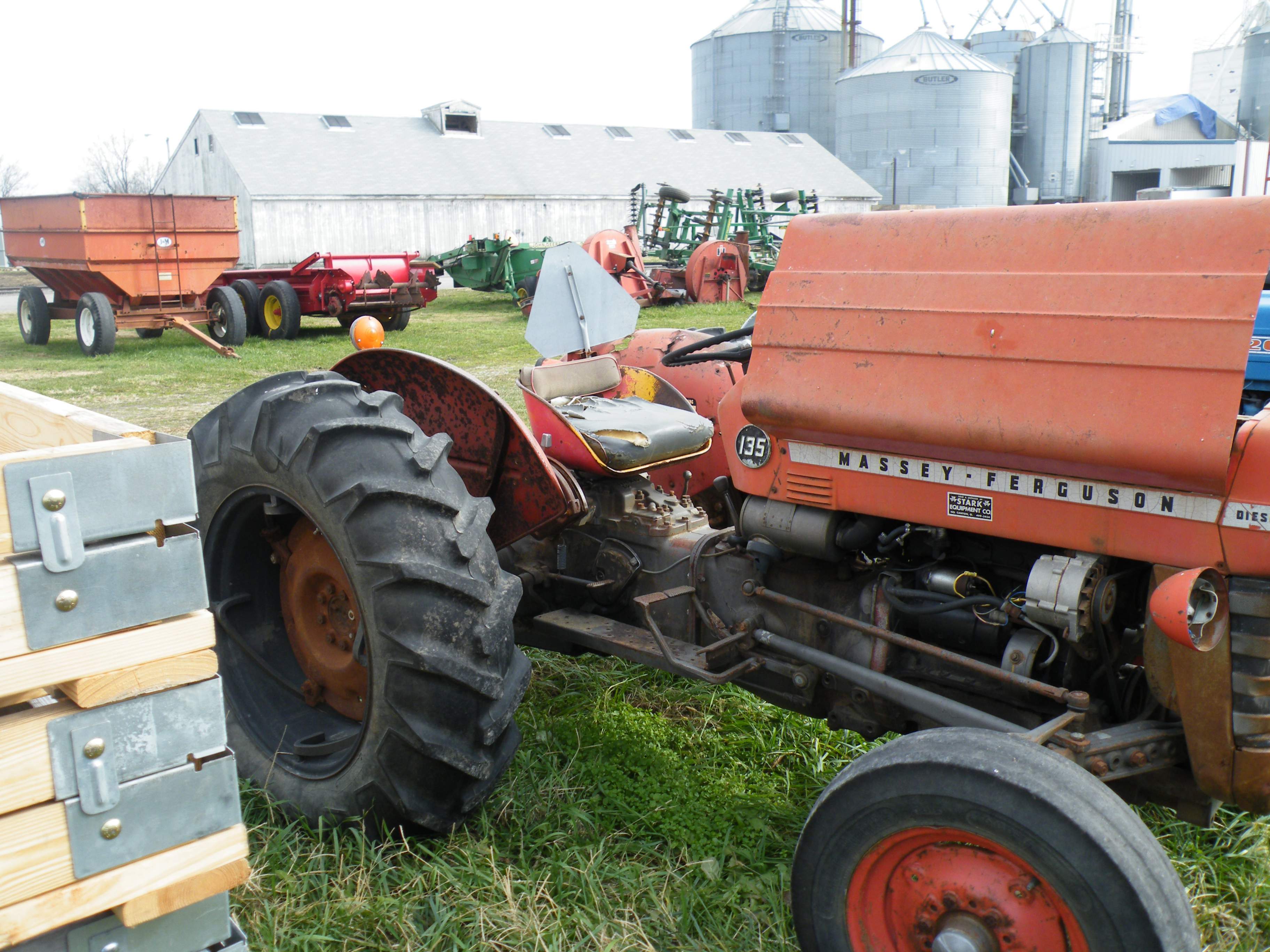

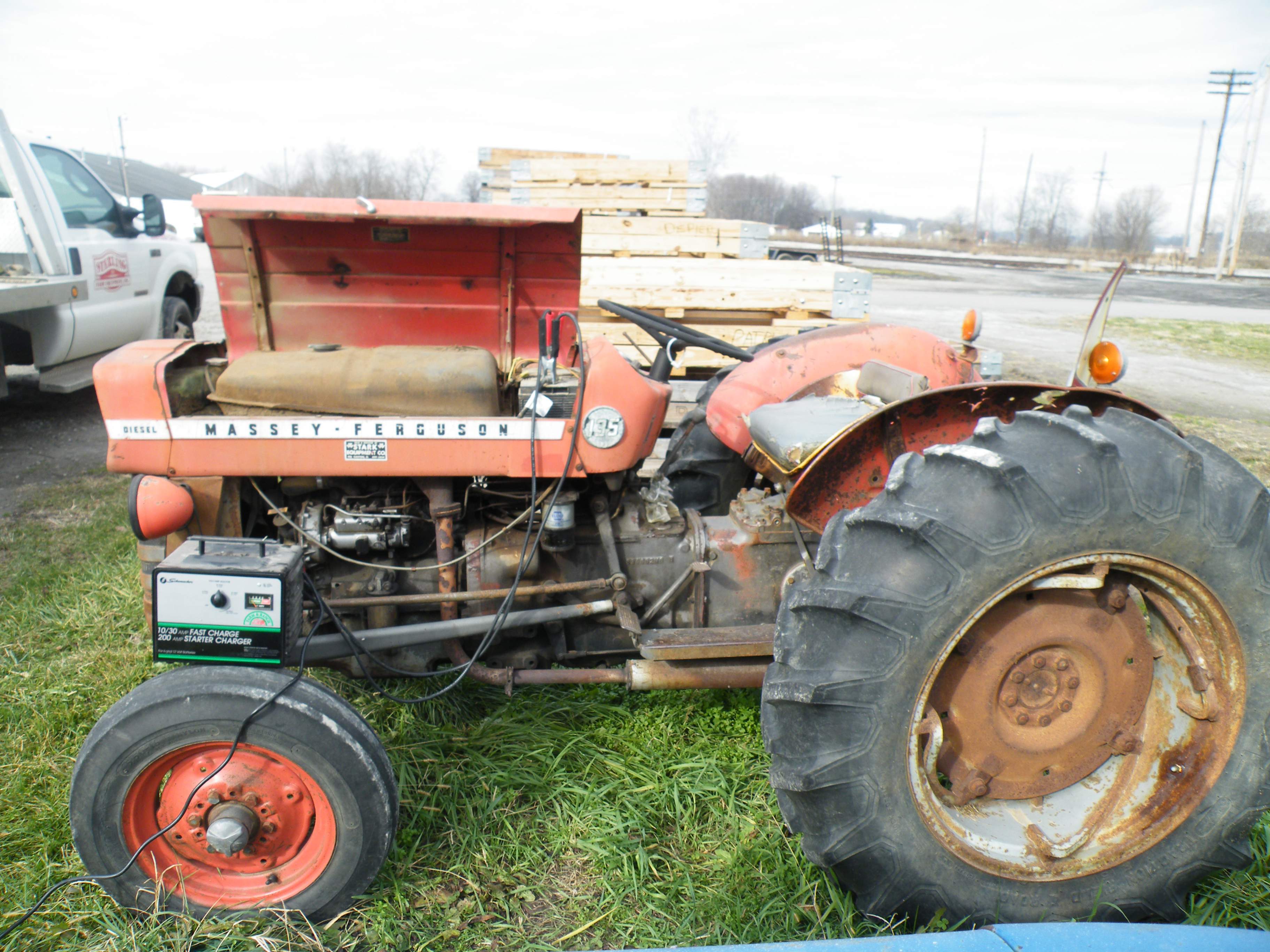

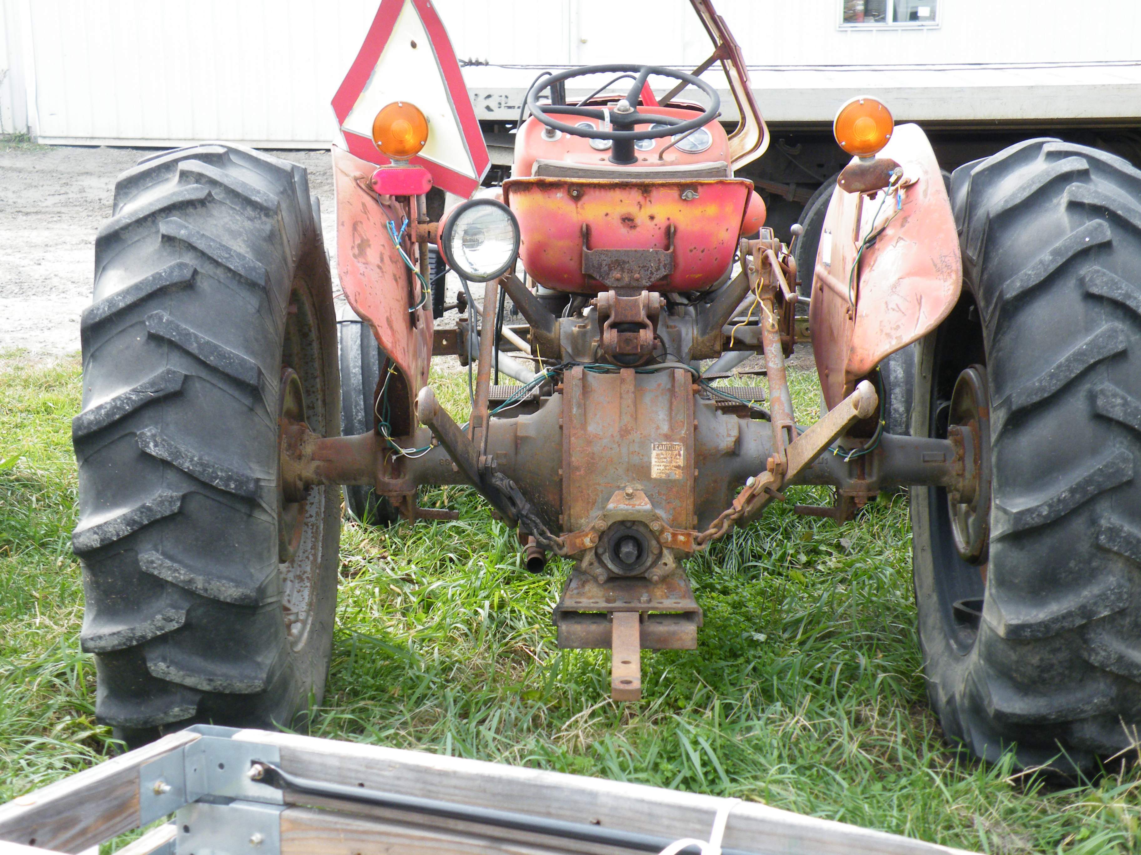

Well, I done did it and bought me a 1967 MF 135. Its a diesel with power steering and 5000 hours on the clock. Gonna need some manuals to start with and all filters . Can someone give me a hand to find the right stuff? Mucho thanks for all and any help. Here's some photo's more to come tomorrow. Not sure if its charging the battery or not as they had to jump it.

I noticed you probably need a new PTO output seal. Anytime there is a large amount of greasy dirt at the PTO usually says the seal need replaced. It's a piece of cake. Now the bolts that hold the retainer on might be a b!tch. I use a torch on those hard to remove bolts, screws, and nuts. I beleive you have a diesel which I'm not that familiar with. Quite a few in here have them and can chime in if you run into trouble. You can read my thread on the PTO to give you an idea of what your faced with. Just remember there's eight gallon of oil behind the seal, so either park the tractor with the front end down a good grade or drain before pulling that seal. Also engage the PTO in tractor mode and engage both shifters to lock the inner gears so the PTO shaft can be pulled without guts falling out of place inside which would not be a good thing. I learned that here!

Your tractor doesn't look that in need of much maintenance/repair. Mine looked pretty used up close. I'd call mine before I started on it a "thirty footer" Looks great at thirty feet. :)
How bad it the boot at the rear of the lift cover. If you can move it in and out more than an 1/8" it's probably out of adjustment. Pulling a mower of cutter you won't need it's use only the point of attachment. This is where you attach the top link. Mine was in sad shape, rusted real bad and I replaced/rebuilt the entire assembly. That part enables the tractor to use it's draft control on implements needing it.
