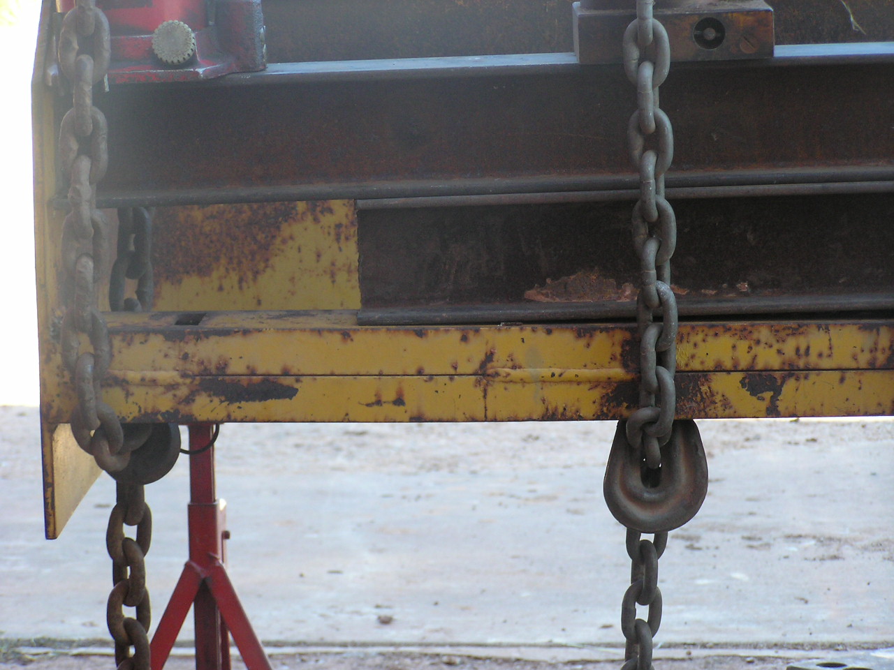

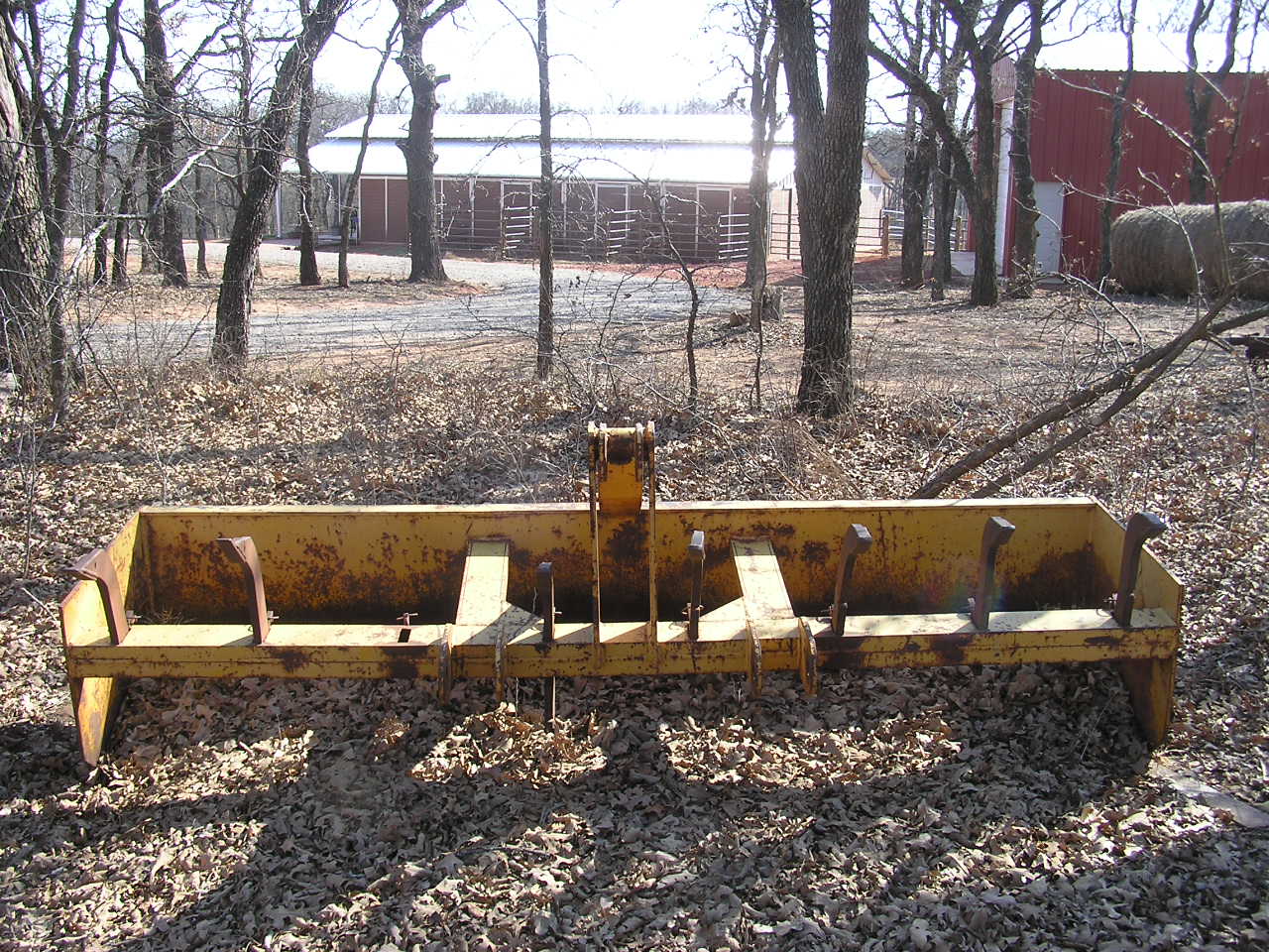

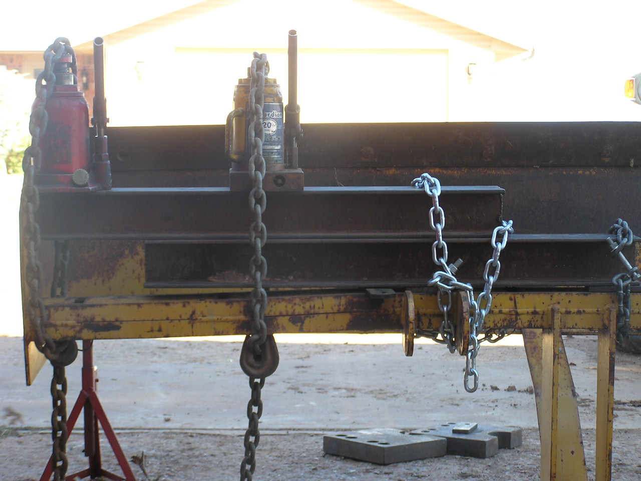

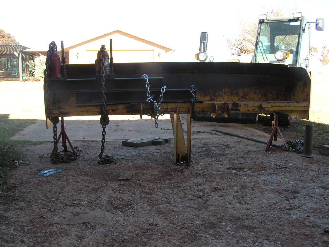

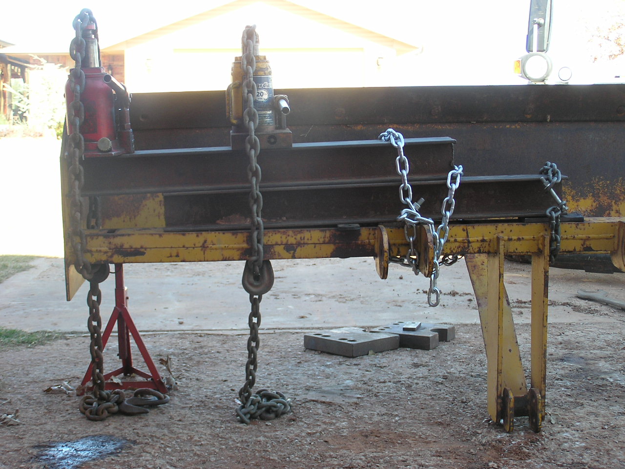

About six years ago I was looking for a lightweight box blade to level dirt that I was hauling in. Saw an eight footer on craigslist for $350, wondered what was wrong with it, besides missing one scarifer. Went to look at it and saw that it had snagged something immovable and bent the cross frame. Bought it, brought it home and straightened it. :thumbsup:

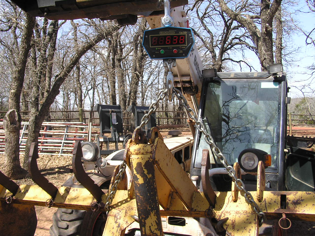

It only weighs 638 pounds.
