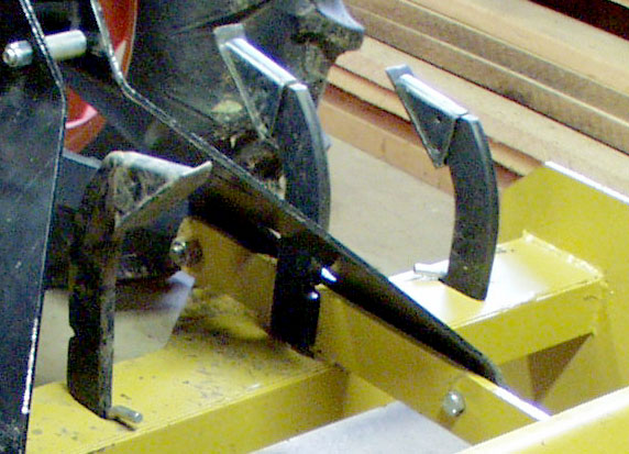

I am certainly one who complained bitterly about how difficult it was to insert/remove the ripper pins. It was so difficult, in fact, that I rarely used the rippers unless I had a really good reason to do so. Ironically, it turns out that through usage, the ripper slots have loosened up to where the pins drop in and out quite easily now. /w3tcompact/icons/crazy.gif
Of the 5 scarifiers on my Howse box blade there is still one that gives me trouble. This, however, I regard as a manufacturing defect, in that the ripper slot is positioned so close to one of the frame brackets that the shank binds against that piece of steel, frequently requiring a small sledge hammer to work it free. I could probably improve that situation with a file or grinder and a bit of elbow grease.
The attached picture is the best I could come up with to show the problem ripper and the L-shaped round pins. The rippers are obviously in the "not in use" position, but each shank has enough notches to allow two digging depths and can be mounted to face the rear if I ever think of a reason to do so.

Harv, again being at the ridiculous disadvantage of not being able to see a real boxblade, I didnt expect the pin mechanism to look like that. As I interpret the picture, you drop the ripper until the notch lines up with the edge, and then you jam the pin in the other side. I can see how that could jam. I guess I pictured a pin going through the scarifier and into the box housing somehow.
