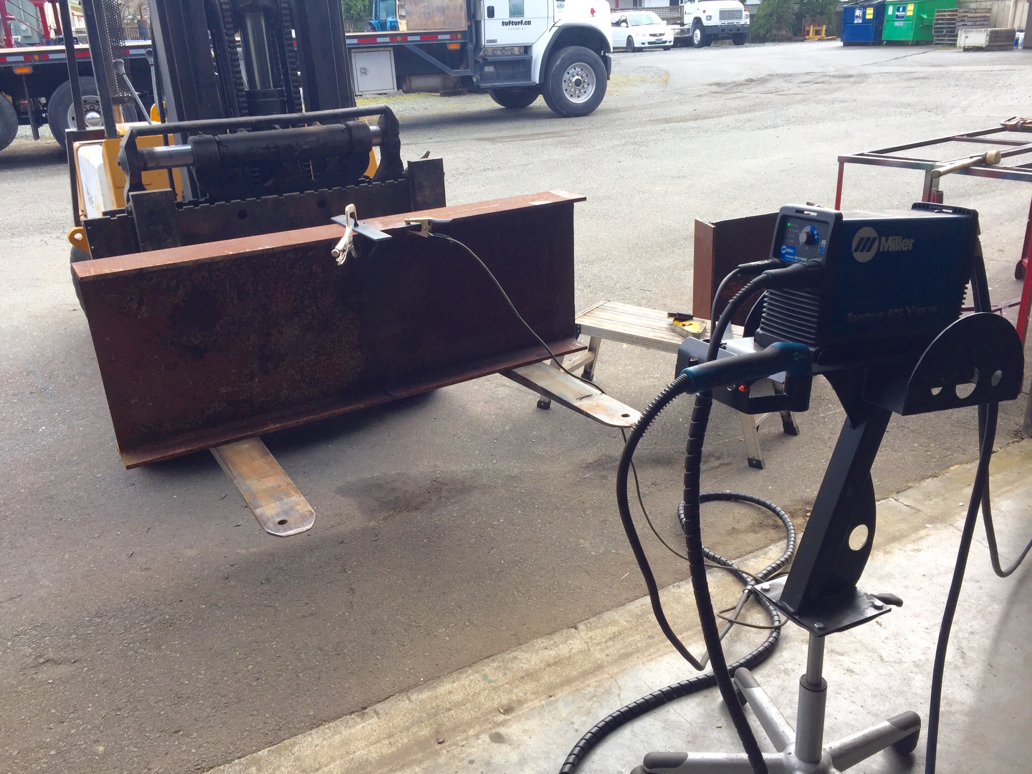

Find someone with a plasma cutter or cutting torch. Bandsaw would be way too slow for me.
Depending on web thickness, 8” I beam should only take a minute or two for each cut.
Here’s a pic of plasma cutting 24” I beam for my welding table legs. Probably took me about 5 minutes per cut.
