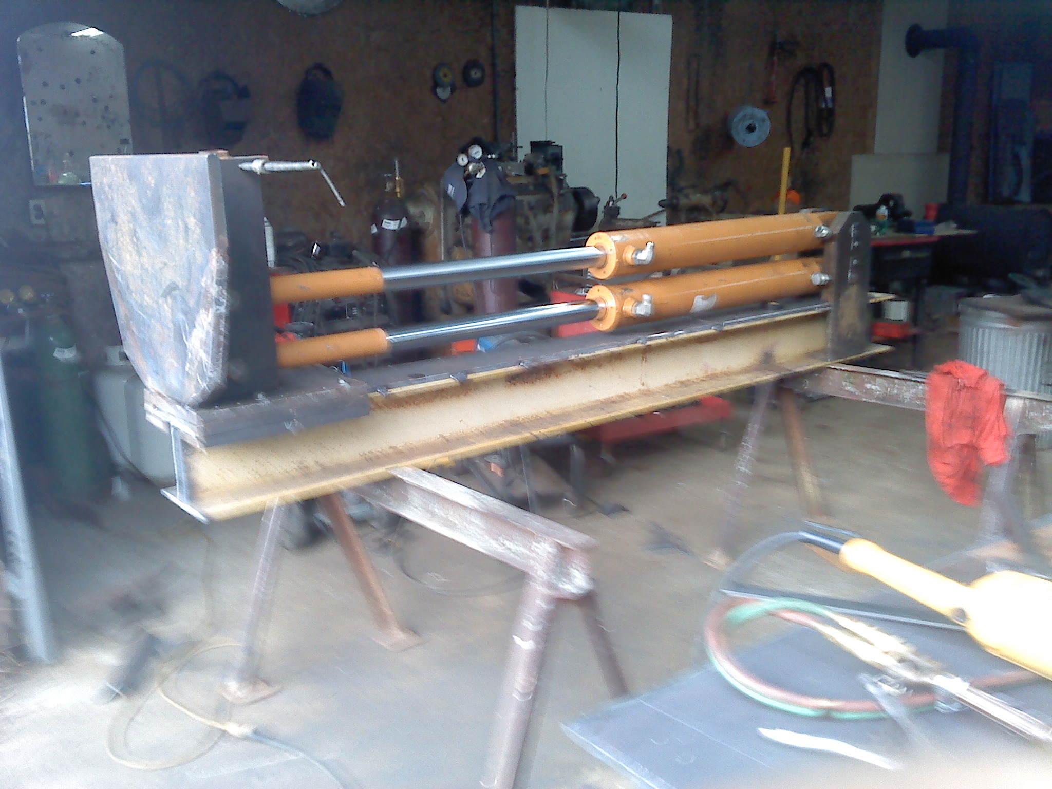

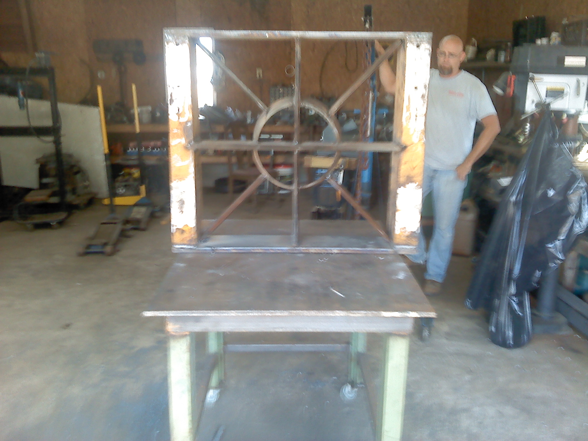

As for my projects, I have been disabled for a little over a year and I havent done hardly anything in my shop except for the occasional 5 min weld job for family and friends. I tore my rotator cuff sept of last year and had my knee replaced in june of this year, and a MUA in Oct, so my shop time has been limited. I did manage to get the 12way box wedge welded up for my wood processor, but havent mounted on the beam. Lets see if I have a pic of beam and wedge to satisfy your project hunger. Not much to show for a year in the shop, but nothing there I care to use a 120v mig on

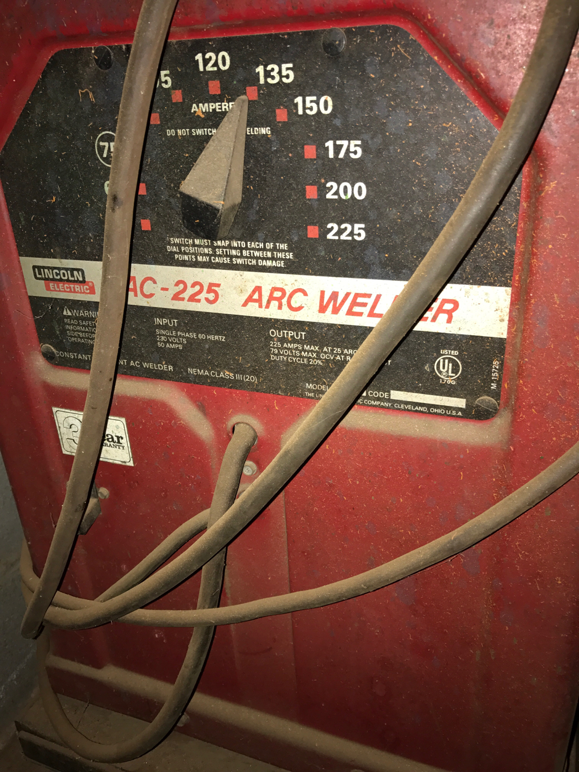

I own 3 welders. The little buzz box I call it (the Lincoln) I struck my first arc with one at 10 years old. It's all my dad had and he still has it to this day. I bought this one for $100. I went to work in a machine shop at 20 years old and been there for 21+years. I rarely use the Lincoln anymore. I used to do a lot of welding after work for farmers and friends. Getting married and having 2 kids changed my priorities. I try not to weld much after work now and spend time with them. IMG_1861.JPG

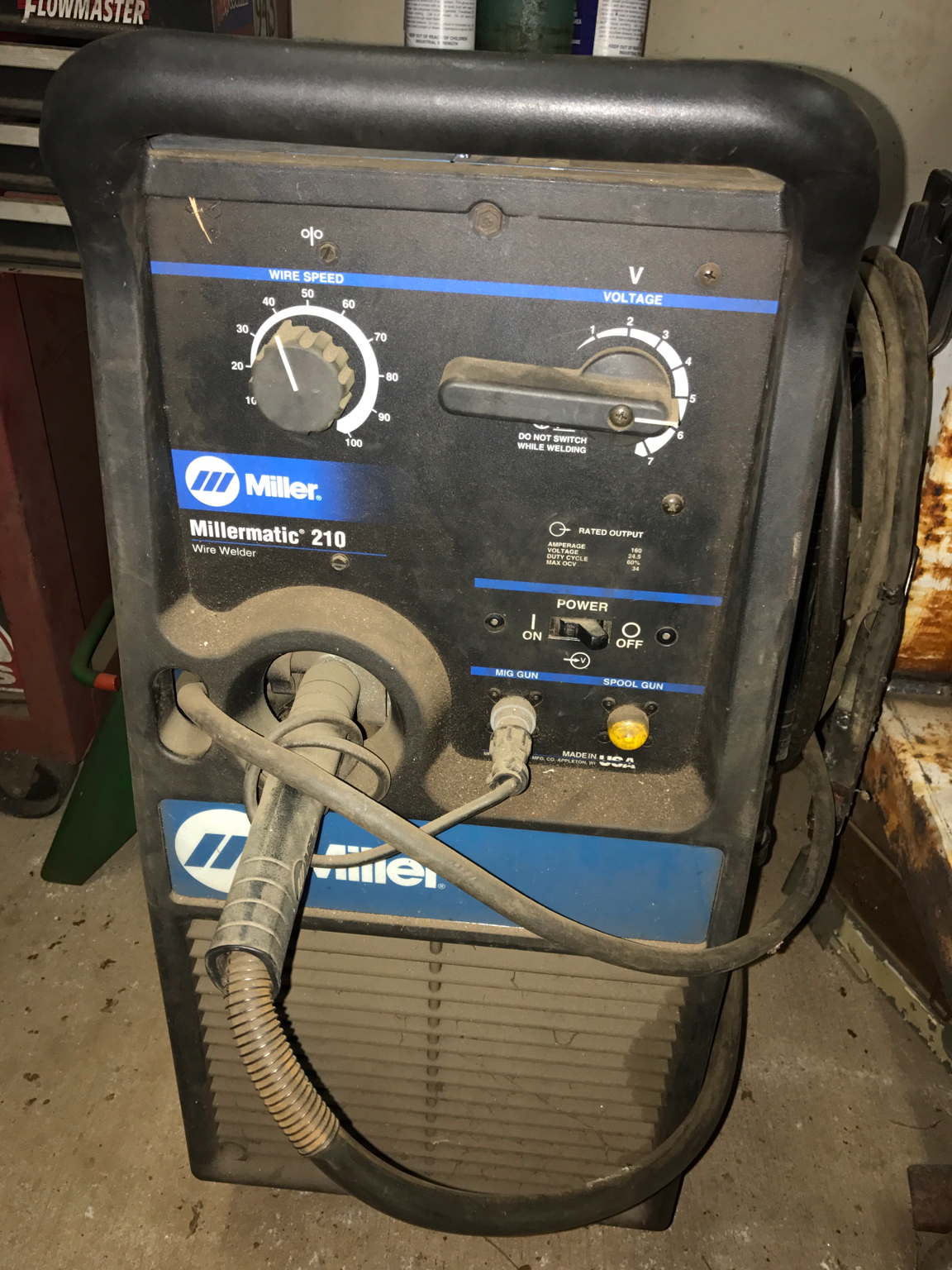

I had never used a mig until being in the machine shop. After using it I had to have one. Bought one and it wasn't big enough so I bought this millermatic 210. It does everything I need it to do. IMG_1862.JPG

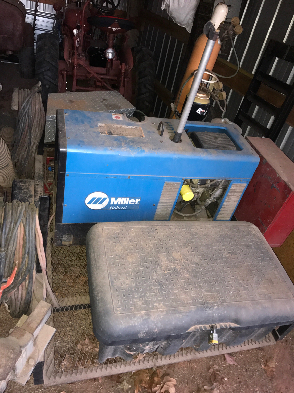

When I was welding a lot after work I decided to go mobile and had a service truck with everything on it and made really good money doing it. Realized the more I made the more I wanted and it only made me happy if I spent it. Sold the service truck but kept most of my tools off it. I use this miller bobcat to run our house if the power goes out. Rarely use it welding unless I need big, deep welds. It will get er done. IMG_1865.JPG
I mounted it and a couple took boxes on a trailer I traded my brother out of. IMG_1866.JPG

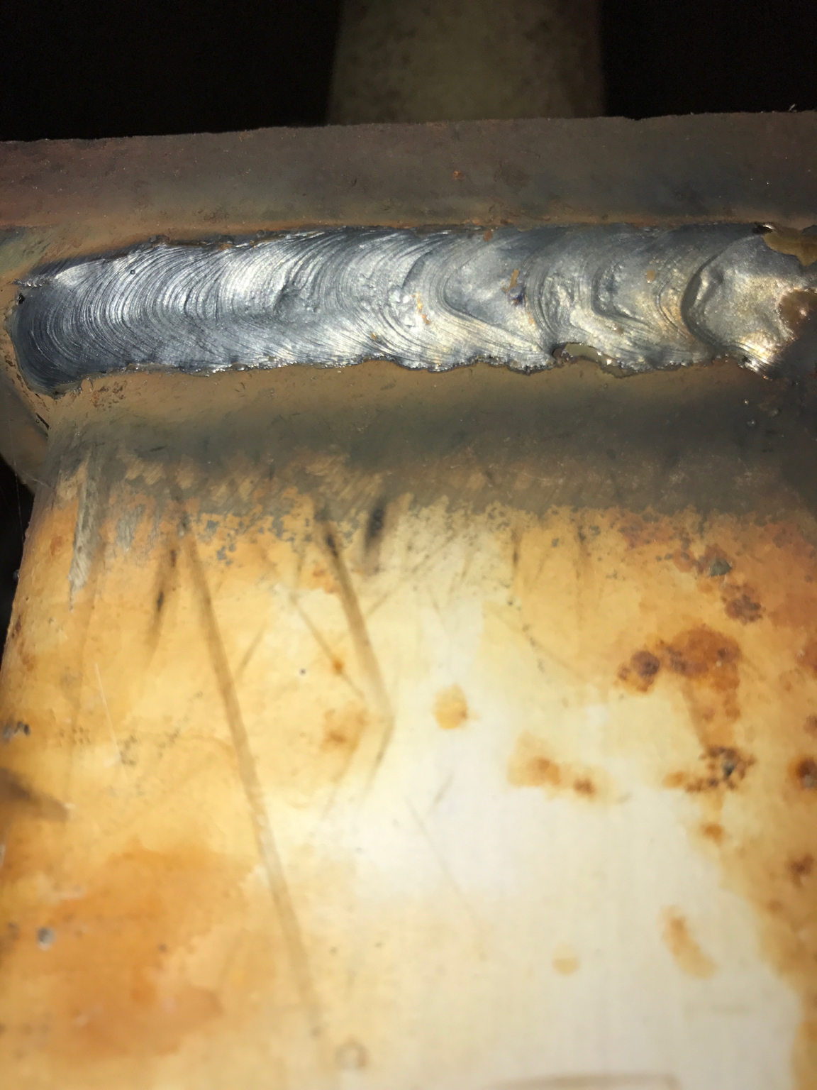

I built a gantry out of scrap I cut out of a pool at church this summer. Ground the rust off and used the mig. IMG_1863.JPG
If I was wanting a welder at home to start out with I would get a buzz box and some 6013's and 7018's. The 6013's will go thru rust and paint and still give you a good weld. That's what I started with at 10 years old. If I wanted to weld lots of things at home I would have a buzz box and a 220V mig. The rust and paint will have to be gone for a mig. The 220V mig can be turned down to weld thin stuff. A 110V mig can't be turned up to weld thick stuff.
