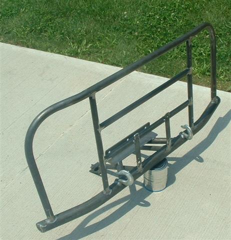

   / Brush Guard Project
#2
Here is a picture after some welding and grinding. By the way if you just welded around the perimeter of a large project do not lean against it to weld the middle. (don't ask me how I know) /forums/images/graemlins/frown.gif

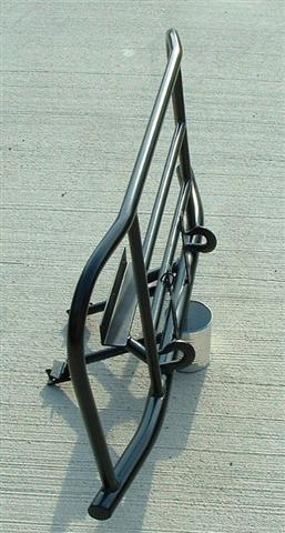

Next the primer and paint. /forums/images/graemlins/smile.gif In this photo you can see some of the compound bend to match the contour of the front end.

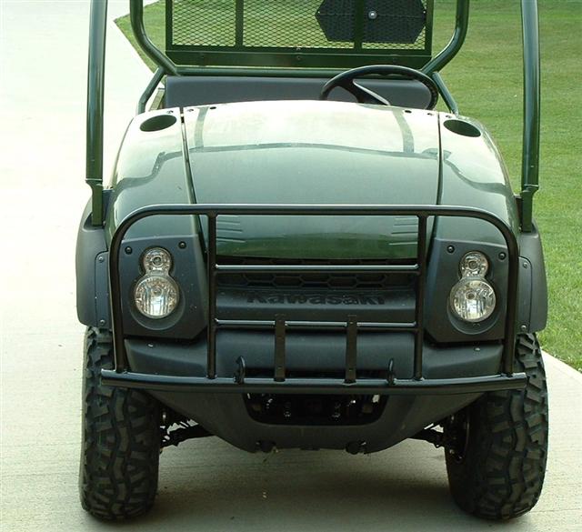

Front view painted and installed.

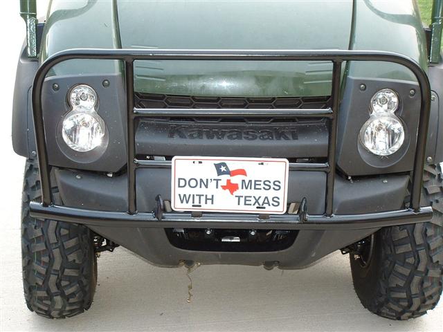

#9
Here is the finishing touch for our friends in the Lone Star State. /forums/images/graemlins/grin.gif
