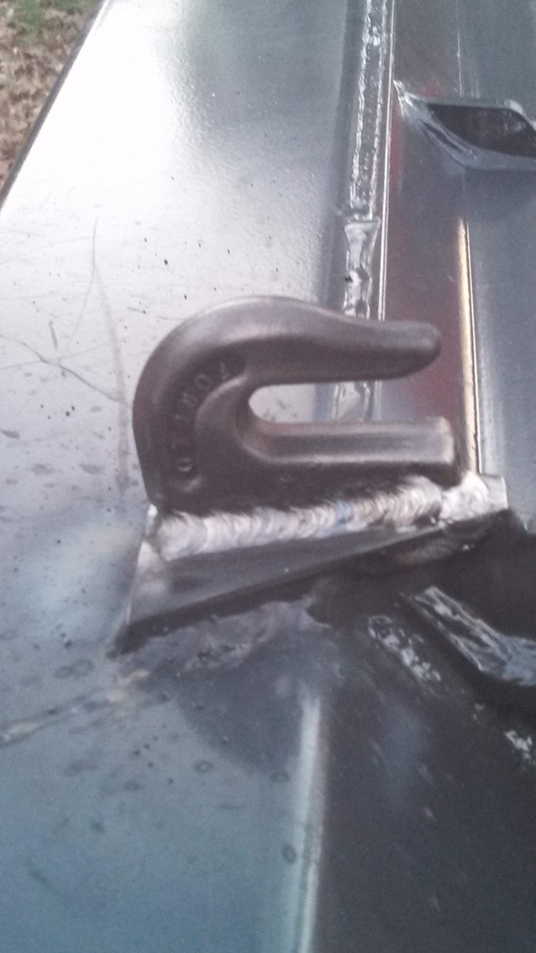

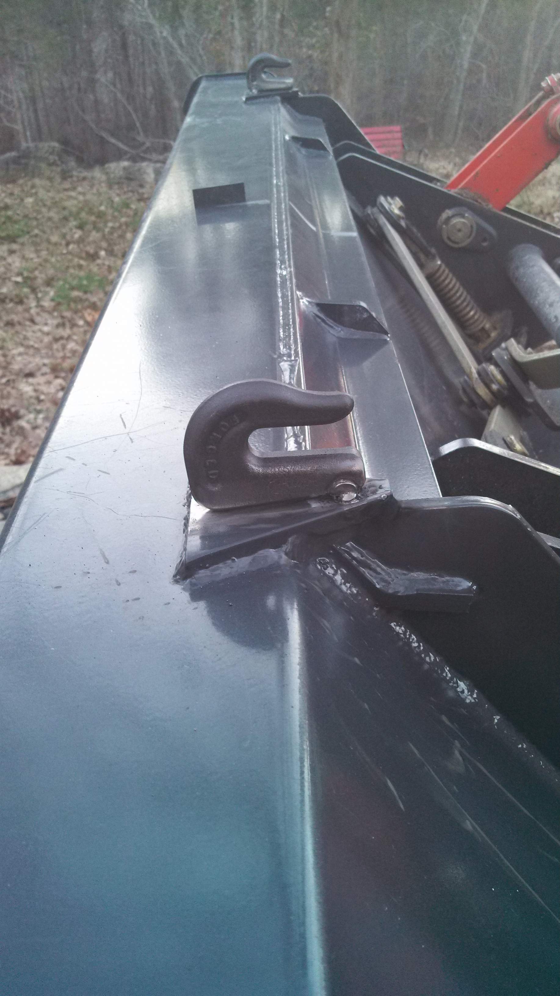

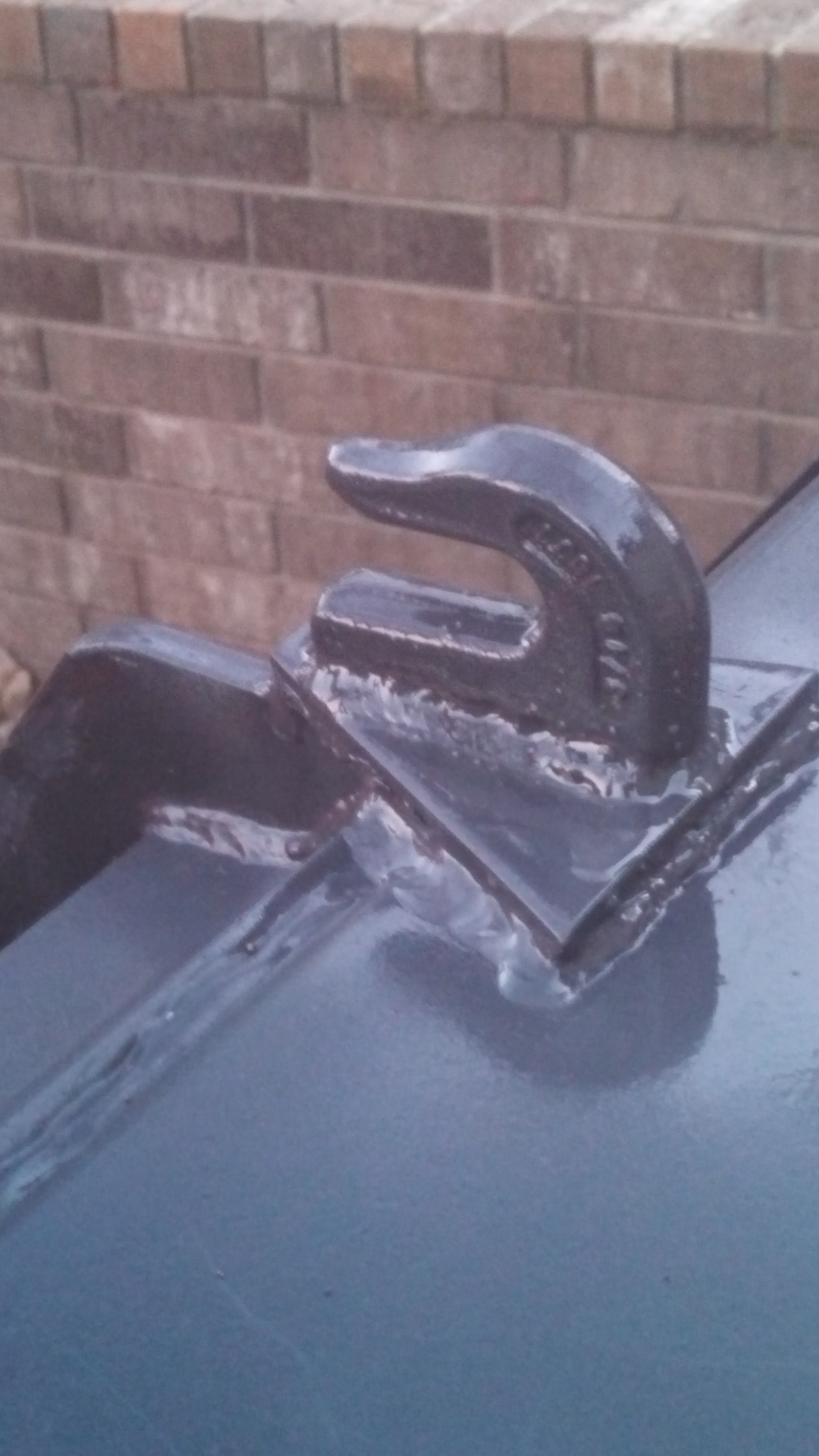

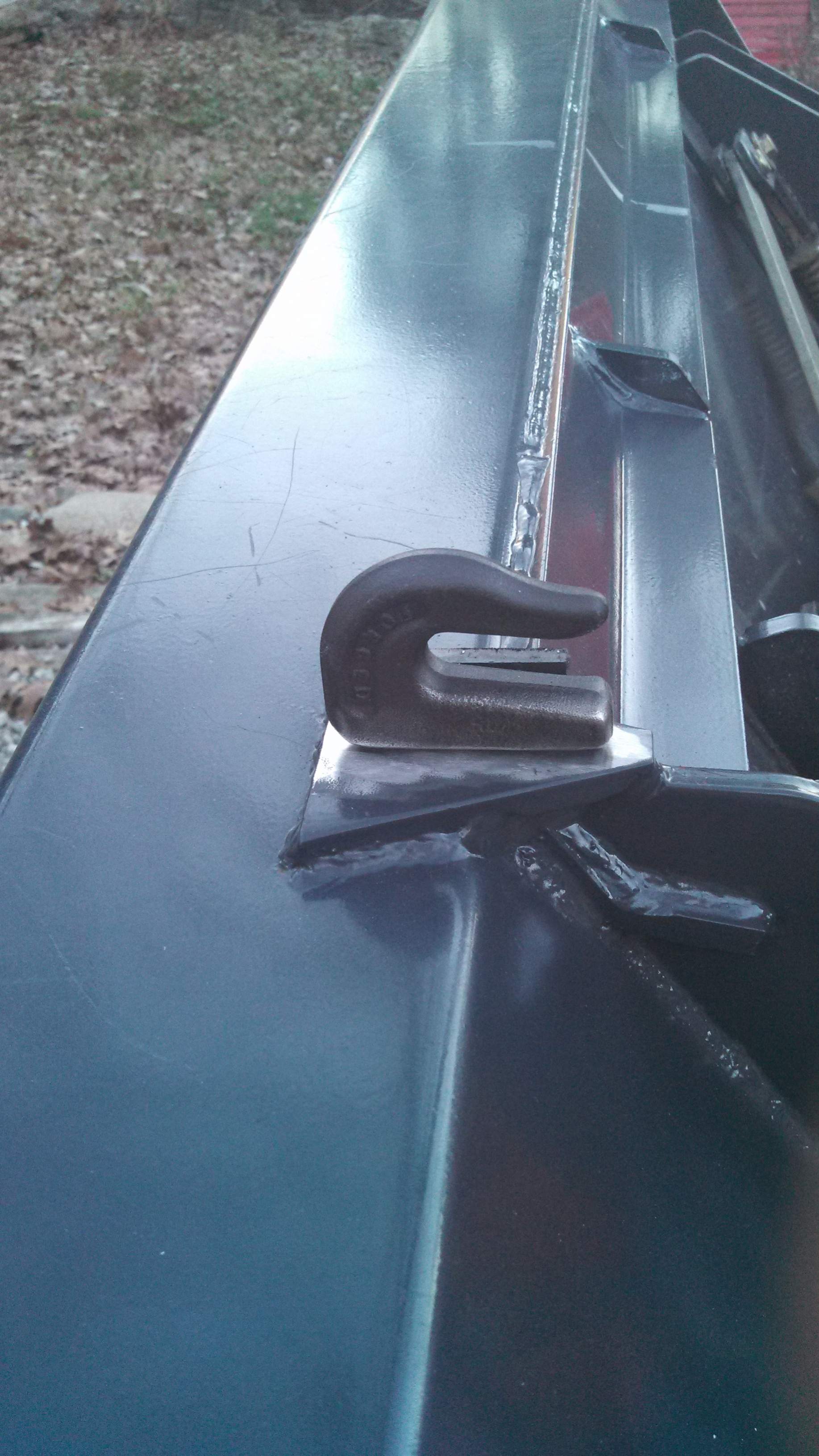

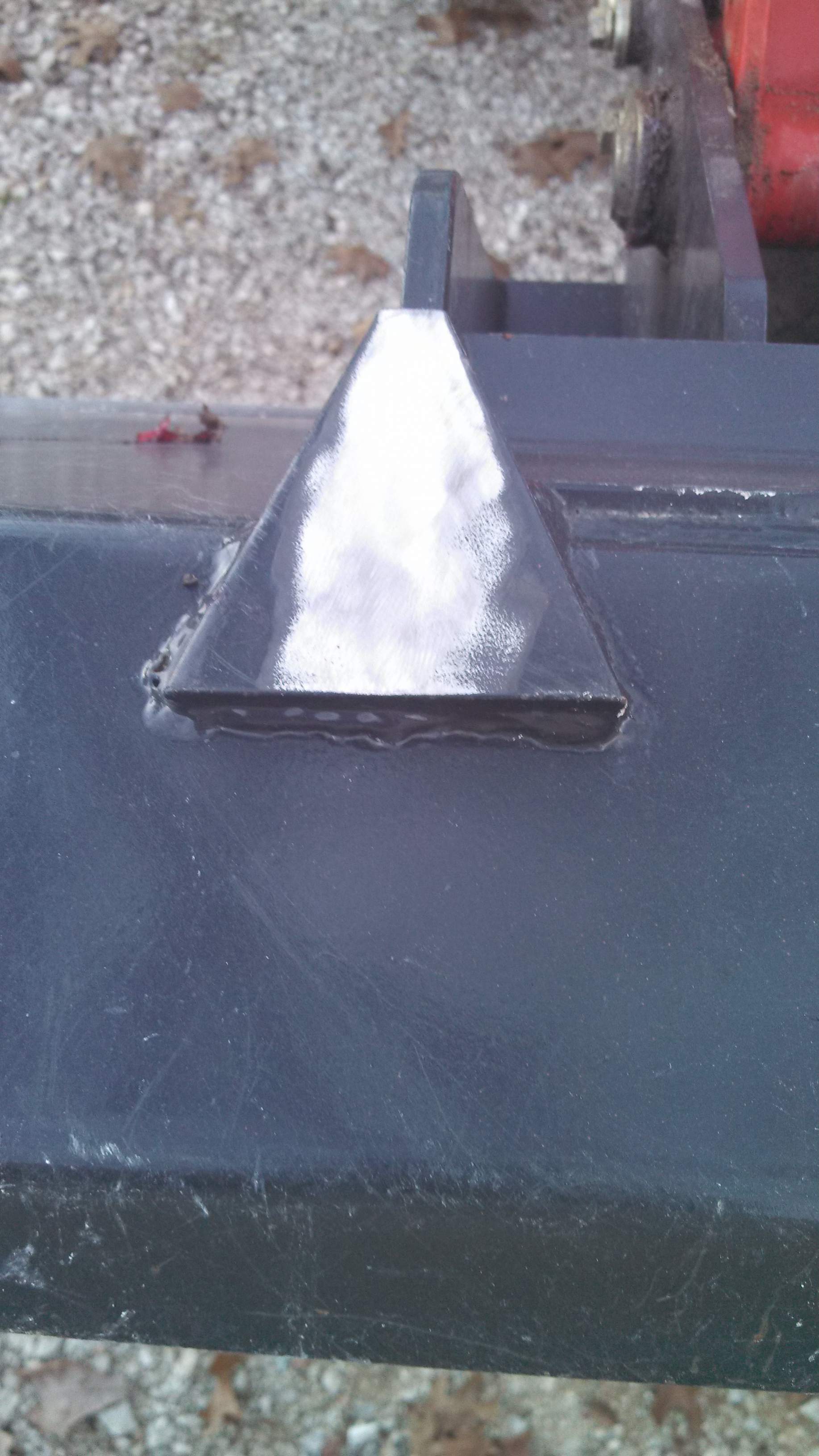

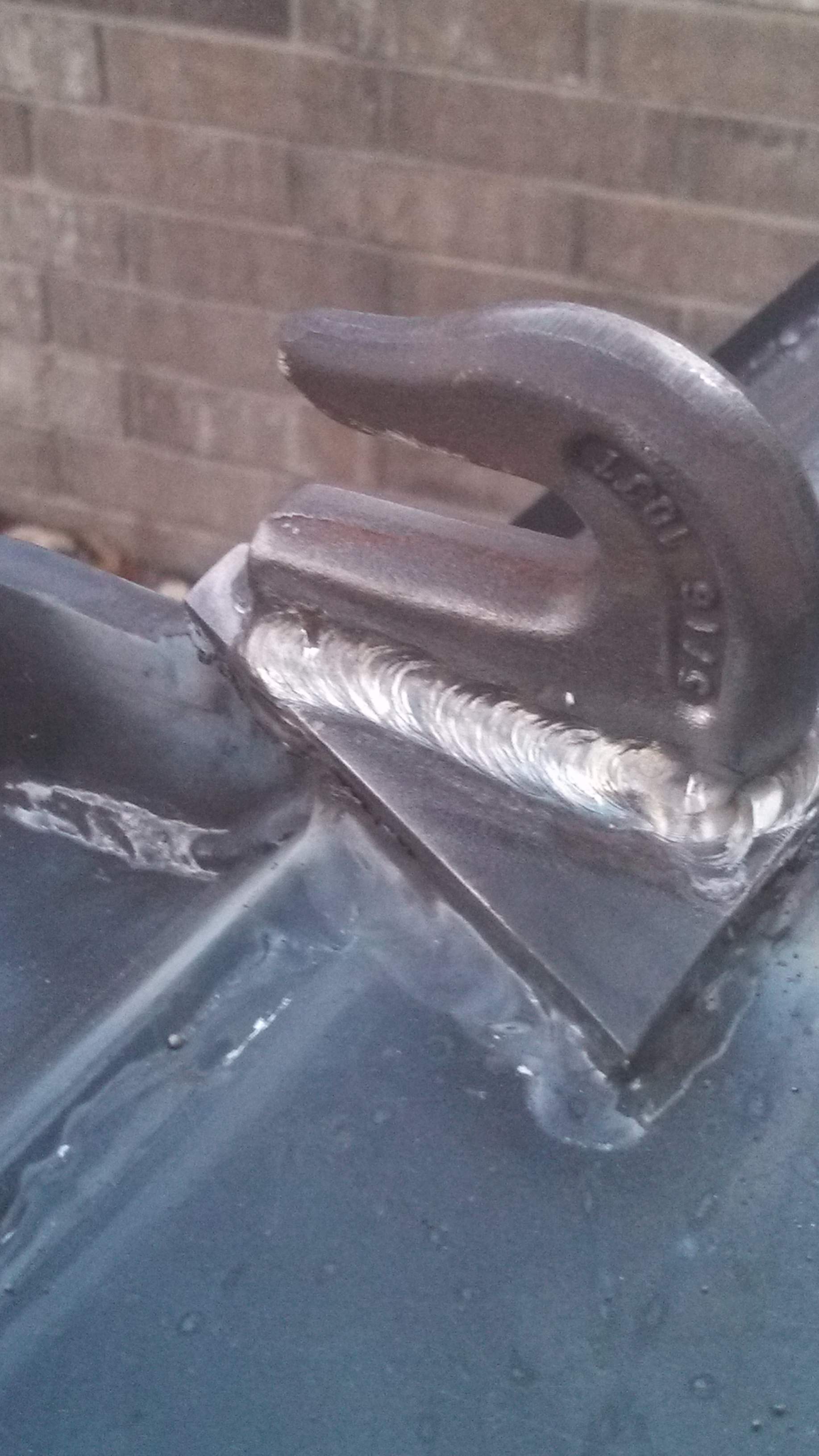

I think your plan is sound. Here are my hooks welded to the existing factory welded pad. I suppose the pads were for that purpose.
IMG_20121117_170314_242.jpgIMG_20121117_165314_192.jpgIMG_20121117_165303_772.jpgIMG_20121117_164305_653.jpgIMG_20121117_162438_547.jpgIMG_20121117_162424_854.jpg
I didn't think the original factory MIG welds were anything to write home about, but if I do say so, I think my welds with some 7018 turned out pretty good.:)
Your welds look great, you are right about the factory welds. I am going to cheat - will probably let my son weld them on for me if he can come out tomorrow morning, he is a welder by trade.
View attachment 445721View attachment 445722View attachment 445723View attachment 445724View attachment 445725View attachment 445726
Actually yours are quite beautiful! I just don't get 'em that pretty with my MIG. :thumbsup:

I did it the same way Koua did with plates but my root pass was of 6013 good and hot. Chipped it and brushed it then went over it with 7018 a few passes. I've picked the back end up more than once with these,,, i use the middle one most so the loader dont get racked.

Looks like you mighta done a few passes before - good job
Thanks, guys. That is an example of some of my best stick welding. I don't show the worst examples of my stick welding:D

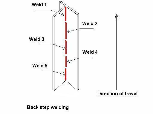

Is a skip weld the same as a stitch weld? Speaking of welding, should I skip weld the plates (the plates the hooks are welded too) to the bucket? Or continuous weld?

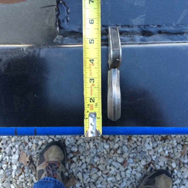

This shows how I attached them to my bucket...
It worked out quite well. I much preferred this method vs burning up my factory paint on my bucket.

Skip welds really help control distortion. Especially if you back step the welds too. Back stepping, and skipping around a lot breaks up the heat line, so a lot less chance of distortion. A lot of things I skip weld, I will use caulking between the welds before painting.
