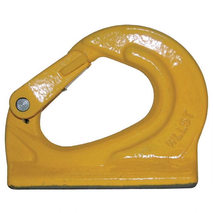

I kind of like the idea of a slip hook, what size you fellas recommend? Also, do they make 'em for weld on?
Size don't matter much with a slip hook, does it? You can buy a weld-on hook, or you can buy one with a clevis mount and cut the clevis off, or just leave the clevis on and weld the hook by its spine.
I, like Tom Seller, couldn't find a weld-on slip hook. So I modified a clevis type. I used a 1/2". Wouldn't hafta be that big.
I have searched HIGH and LOW myself, there is no such animal.

I have search HIGH and LOW myself, there is no such animal.
These are weld on anchor hooks that would allow a chain to slip. Weld-On Anchor Hooks | AW Direct Not inexpensive but would fit the bill. They also have the weld on grab hooks
Weld-On Grab Hook - Grade 70 - 5/16 | AW Direct
