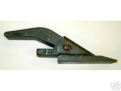

Did you get the teeth also?
   / Bucket Teeth, How Many ?
Oh yes Ive got the teeth. They are high quality.
The teeth mount with a 2 part pin that has rubber bonded between the two pieces of steel. I have not yet installed them onto the shanks. I wanted to weld then paint before pinning on the teeth.

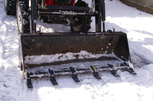

Here's a pic of my Koyker 160 with toothbar.

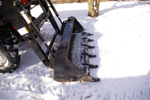

Haven't had the opportunity to dig dirt with it yet, just scraping ice and piling snow. Another pic.
