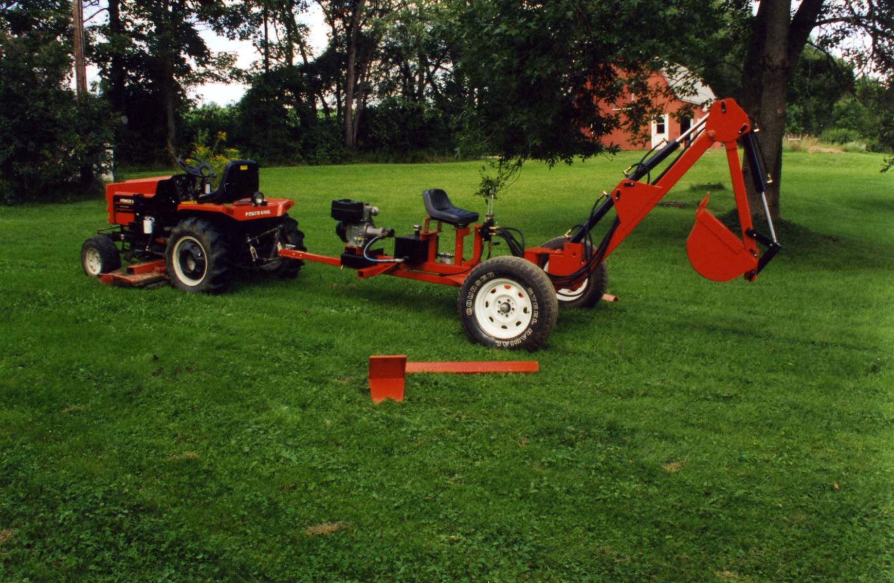

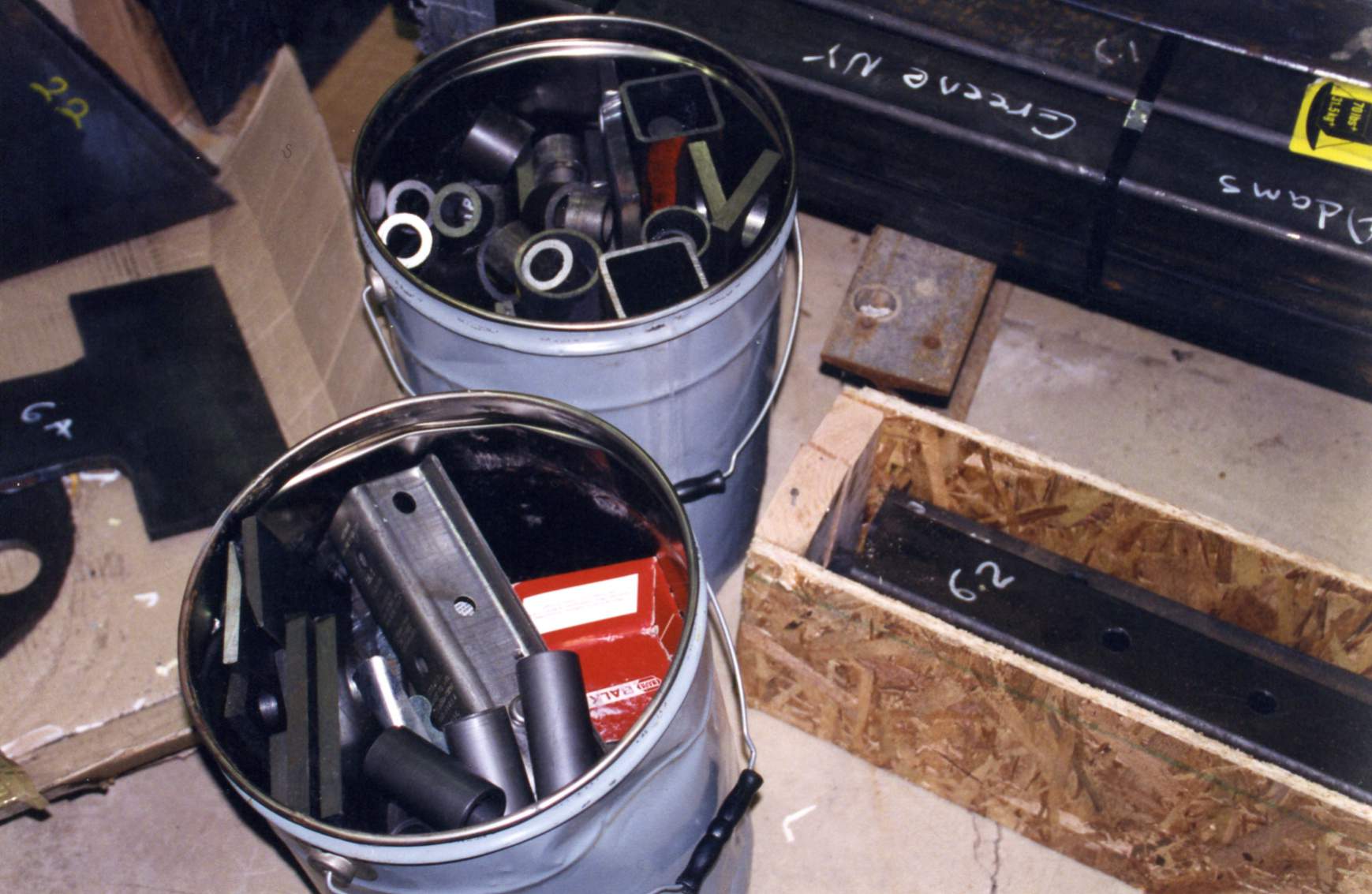

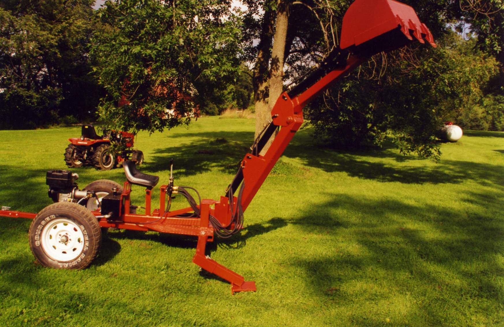

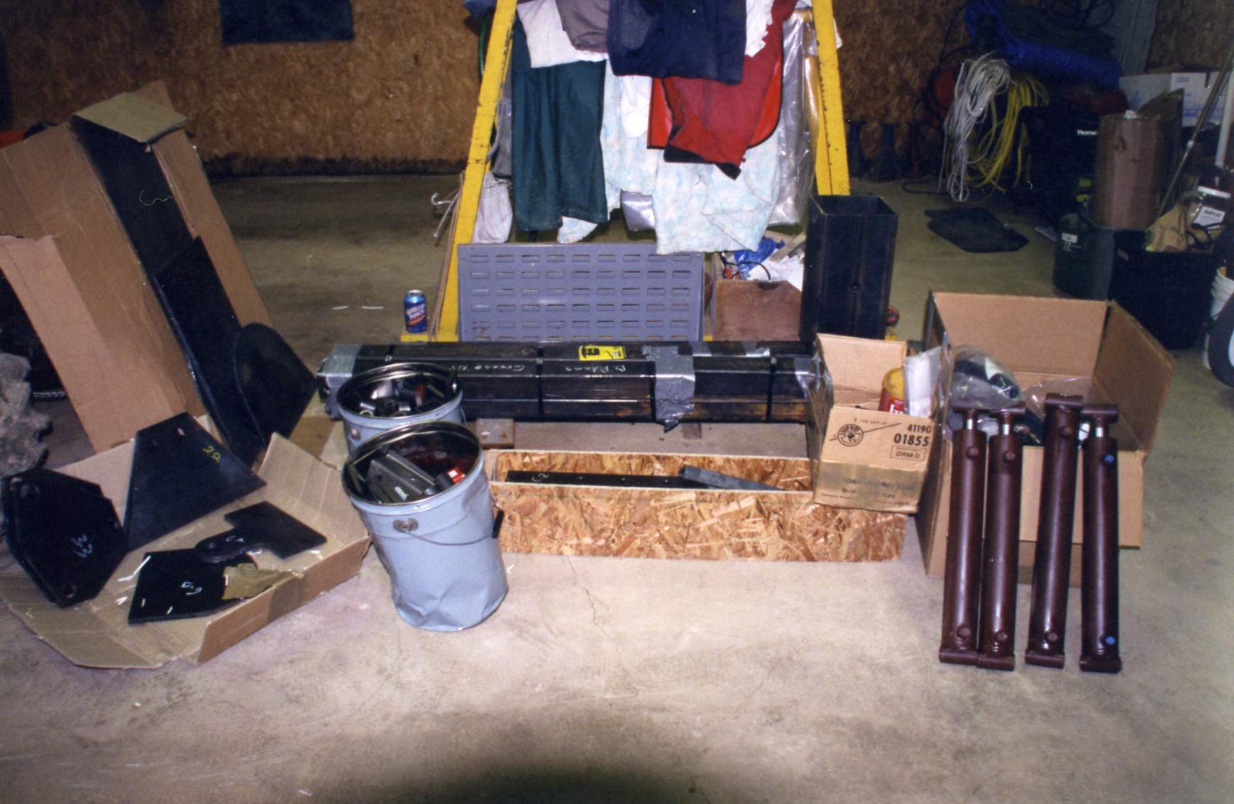

I built a model 728 (the original design) from the Metkits kit. (UPS driver loved me the day he delivered 700# of oily, rough cut, un-deburred steel and a couple 5 gallon pails full of small parts, plus a couple large boxes. Had to make me the first stop of the day because he couldn't get to anything else in the truck!) Basically just weld and bolt together, paint and go. Probably didn't save much money doing it that way, but saved a lot of time tracking down material, cutting and drilling etc. I was more interested in getting to the digging part than having a project.
A lot of how well these machines work depends on technique. They are light, so trying to drive the bucket down into the ground doesn't work well. You learn to dig by scraping along the surface and work your way down. For loose material that won't be a problem.

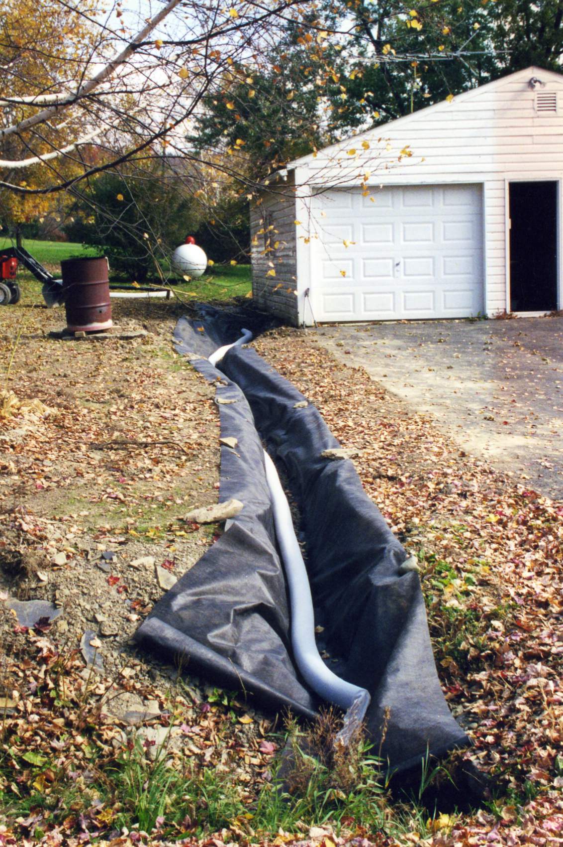

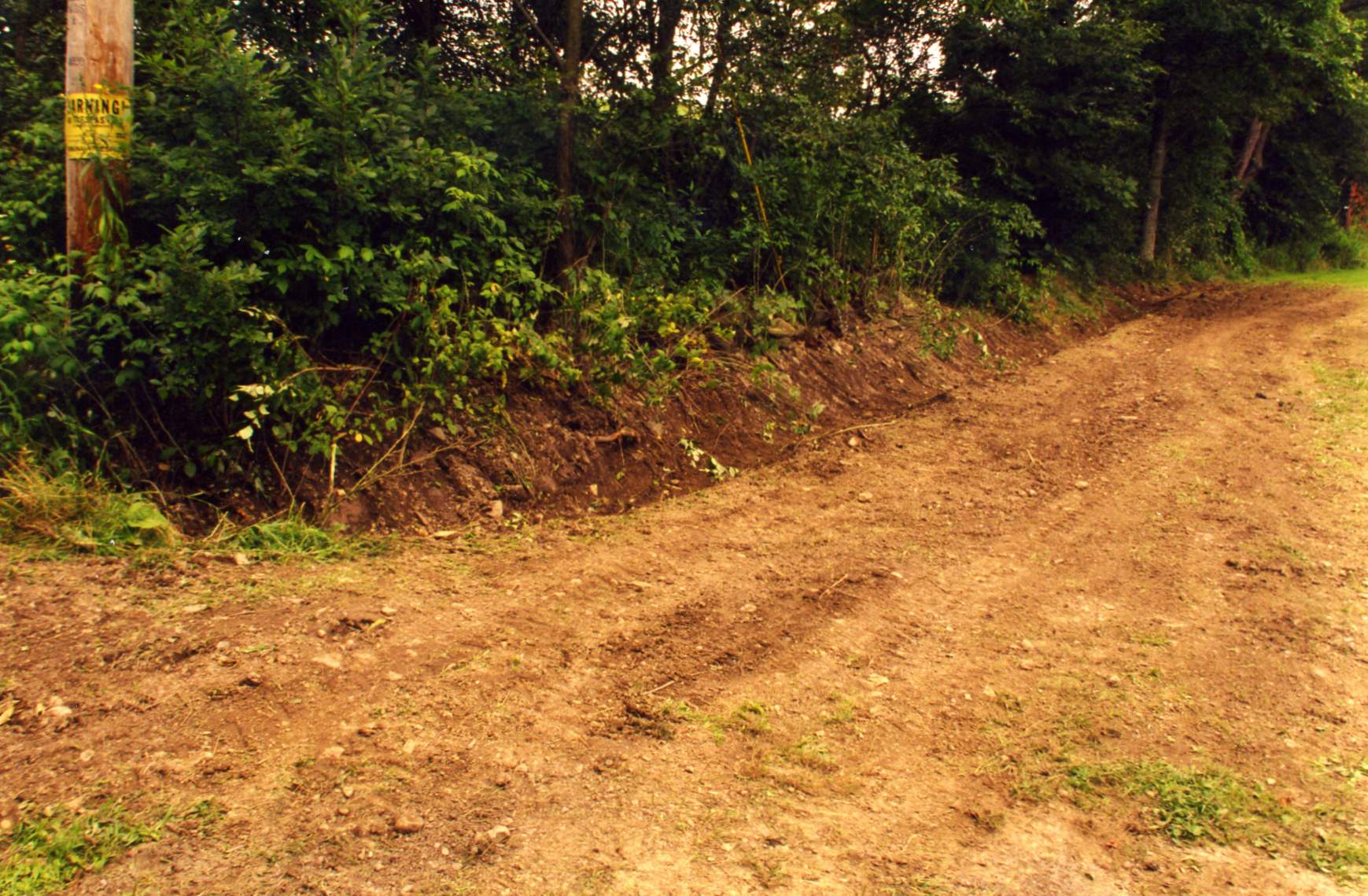

Do you have any photos of it (728) or photos of projects you have done with it?
   / Build it yourself towable backhoe opinions #8
I did have some pictures, from the time I got the kit through paint, and a couple of the first drainage ditch I re-dug/cleaned up. I'll have to see if I can find them, I moved across the country since then, not sure where they are at this point. I know they weren't digital, so if I find them I'll have to scan them to post. Give me a day or two.
