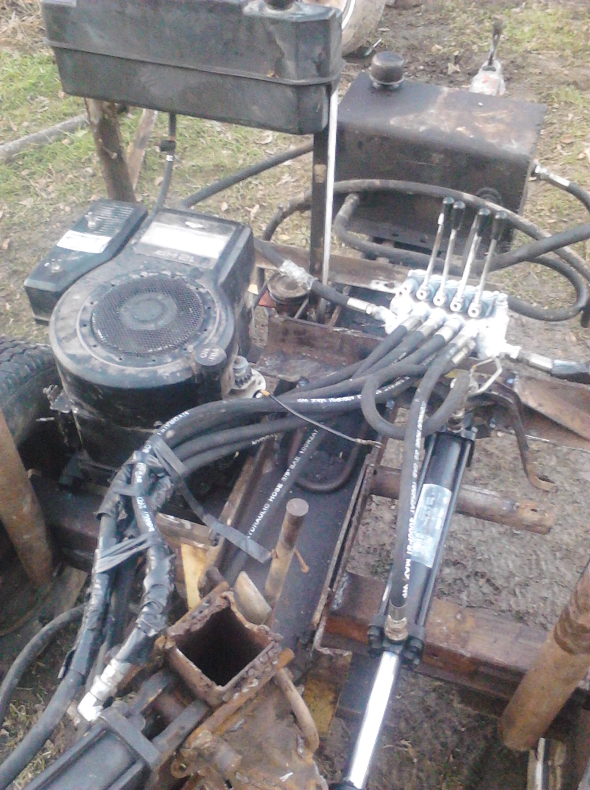

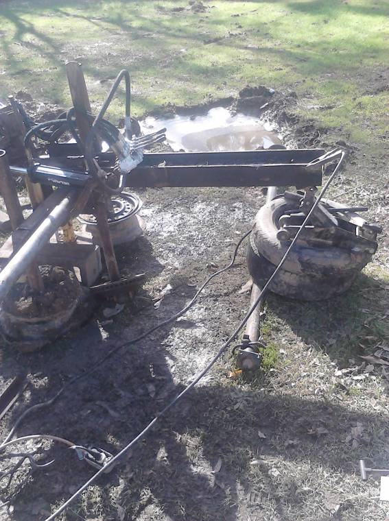

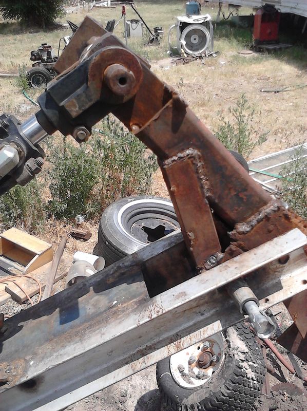

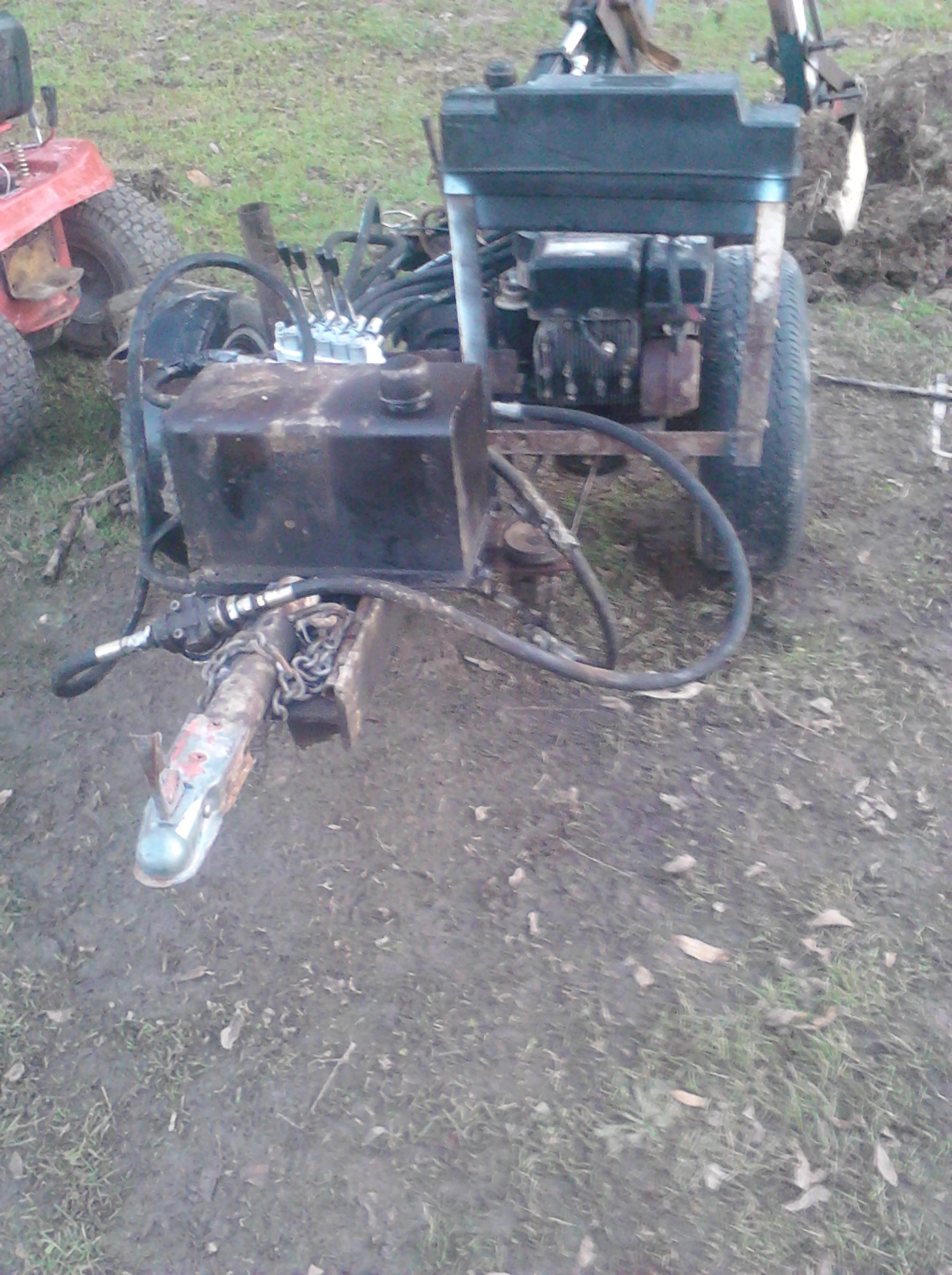

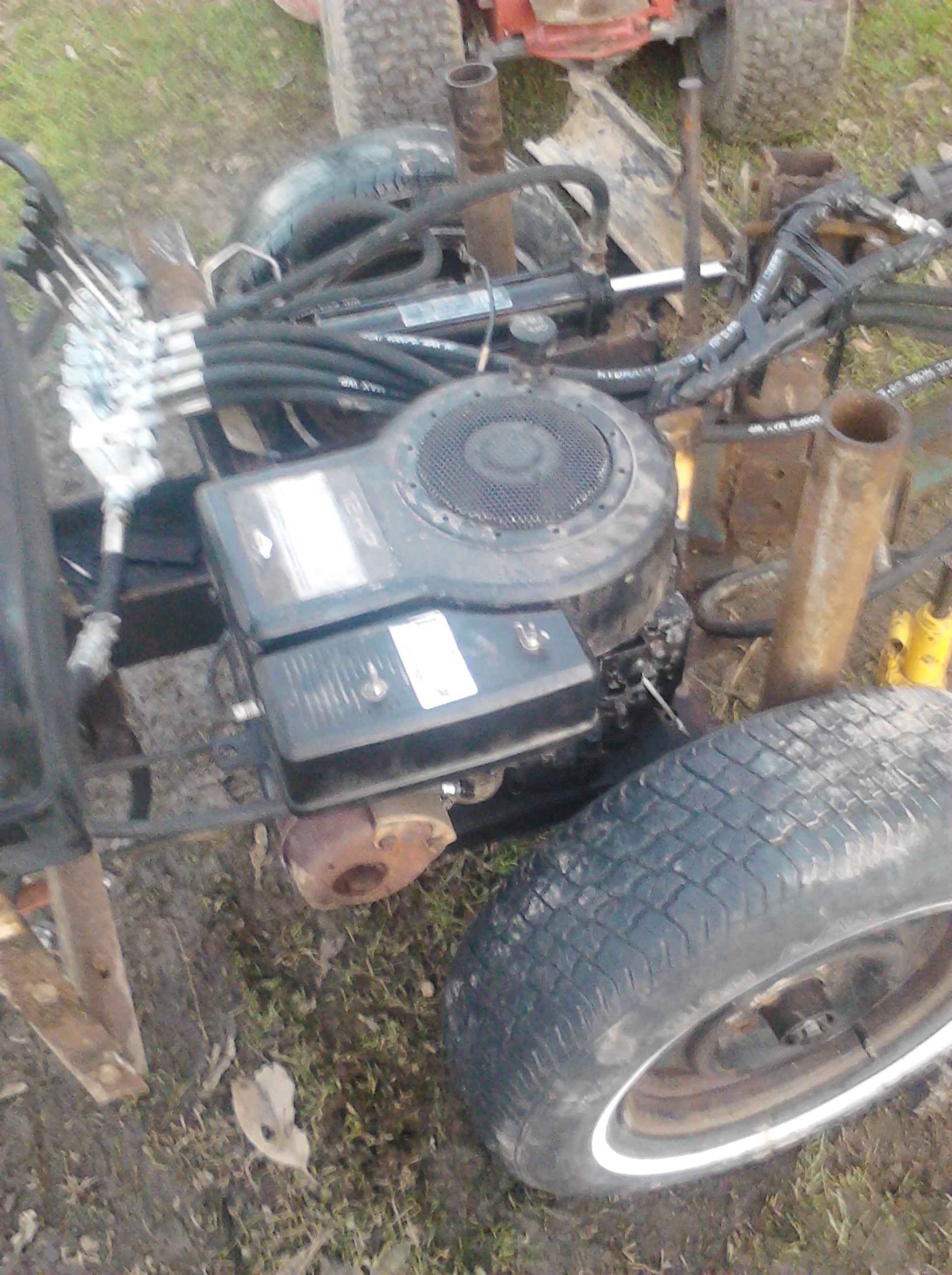

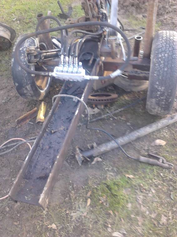

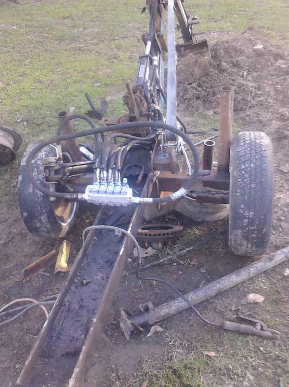

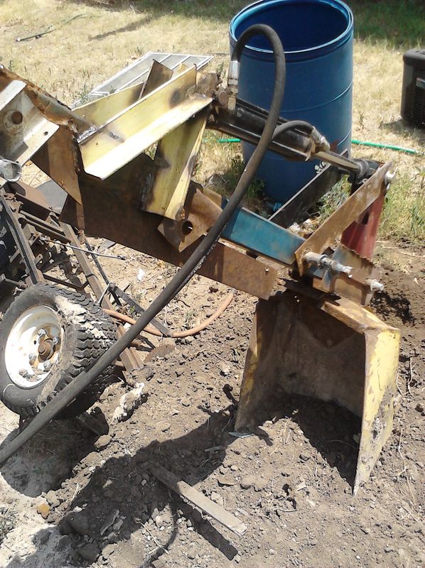

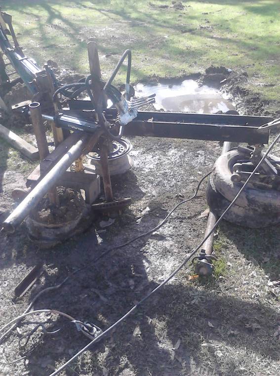

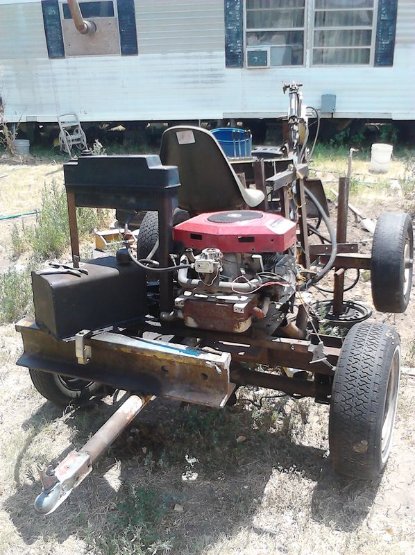

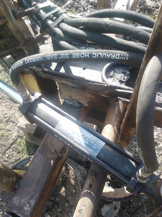

Here's some pics of it when it wasn't towable then where I modified it to make it towable.
Then I decided that a loader was needed more right now so I tore it down again so I could use the hydraulic parts for the loader. lol
I'm always changing my mind about things. :)
The first pics are of it after I modified it to make it towable.
I'm gonna repurpose the towable frame though as a log splitter.
The engine mount is there and all I have to do is add an I beam I have and then the hydraulics and I'll have a logsplitter.
Chad
