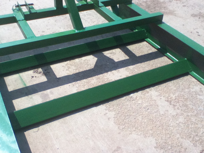

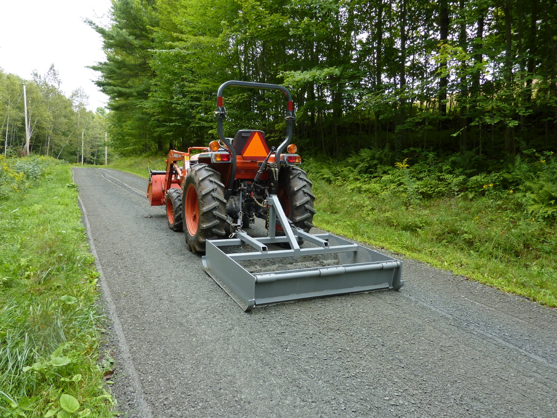

I hope you like it as much as I like mine. I'll post a picture for you. :cool:

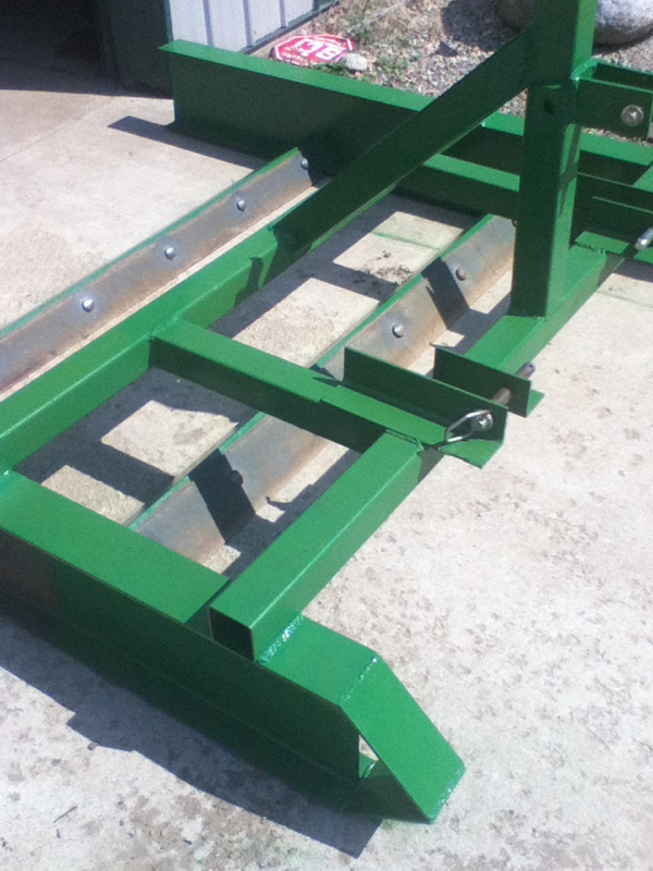

When setting the blade angle it would work best if the rear beveled edge is parallel with the ground. This will wear more slowly and keep the leading edge sharper. Picture how you would sharpen the blade with a file, that surface should be flat or parallel to the ground. If you stand the blade up at a steep angle you will wear the edge down prematurely. I know that the grader blades I have purchased were designed to be set at about 45 degrees.
If you bolt the blades down with plow bolts tightly the curve in the blade is a non issue. You can shim it beneath the blade if you want to. The easiest way to handle the drilling without a machine shop is to clamp the blade to the steel backing plate or angle and use the holes in the blade as your drill guides. I used a 5/8" bimetal hole saw with the 1/4" pilot bit removed and this worked great drilling through the 4x4x3/8" angle iron. The proper sized holesaw is a close enough fit not to wander when drilling the holes.
Here are pics of the two landplanes I have built and a picture where I was getting set up to drill the holes, a pair of c clamp vise grips works well to hold the material in place.

I hope you carried away from my post to use a holesaw to drill the holes, much faster than using a twist drill. Maybe a minute or two per hole.
