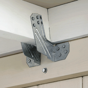

One added measure, I would add some hurricane ties to bond the skids to the joists. They make dozens of configurations, but something along the lines of the attached picture.
