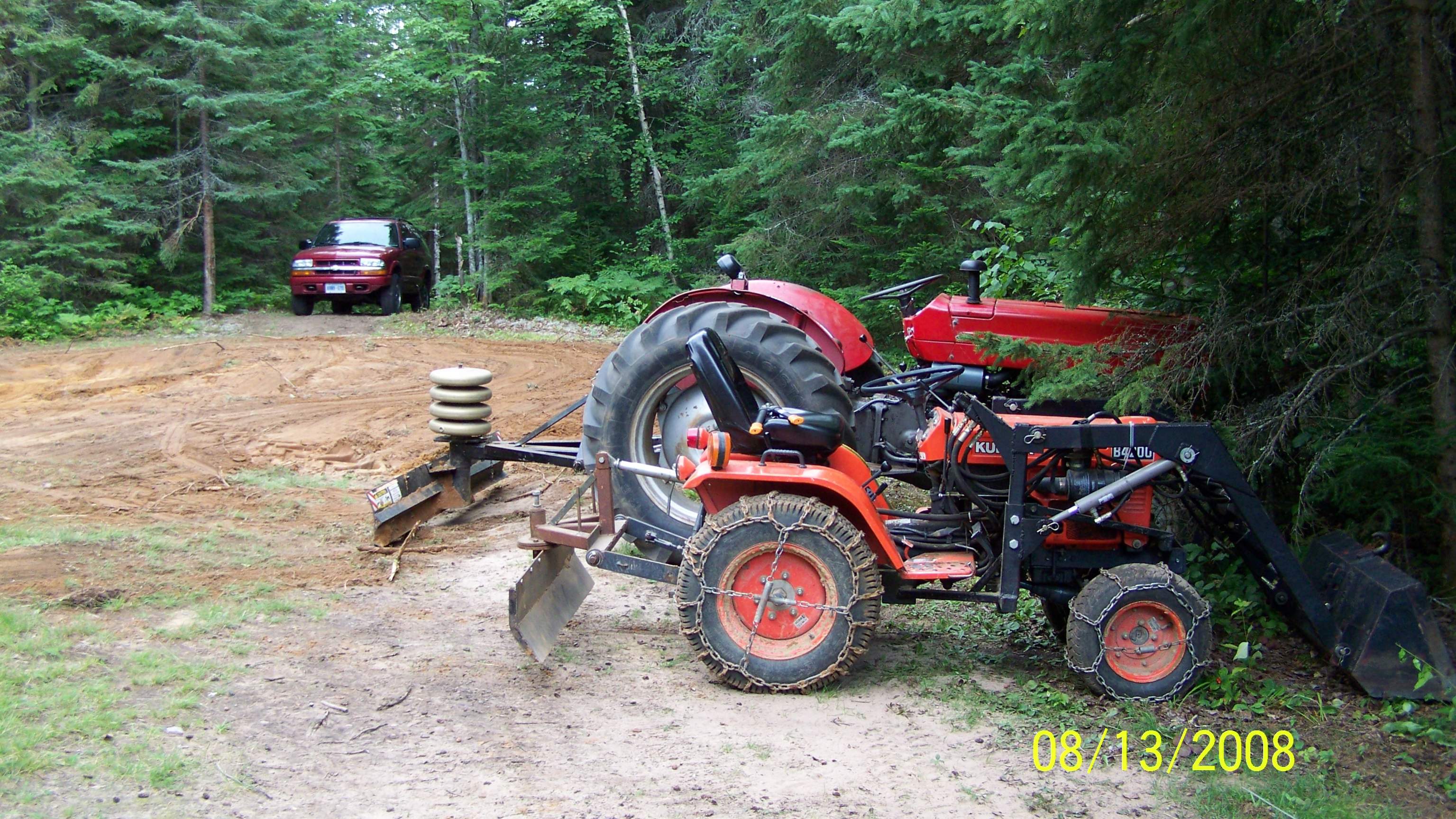

I believe I have about the smallest tractor Kubota makes at 12hp on the 2 cyl diesel. If you have a 3PH you likely have onboard hydraulics, though I don't know your tractor. Look just to the front and towards the right of your seat for a valve. There will be a plugged output, and the big selector switch will have an arrow on it. On mine the arrow pointed to the left which is the position for 3 point hitch operation. I made a loader for my tractor with a 36" bucket.
