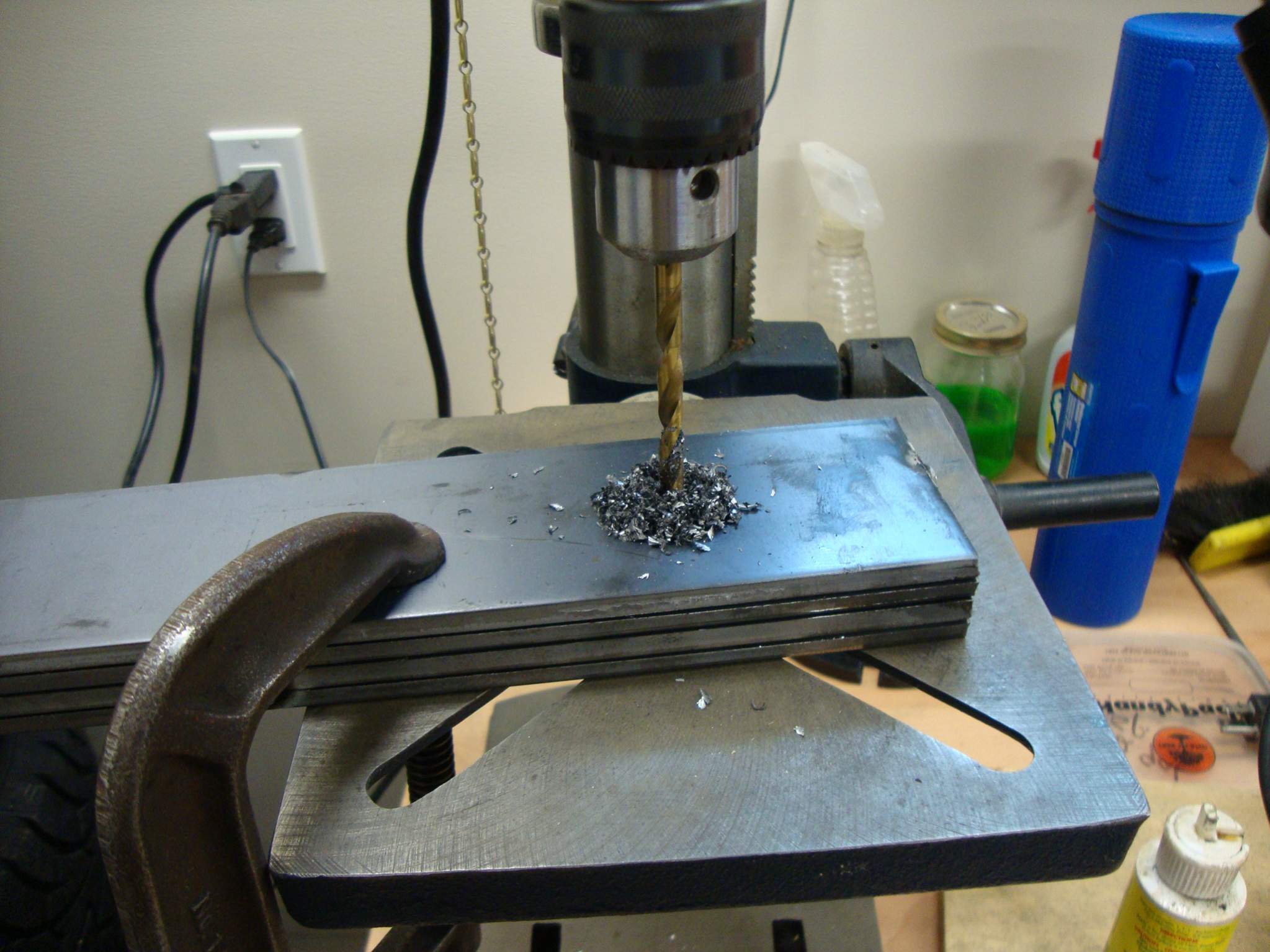

The size for the rear plates was 2.75" x 14" x 1/4. That may get changed as things come together, I'm posting as I build it.
Using a tip from one of the other guys here, I tack-welded the 4 rear side plates together to be sure all the holes were in the same place. Great idea that, it would have never occurred to me if he hadn't mentioned it.
I drilled the pilot holes 1/4", then used a 1" hole saw to cut the pin holes. DOM bushings will be welded over the outside of the plates to support the pins.

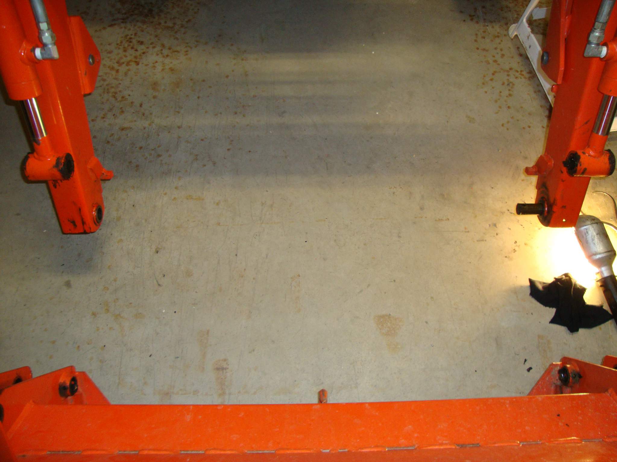

I remembered one of the guys saying that his cross-tube was too close to the loader arms at full curl, so I retracted both cylinders with the rear plates in place, then drew a line across the plates to remind me that the tube has to go in above that line or I'll have the same trouble. I'll be getting the pipe for the cross-tube soon, once I know what the OD will be I'll drill the holes for the tube before I remove the tack welds holding the plates together.

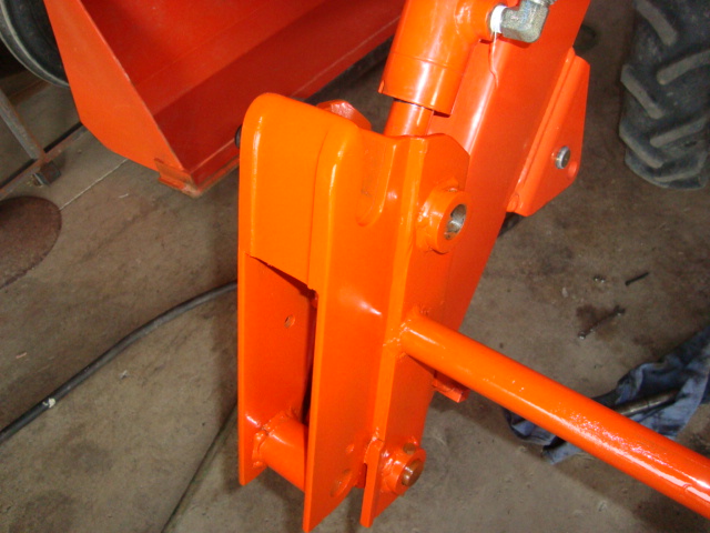

O.K. Chilly, Im back with my repair info. Part of the reason that I got hung up in the bucket the other day is that I bent the upper ear on my QA. How I managed that I don’t know. What happened was that it pinched the upper bucket pin into the QA and it wouldn’t release the bucket. It only took a few whacks with a 2lb sledge to straighten it back into position. Apparently a weak spot that needs some attention. I didn’t have a piece of ¼” flat bar to weld into it but did have a piece of ¼” wall square tubing. I cut a 4” piece out of it and cut the center out of it so that I had 2 repair plates so to speak. I welded these into to face of the QA inside out and that’s why they look kinda funny. Its strong enough now that I wont likely bend it again however it might not hurt for you to box this section completely in when you build yours, certainty couldn’t hurt. I also wonder if I built the ear too tall as I have seen other homemade QA s with a much shorter ear so that’s something else to look into. But the one thing that I discovered while sitting on my L3400 is that its very difficult to see the ears on the QA when hooking into another bucketso for me I think that the taller ears are to my advantage. Sorry, I didn’t mean to hijack your thread, I just want to point out a potential weak spot.

Nice looking repair. I had planned to add some stiffeners here and there, but I didn't think that area would be prone to bending. Good to know.

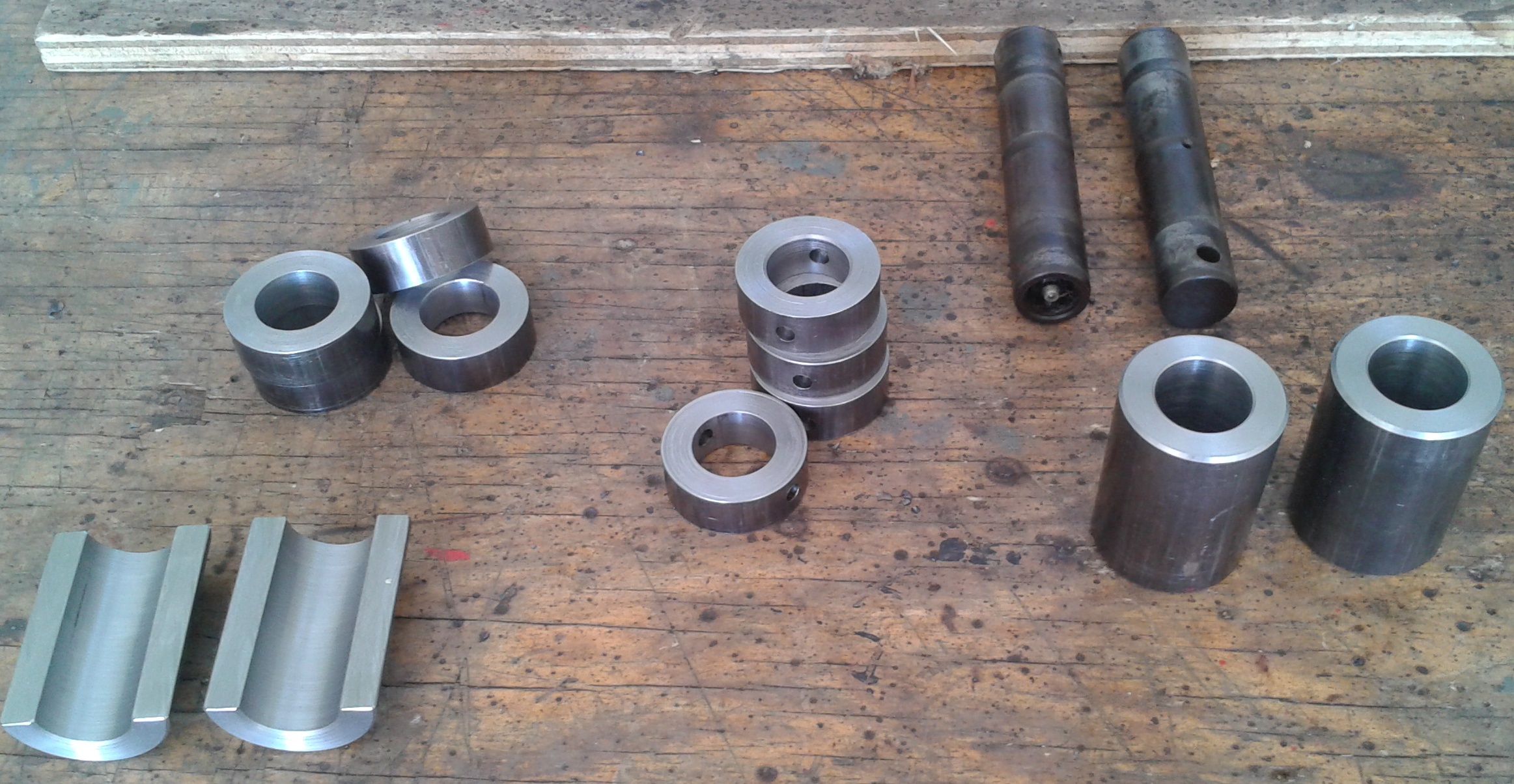

So, I had a piece of 1" ID, 1 3/4" OD DOM tubing laid aside for this project, it turned out that the ID was too small without some doctoring. It was 0.996-0.998", my pins are 1.00" nominal size. They've worn to about 0.996" in spots, but the existing bushings are around 1.025". I'm kind of surprised how much they've worn in less than 400 hours of use, although probably 40-50% of those hours are loader time. I don't know how big they were to begin with, but even with almost 0.030" of play the loader isn't too sloppy.
I enlisted a machinist friend of mine to part off 8 bushings, each 5/8" wide from the bar of DOM tubing. The longer bushings in the picture were cut off with a recip saw, I squared the ends on a small lathe and then split one of them down the middle with a hacksaw. I have access to a machine shop with some great machinists, and every toy from a simple lathe to water jet cutting tables, but I'm trying to do as much of this as I can with tools most of us are likely to have available as hobby farmers and home gearheads. So far, all I've had to use that I wouldn't normally have has been the lathe to bore the bushings out and square the ends.
Anyone that's going to tackle one of these should be prepared to spend a little bit on machine shop time, or else be more patient with a file than I am.
I passed a 1.005" end mill through the bushings, it did a great job of opening them up to a size i can work with, my pins slide in neatly with a little bit of play, hopefully enough to keep things from binding when I weld. I drilled 4 of the small bushings to take the pin retaining bolts.

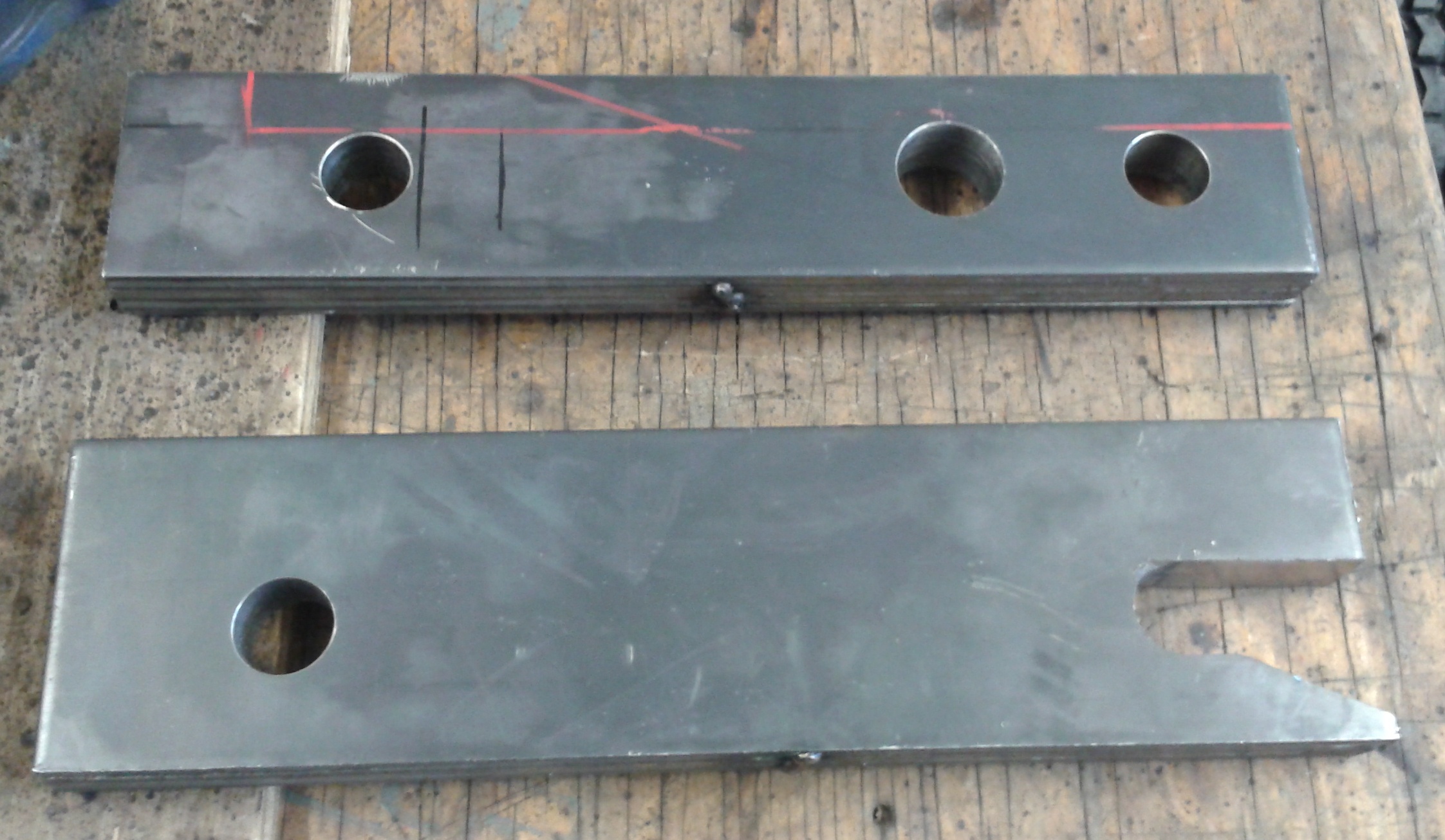

Today started by cutting the last hole in the loader side of the adapter plates before they are separated, the 1 1/4" hole in the middle for the cross bar. I used a bi-metal hole saw and lots of cutting oil. My drill press hates me after cutting through what amounts to 1" of steel using a hole saw. I cut the other holes a couple days ago.
I picked up a 48" piece of 1 1/4" solid steel bar yesterday for the cross-bar. I had planned to use pipe to keep the weight down, but anything that would fit comfortably in the side plates was a bit small for my liking. The next nominal size up was too big, so I went with solid bar (more variety to pick from).
For the front (bucket side) plates, again it was a 1" hole saw to start, then I used the recip saw to cut the top slot to rough size. Finish work was an angle grinder and a file to get the right shape and size. I decided to leave them all laminated together as long as possible, that way all 4 are identical. Hopefully correct, but at least the same.
