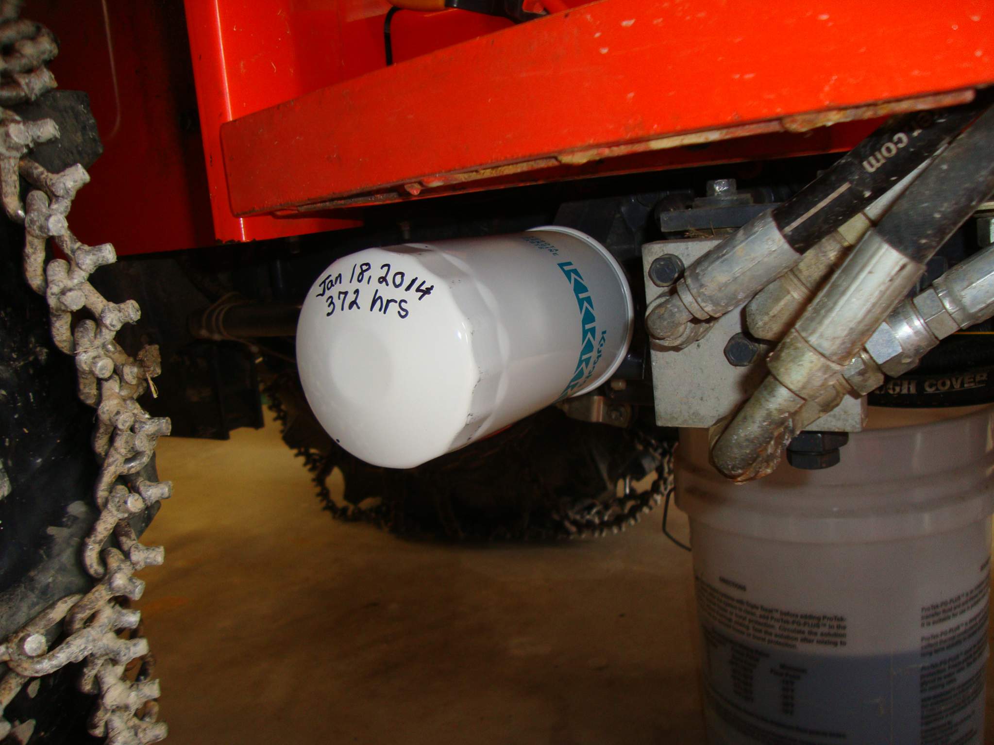

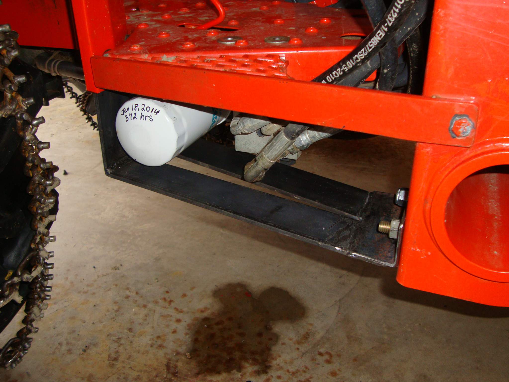

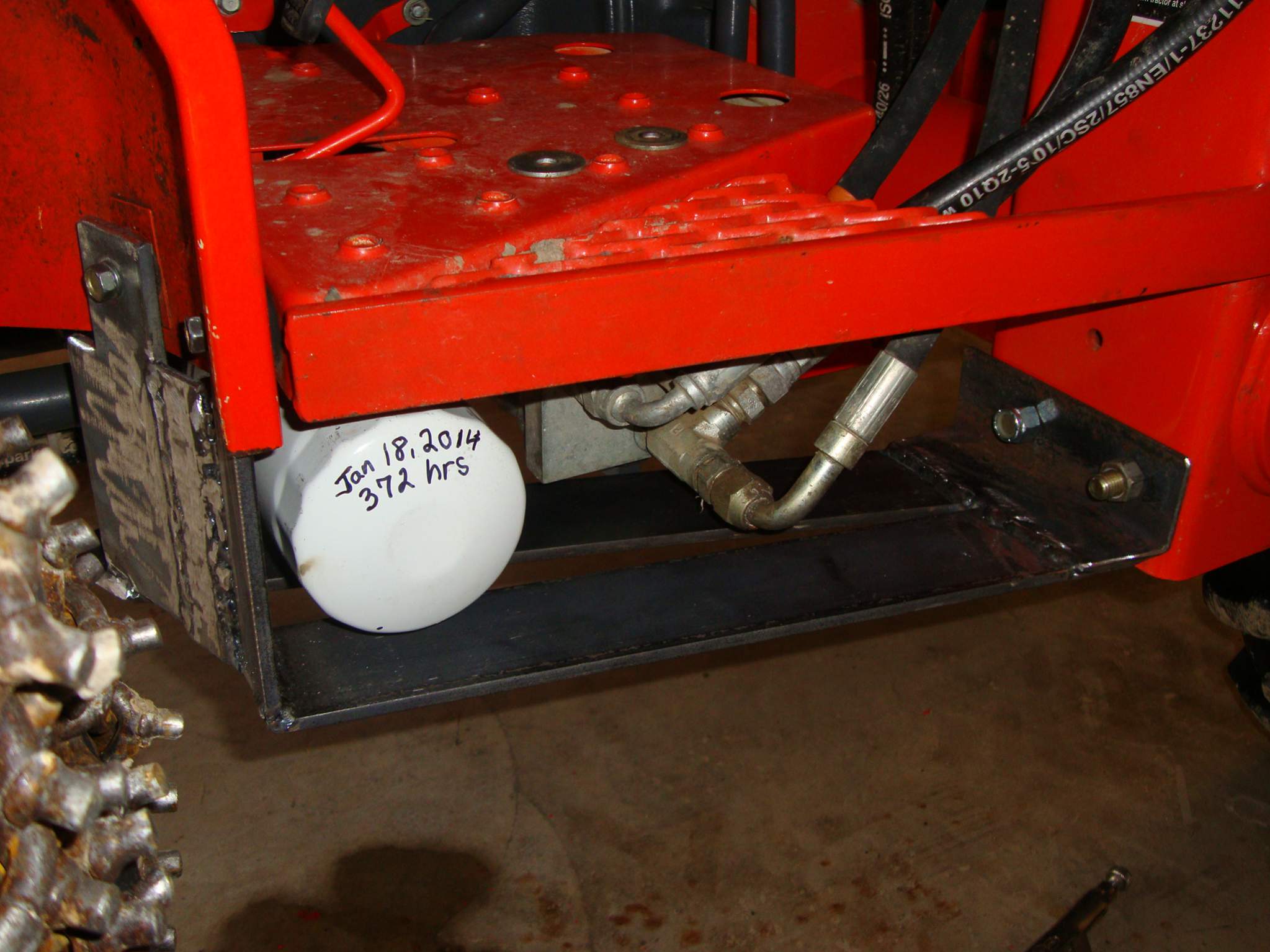

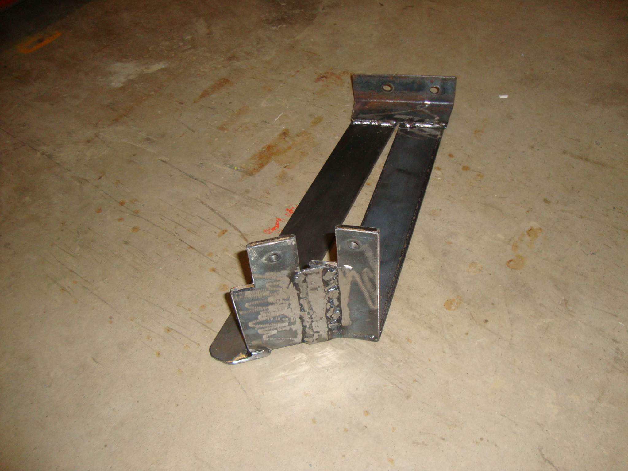

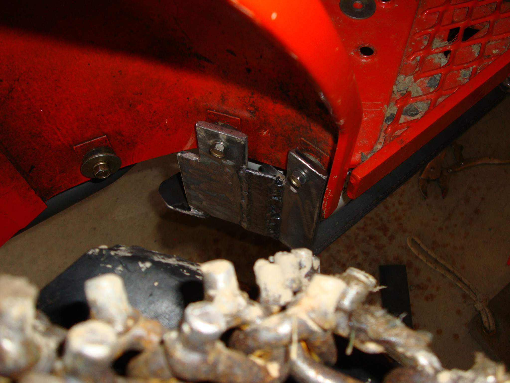

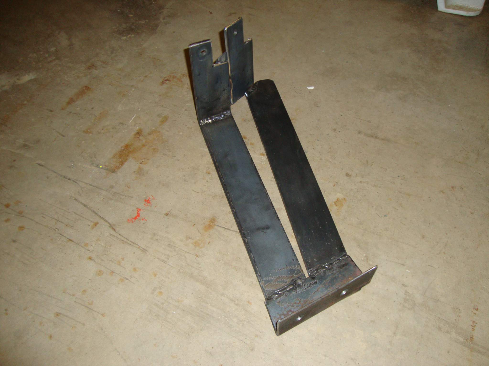

I've often thought the hydraulic filter was in a bad place for accidental damage under the right floorboard. I recently switched to the larger filter from the Grand L series and it's even more of a target for rocks and sticks. A bit of leftover steel and some welder and grinding time and it has some protection.
All that's left is some final bracing between the two bars and some screen maybe, and some paint. I'll probably skip the screen, there's not much chance of something getting at it.

Good job, that will work.
   / Building an L3400 hydraulic filter shield #3
Looks good Sean.
   / Building an L3400 hydraulic filter shield #4
That looks great! I need to do the same for mine.
