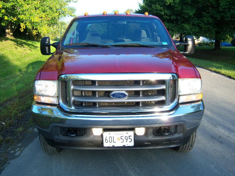

I don't need a full bumper setup YET but am looking at getting a deer catcher for my dually.
(note - not my license plate)
I want it eventually set up with a 2" receiver so I can put my 12,000 lb pull winch on the front if need be, while still being able to move the winch to the back.
Any good recommendations for a brush guard for my F350 for mail order or a factory pickup between either of my travel corridors?
I looked at a few places and one with separate shipping charges wanted $125 on a $550 brush guard.
Problem with a separate guard is that you're still relying on the stock bumper to bounce the deer off. They have a tendency to fold those fairly easily. They're called "brush guards" and not "deer guards" for a reason, as most of them are very thin walled construction by comparison. They'll protect against most minor dings, but not a solid hit from a deer. There will also be precious little metal to mount the winch on. The bumper replacement gives lots of solid steel to help anchor the receiver tube. There may be something out there that allows you to keep your stock bumper and add a winch, but I'm not aware of any at the moment.
