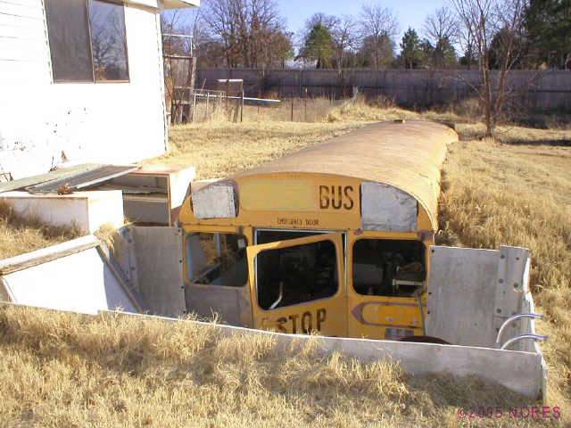

Hey, while they are at it, here is an idea for a nice storm shelter for them...:D

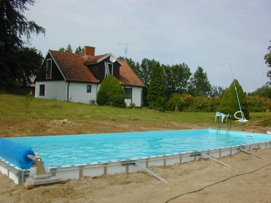

I found some pictures from the time the pool was built. Here you can see the structures supporting the walls. They end in a concrete block. The white on the side is styrofoam insulation which is also covering the floor (a denser variety)

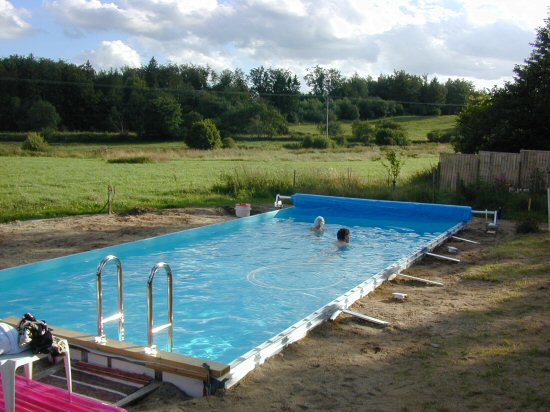

This is from another angle. Nice views!
I now have added solar heating to save electricity. It is very effective.
