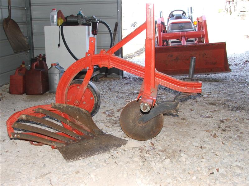

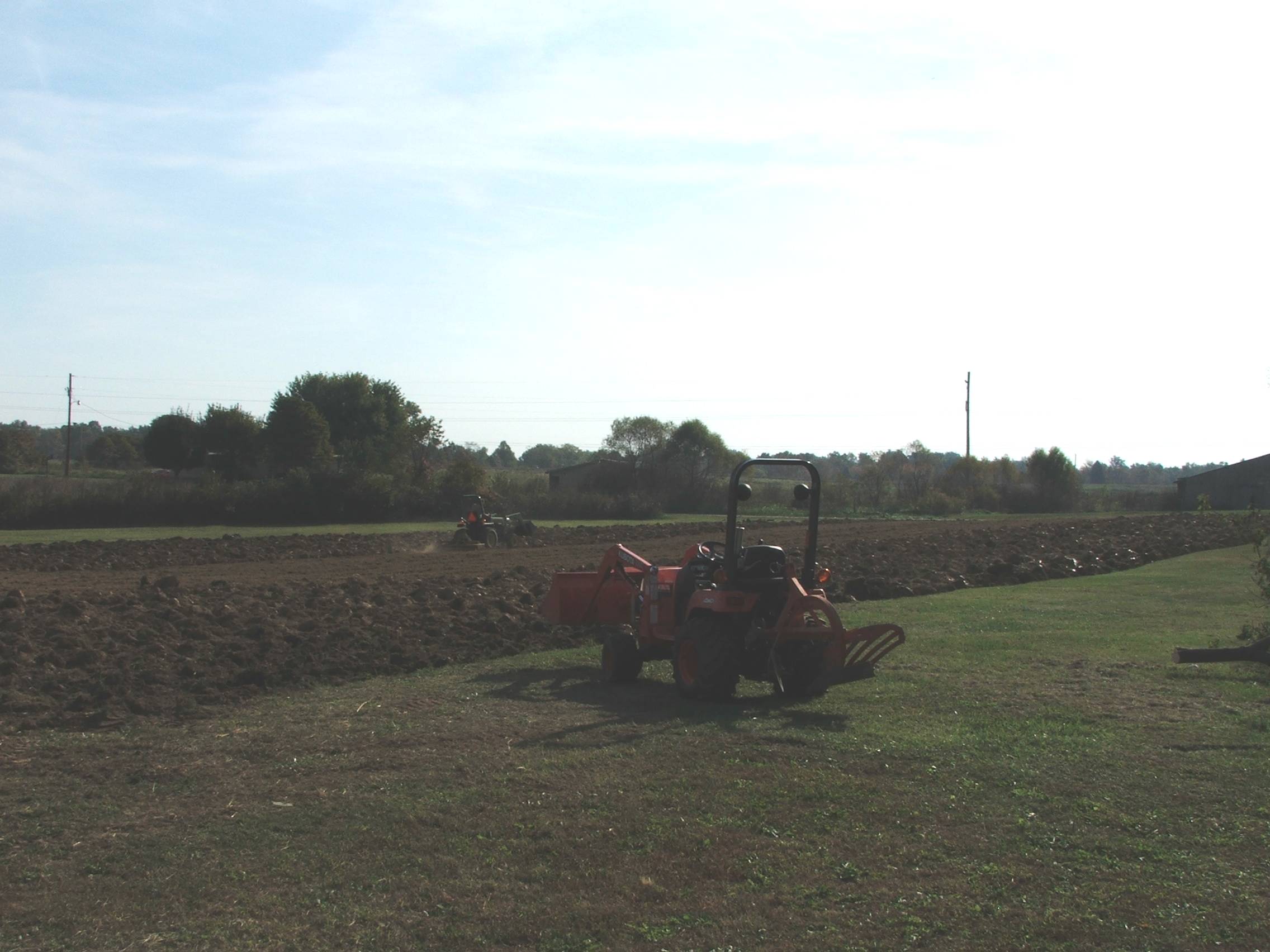

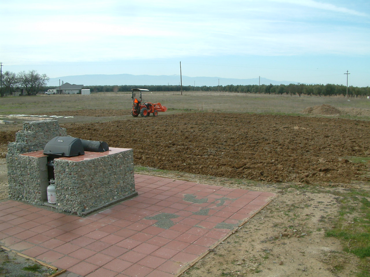

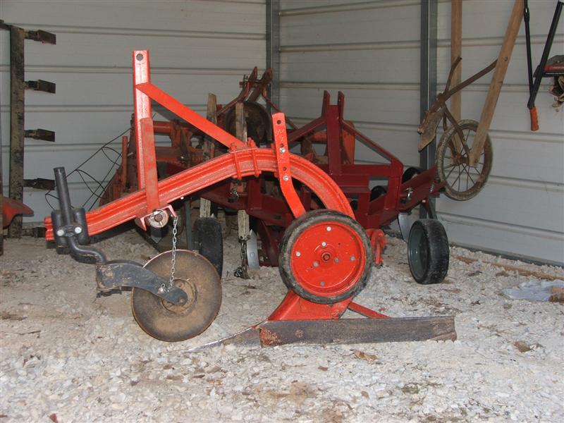

I'm not sure how easy it would be to pull a true moldboard plow with a BX or any tractor for that matter that doesn't have draft control. I would love to hear from some people's experiences. I can see where a subsoiler may work okay without draft control though.
   / BX and a soil plow #9
Works really well (see link in post #7) the pics there were in really dry, hard ground, I have used it in a lot better soil since then and have added a depth wheel to maintain a constant depth. Really enjoy my 14" single bottom true moldboard plow and the BX has no trouble at all pulling it.
