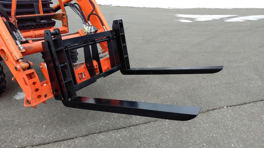

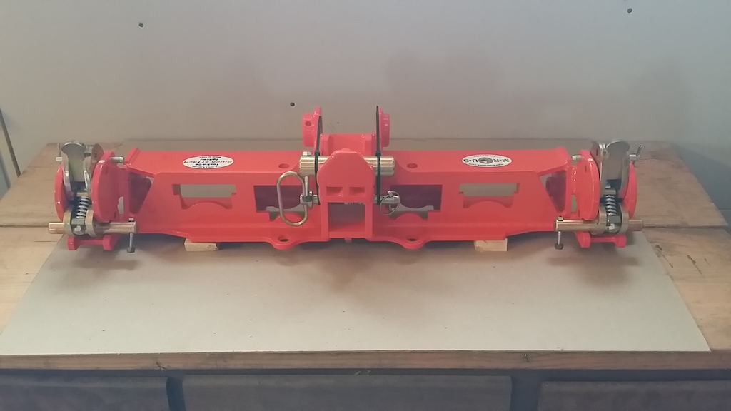

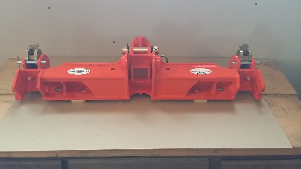

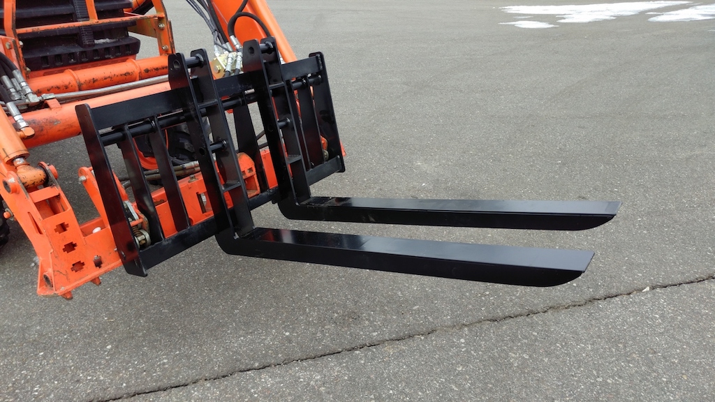

Here are the pics that Jery sent me of the Tach n Go (front/rear) and the moveable forks (narrow/wide).
The Tach no Go weighs in at 65# and have a 2in receiver built in which looks to be a nice feature. Don't know the weights of the OEM accessories but this is my dilemma. I could save some money by buying the OEM QA and Jery's Forks and sacrifice the hitch and more convenient connect process (from what I'm told). On the plus side, Jery's Forks are 36in vs. 32in. This combo solution below is cheapest and I think lightest weight.

Okay a little update. Jery called me and we had a very nice chat. I'm now leaning pretty hard towards the Tach n Go and moveable forks shown in the pictures posted. One feature I really do like is the 2in receiver hitch. This obviously allows mounting of a ball or a ripper/trencher, or other oddball items. The other concern that I have heard from others is the Kubota OEM QA connect to the OEM bucket is a little sloppy. Jery confirmed this and said he has had customers buy the Tach n Go to replace their OEM QA.
