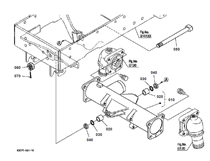

I haven't been to the forum in awhile, but it has always helped me in the past.
I have a BX 2200 that is seeping gear oil on the back side of the axle at the pivot point. Has anyone ever replaced the o ring and back up that sits behind the fixed head of the bolt that goes through the axle and tractor frame ? I'm certain there is no pressure in the housing and that the oil is just sloshing around in there and seeping past the seals.
I would think the parts are cheap, but not sure how to get that out of there.
Any help would be appreciated.

I think that if you post some pics it would be more helpful. And, if the BX is like my GC, the front axle will build up pressure as the oil warms up, these are sealed axles so there are no vents. But, maybe a BX owner will chime in.

Is this the pivot you are referring to (In the center)? Hope this diagram helps. It's for a BX2230, but should be the same as the 2200.
The front axle does have drain and fill bolts, so it's easy to let out the fluid.
By the way, here are the part numbers referenced in the diagram.
010 K2561-90200 ASSY CASE FRONT 1 9.9 21.78
020 08511-02025 BUSH 2 0.02 0.044
030 67817-37190 O RING 2 0.001 0.0022
040 K2561-15250 RING BACK UP 2 0.001 0.0022
050 K2561-15133 SHAFT CENTER 1 0.66 1.452
060 K2561-15190 NUT 1 0.02 0.044
070 75599-53195 PIN COTTER 1 0.003 0.0066
Hope this is helpful.

What kind of oil are you using? They with super UDT I had a leak and switched to SAE 80 gear oil, stopped the leak. Others on here have had similar results.
