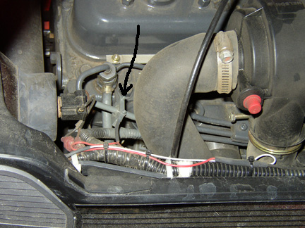

The tinytach on my BX reads about the same as the other posters - yours certainly seems to be reading high.
Perhaps you should try repositioning the sensor.
Did you sand the paint off the fuel line before attaching the sensor?
Are you using the 6mm sensor?
You may need to return the tinytach and get another one.
Attached is a photo of where I attached the sensor on my BX.

Is the 6mm the right sensor for the BX? Where did you guys mount the display?
On a sidenote, a company named SenDec makes a nice round flush mount with factory programable service alarms but, unfortunantly, it doesn't work with diesels or more than 2 cylinders. /forums/images/graemlins/frown.gif
   / BX2230 RPM specs #8
Yep, the 6mm is the right size, and I mounted the display just above the switches with velcro on the left side of the dash, I pulled out the switches and run the wires through and snapped the switches back in. /forums/images/graemlins/cool.gif
