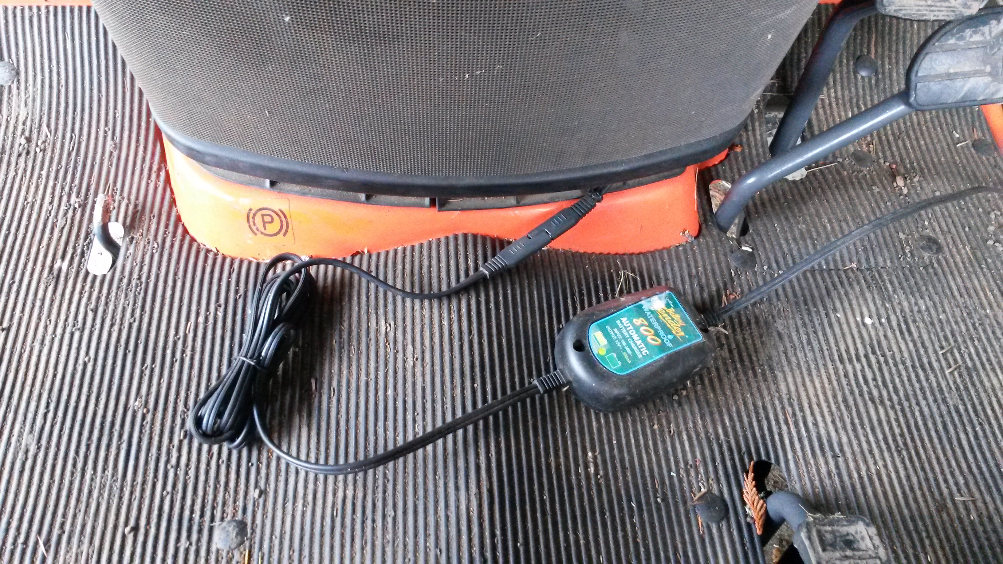

As above...
I have the print, but it doesn't have a wiring location diagram.
I have 2-10 in. connectors w/o fuses, and 24 in. connectors w/fuse.
I would rather find a protected place under/near the hood than under the battery grille (easier to get to in snow).
I expect connectors not long term UV protected.
Anyone know a best location?
THX

On my Bx25 I routed a 24" extension up and under dash, under the hood, next to the latch. I have to pop the hood to utilize it but Im fine with that, the 5-6 times a year I use it. They also make ports if your willing to drill a hole somewhere on the dash.
http://www.tractorbynet.com/forums/...ery-tender-plug-port-bx.html?highlight=Tender
This is what I did on my BX25D except I mounted it on the right side. Yes you drill a hole in the plastic shroud but so what... it is super clean and handy and looks like an OEM option. No dangling wires which I lived with for a year before drilling the hole. I plug my Battery Tender in regularly because it is so easy with a jack on the 'dash'.

Just gotb a marine grade lighter plug and put it on side of dash panel connected direct to battery with fuse. Plug cell charger into it, electric sprayer or battery charger, no need to remove cover.

Last night I had to replace the battery in my BX2660 (the battery tender was not keeping the 8 yr old original battery up to par anymore) So while I installed the new one , I put the clamp on leads from the battery tender on the terminals too , and slid the battery in and checked and I see the clamps don't touch anything , and I drilled a hole in side of dashboard and ran the two prong plug out the side, now I can plug in tender anytime I feel need without having to pull the battery out to access the terminals. I hope my simple way works out. I can't see why it wouldn't by leaving clamps on . I guess I could cut the clamps off and put circle terminals and use the terminal bolts instead eventually.

The best point is a permanent pigtail connection to the battery. Then either a short or long length from there to a convenient plug receptacle that you plug the tender cord into.

Lazy man's approach: pigtail rings under the battery terminal bolts. Pigtail connector pokes out under the bottom of the battery/air intake screen.
Been that way for years on my BX24. Inelegant but it works.
