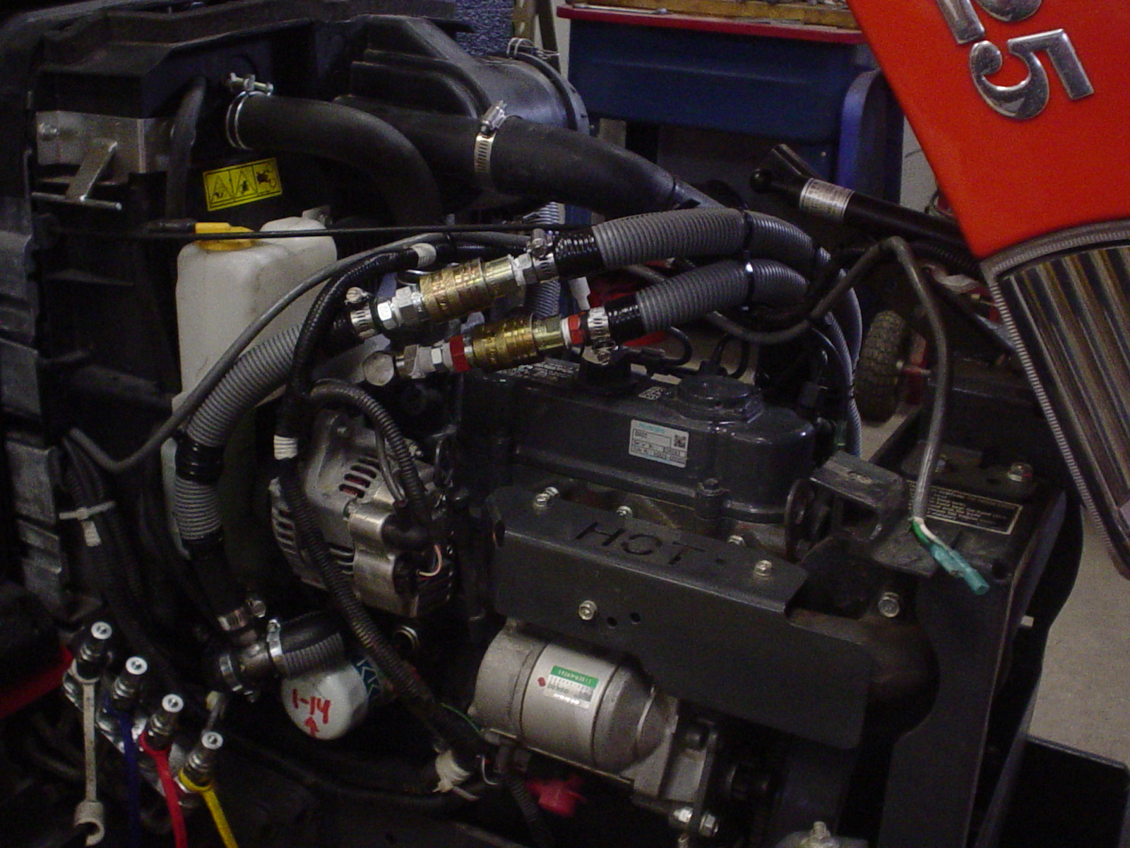

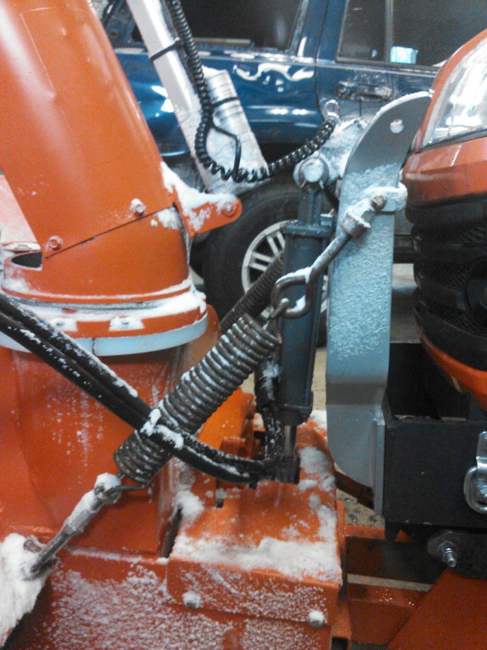

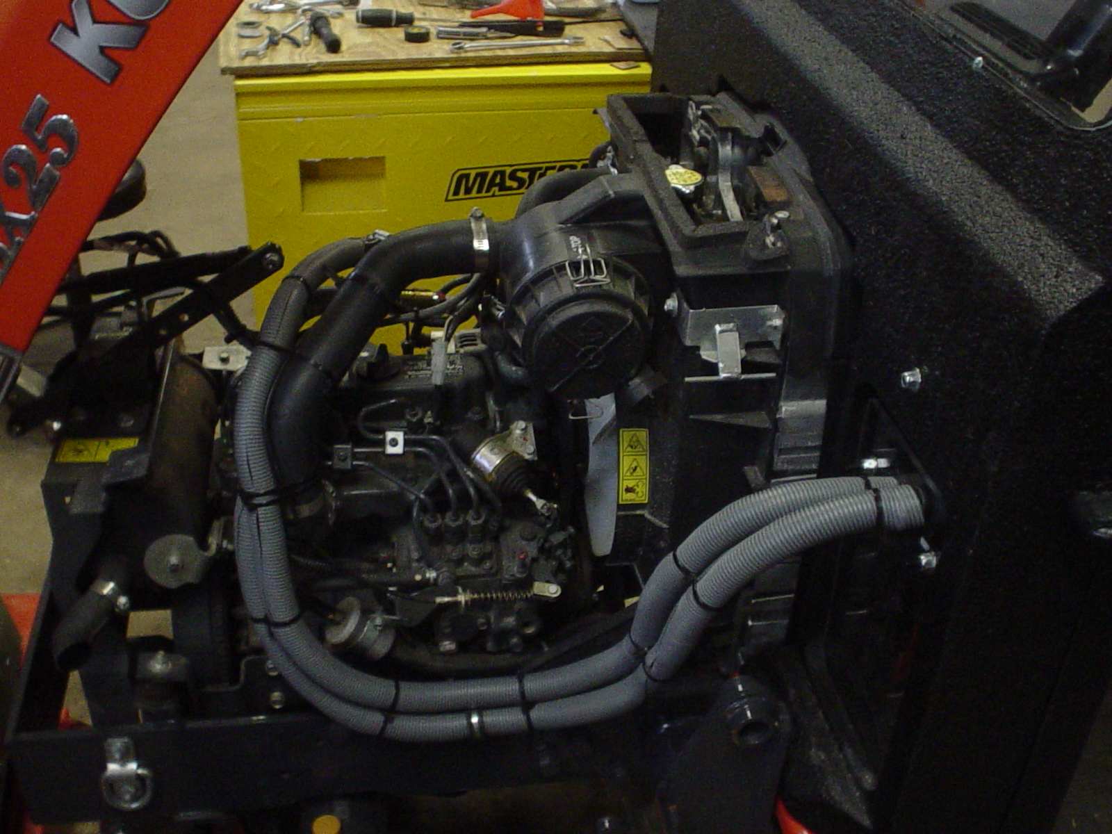

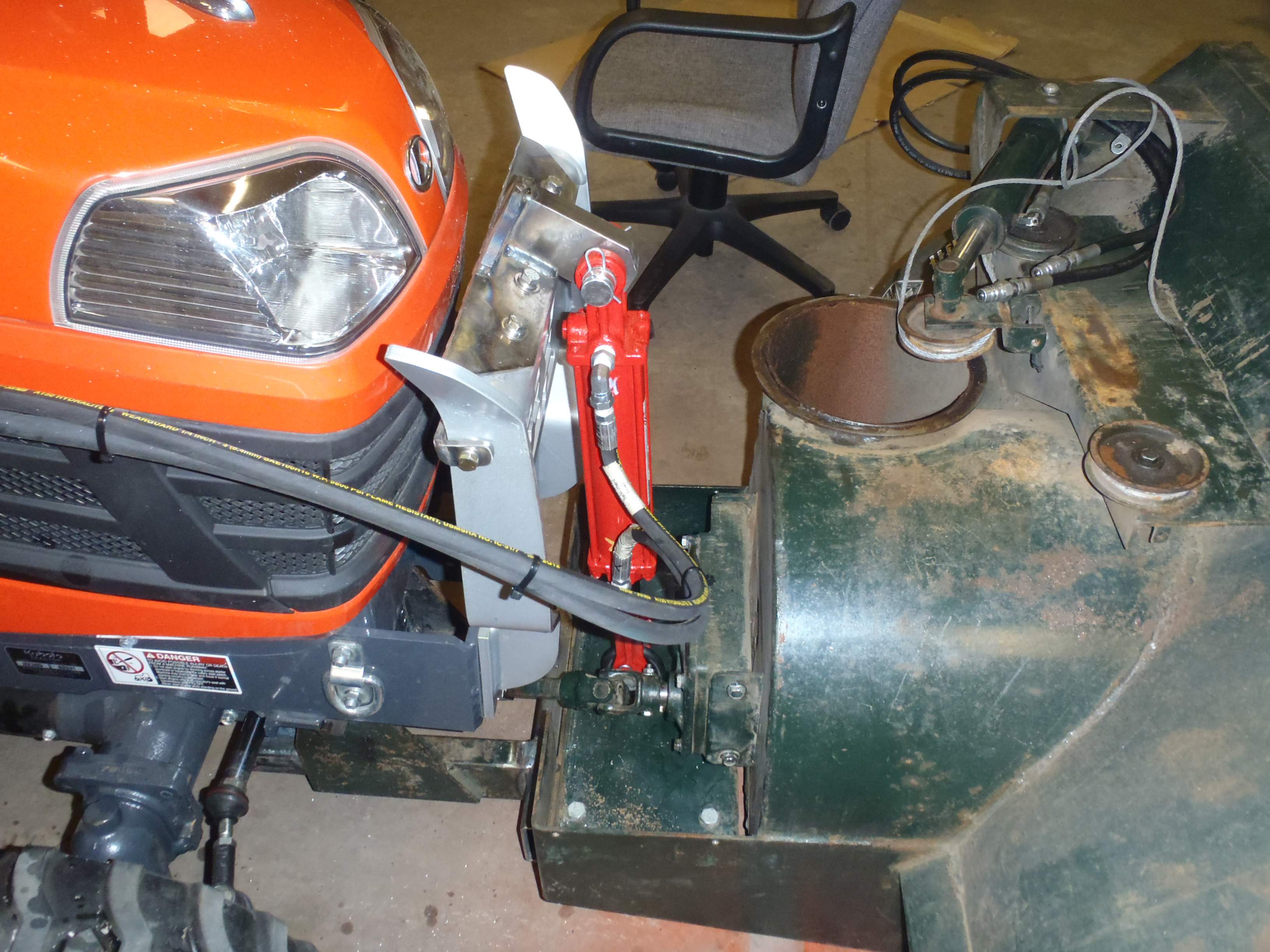

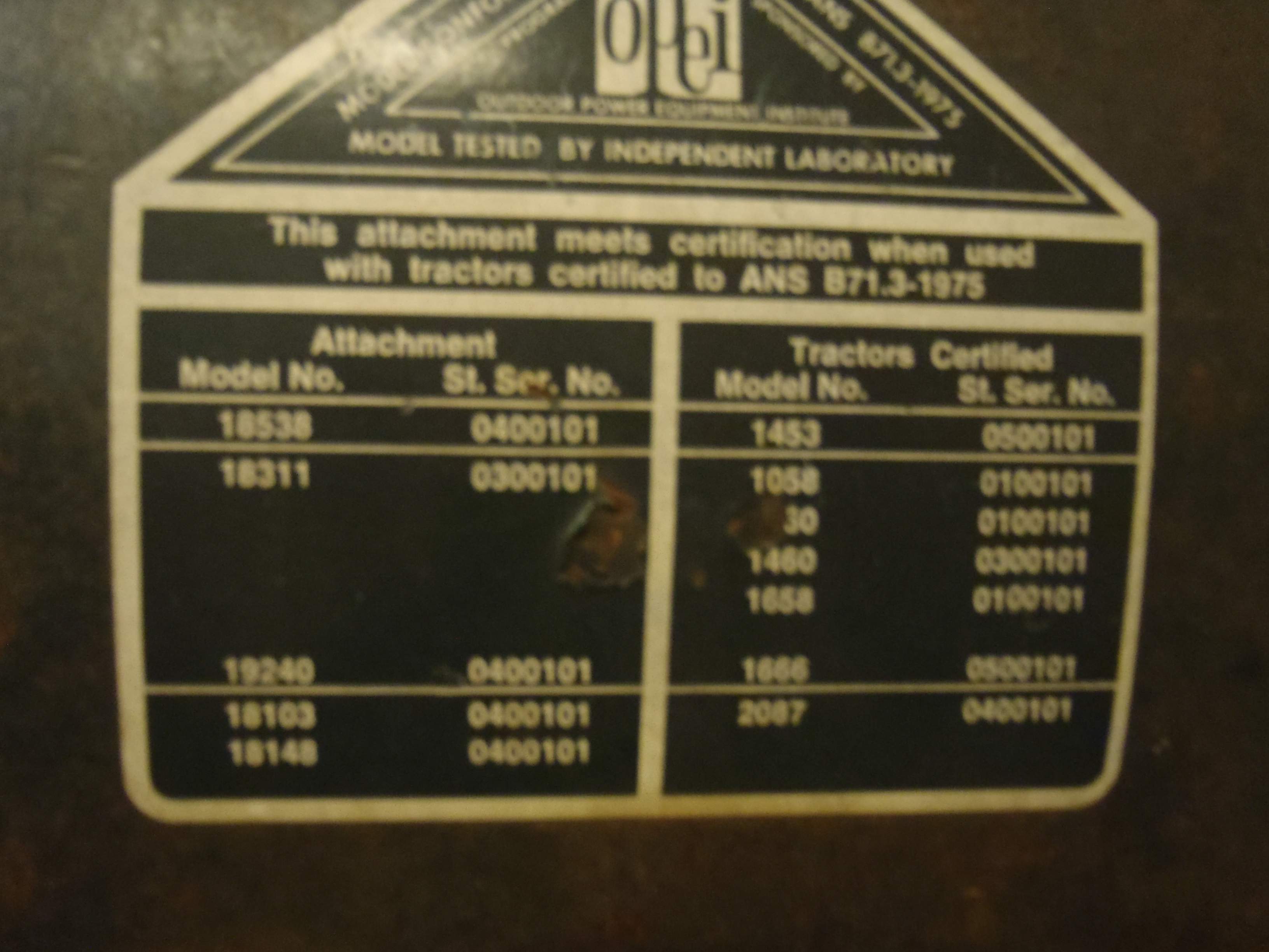

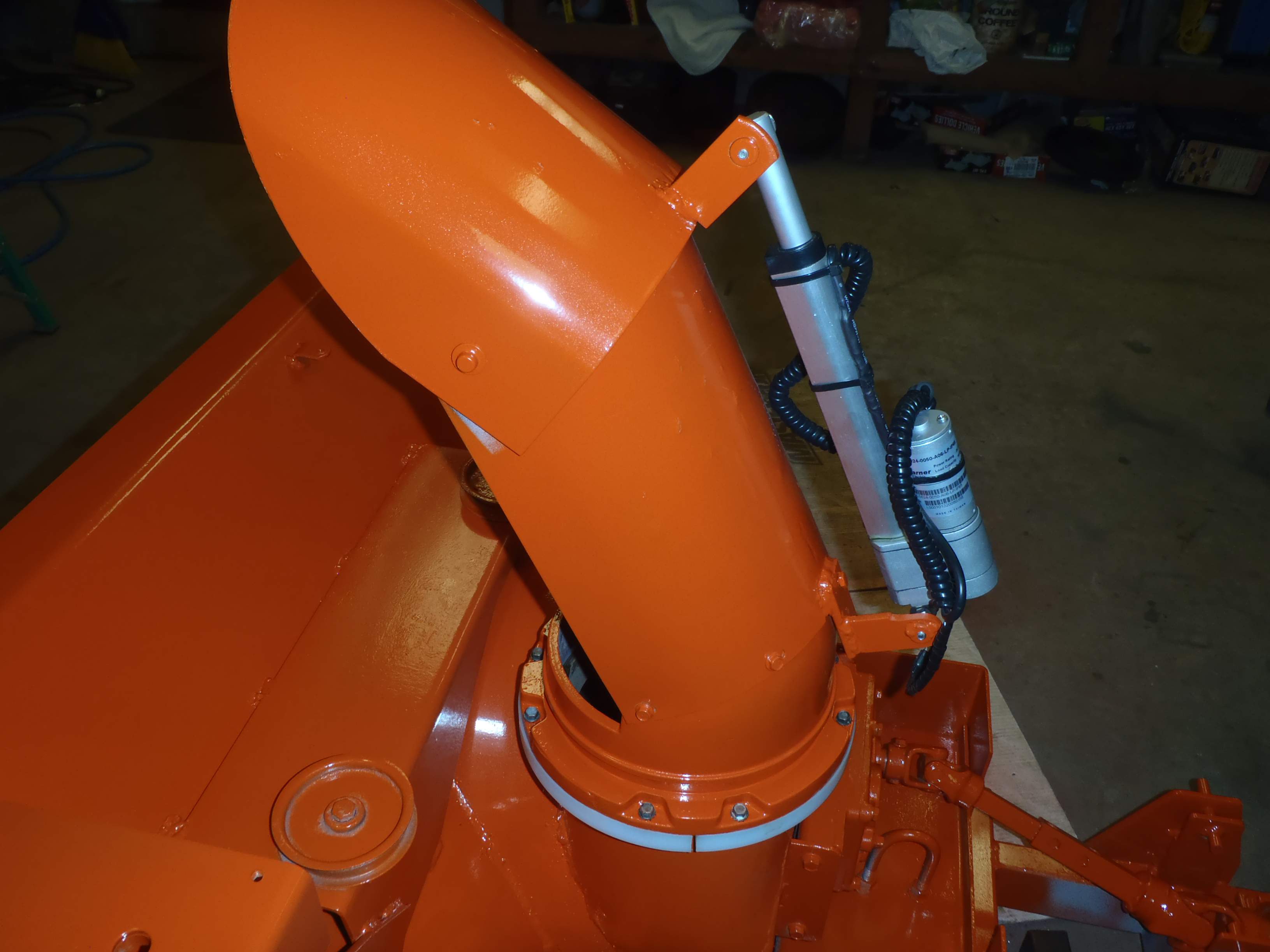

Rotation is correct. It's a Bolens model 18148. It's big & heavy,about 500lbs, but I only paid $300.00 for it. I have almost that just in the pto shaft. The blower was in great shape, I believe by S# it's a 1982. Gear boxes are solid. I think think they are designed for 2400-2500 rpm's so close enough.I did add the 2 springs that came with it to limit down force to 125 lbs so steering was not affected. Heater is from JEGS performance-pretty cheap compared to other sellers of same heater. Because I take my cab off in summer I put quick disconnects on heater lines. they are hyd. QD's that are rated to 260 degrees. NCM950015.jpgPB110285.jpgPA310253.jpgPB160303.jpgDSC00002.JPGDSC00004.JPG
