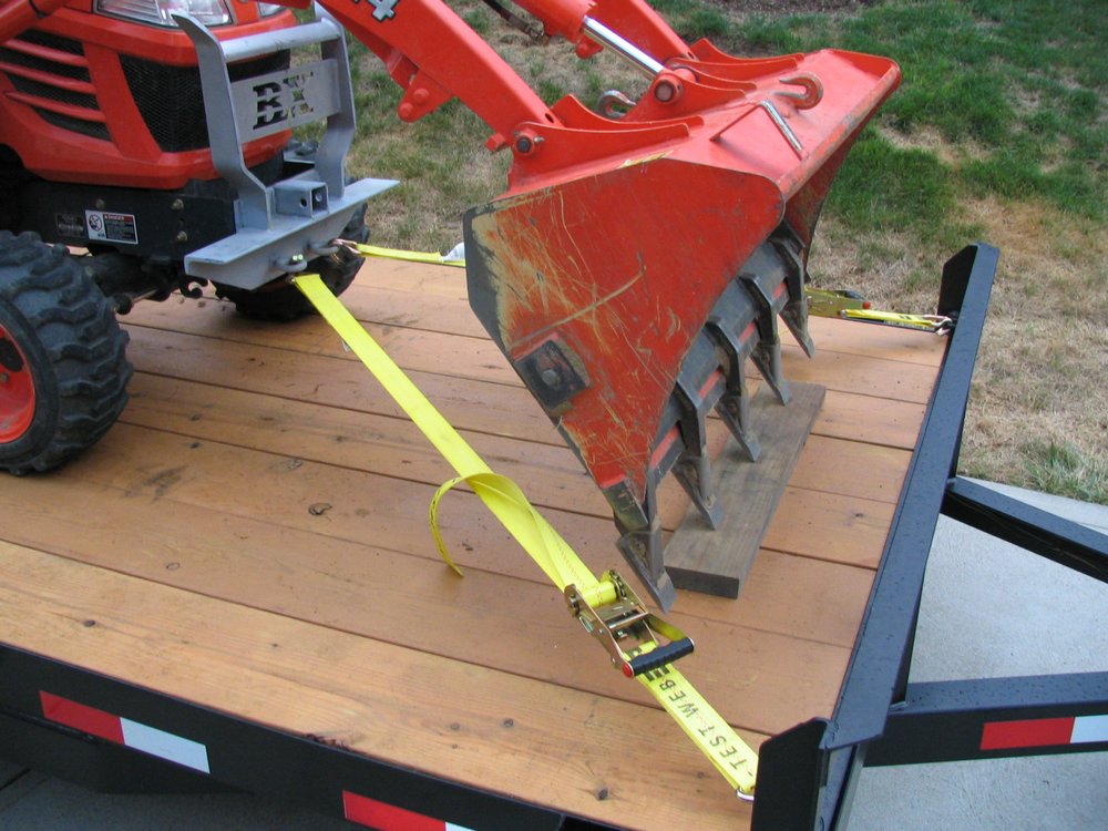

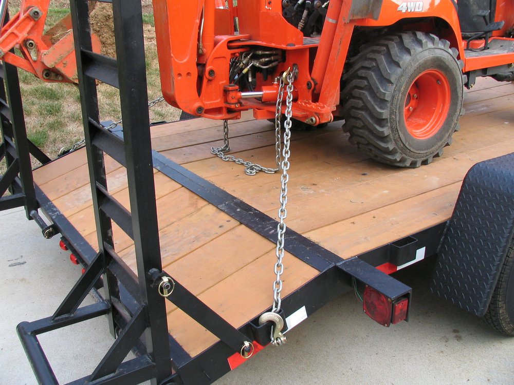

If your goal is to tie down or pull from the front of the machine - latching on to something that is directly tied to the frame is the best way to go. I added these eyes to tie down the machine on a trailer, but I ultimately cut off the receiver hitch because it was next to useless in the front. It was hard to see as well as being static in its movement. When I put the receiver on the bucket I used it all the time for lifting and moving trailers around. At the time I made a blank insert to put in the receiver when I was loading material with the bucket, but I never used it (not even once).

For a cheap quick solution I would put a receiver back in the FEL bucket in a heartbeat. As for the rear, why not just use a shackle through the existing hole?
