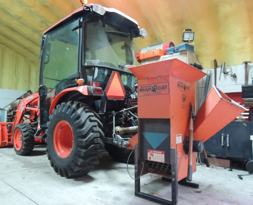

Neighbour just got a new Wallenstein BXM 32 chipper shredder for us to use. I went to set it up and put it on his new BX2370 and find that the 3 point hitch won't lower enough for it to sit on the ground once I took it off the shipping pallet? Anyone else encounter this? Wondering if I need to make feet for it now.
I haven't tried it on my B2620 yet.
We are both waiting for our quick hitches to come in before I cut the pto shaft.

There was another thread on here that sounds like this issue...seems that the solution was that the user kept a pallet around to lower the unit onto. Keep in mind the angle that the PTO shaft may be subjected to. Curious if your B2620 has the same issue. Is the BX a cat0?... or cat 1 like your B26xx.

My chipper is not a Wallenstein, but I had a similar issue. I had to reweld new lift points onto the chipper so it would align correctly. You want to make sure the unit can rest on the ground when using it to take the stress off the 3 point hitch.
   / BXM32 Chipper Shredder #4
I've heard of it many times including with my own situation. Some guys just leave it on the pallet. The problem with also leaving it low and without the pallet is the angle of the PTO shaft is pretty steep. I built an aluminum adapter for mine that also has allowances to put castors on it so it can be lowered and removed and with the castors on it can be moved easily around.

I believe PTO chippers are designed to remain a little above ground level, so when operator reverses tractor the chipper will not be over-stressed when inadvertently used as a plow.
I use a 5" diameter limb under my BX42.
   / BXM32 Chipper Shredder #9
A lot of folks will bolt a 4x4 or 4x6 under the chipper/shredder to keep the PTO as level as possible when the lumber is resting on the ground. I am planning to do that when I get a chance, but for now I just stack a few 2x4's under the back to keep things nice and level.
   / BXM32 Chipper Shredder #10
My BEARCAT has adjustable legs to allow for different 3ph heights.
