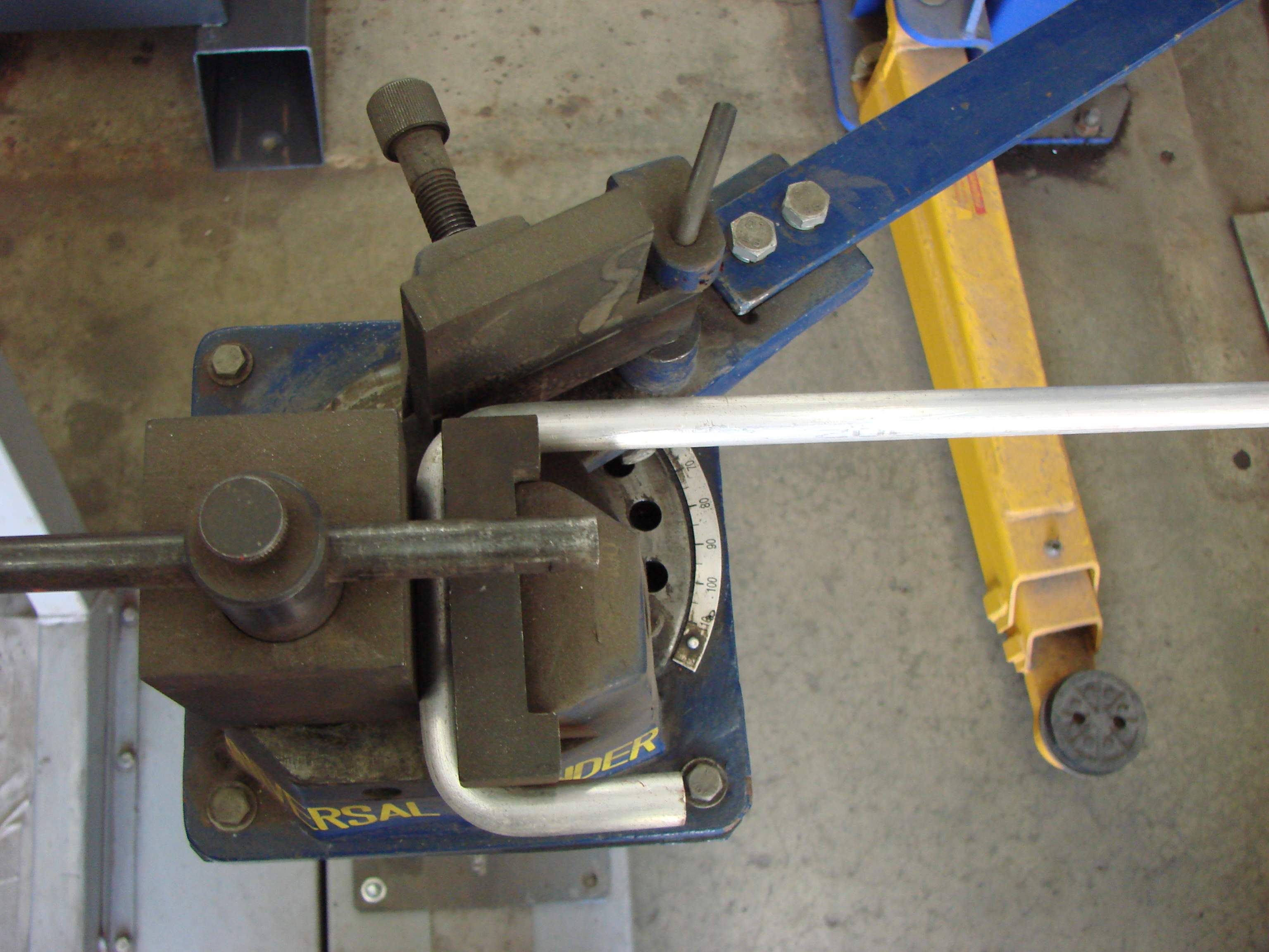

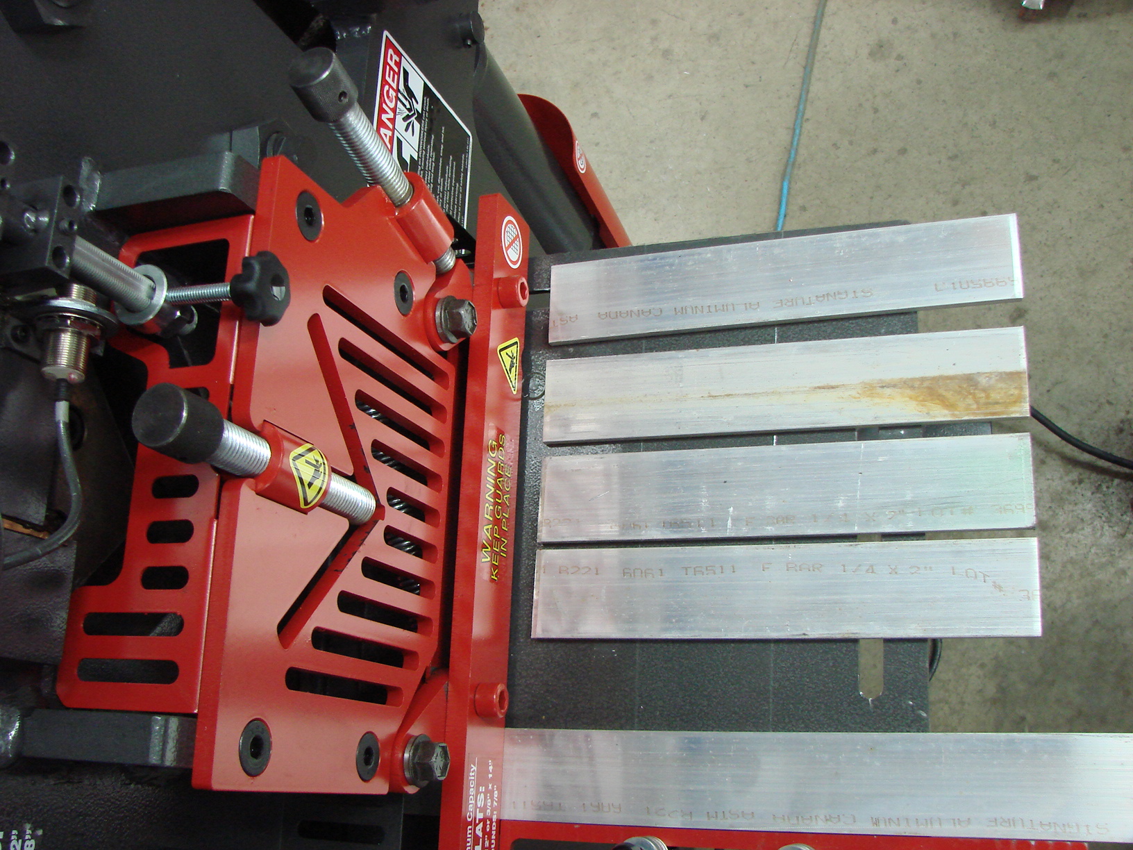

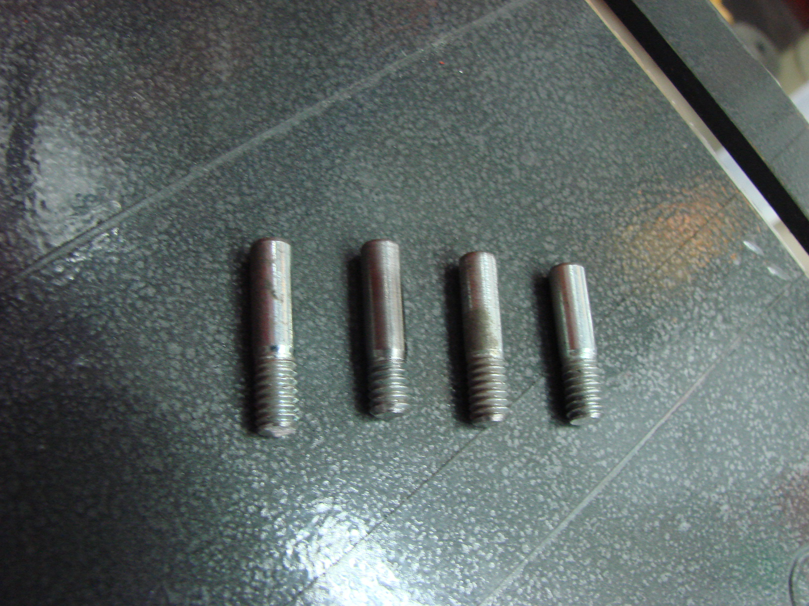

Ok to keep the boredom going here's a few more pics of my little project. All the fab work is done. I added a few handles to the boxes. I'm showing you how I decided to mount them to the machine. Simple but very effective. they just lift off and easy to attach after I need to empty them.

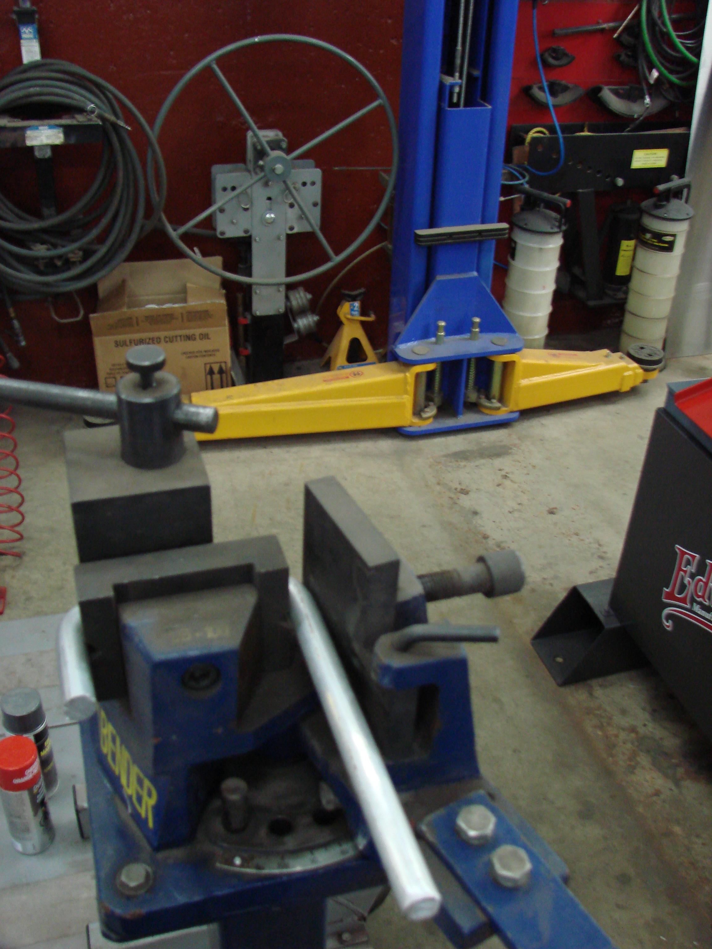

I used 5/8th solid aluminum round stock for the handles. I added pics to show those who are interested how I bent them. I didn't use any head in the bending but I did go really slow.

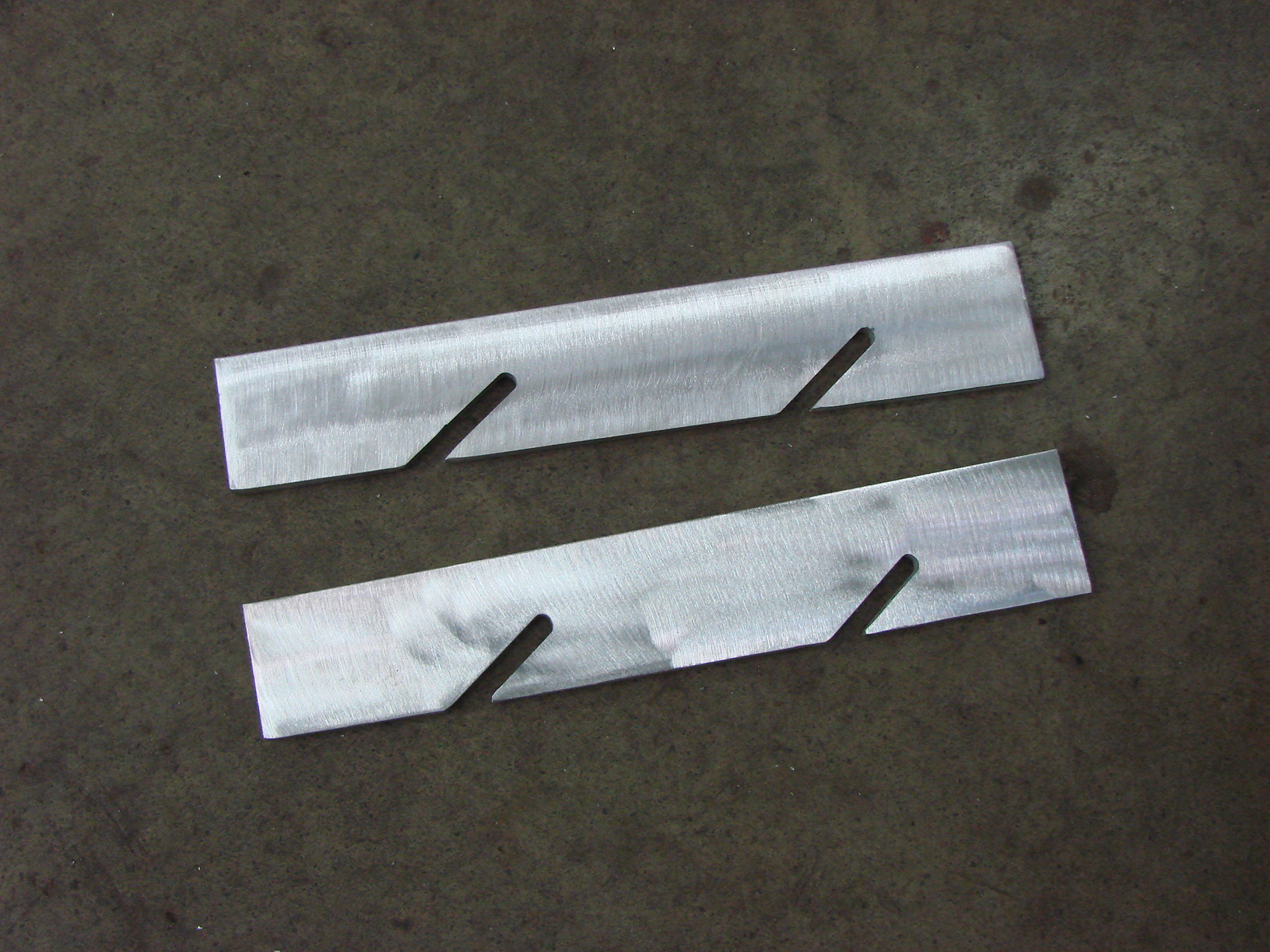

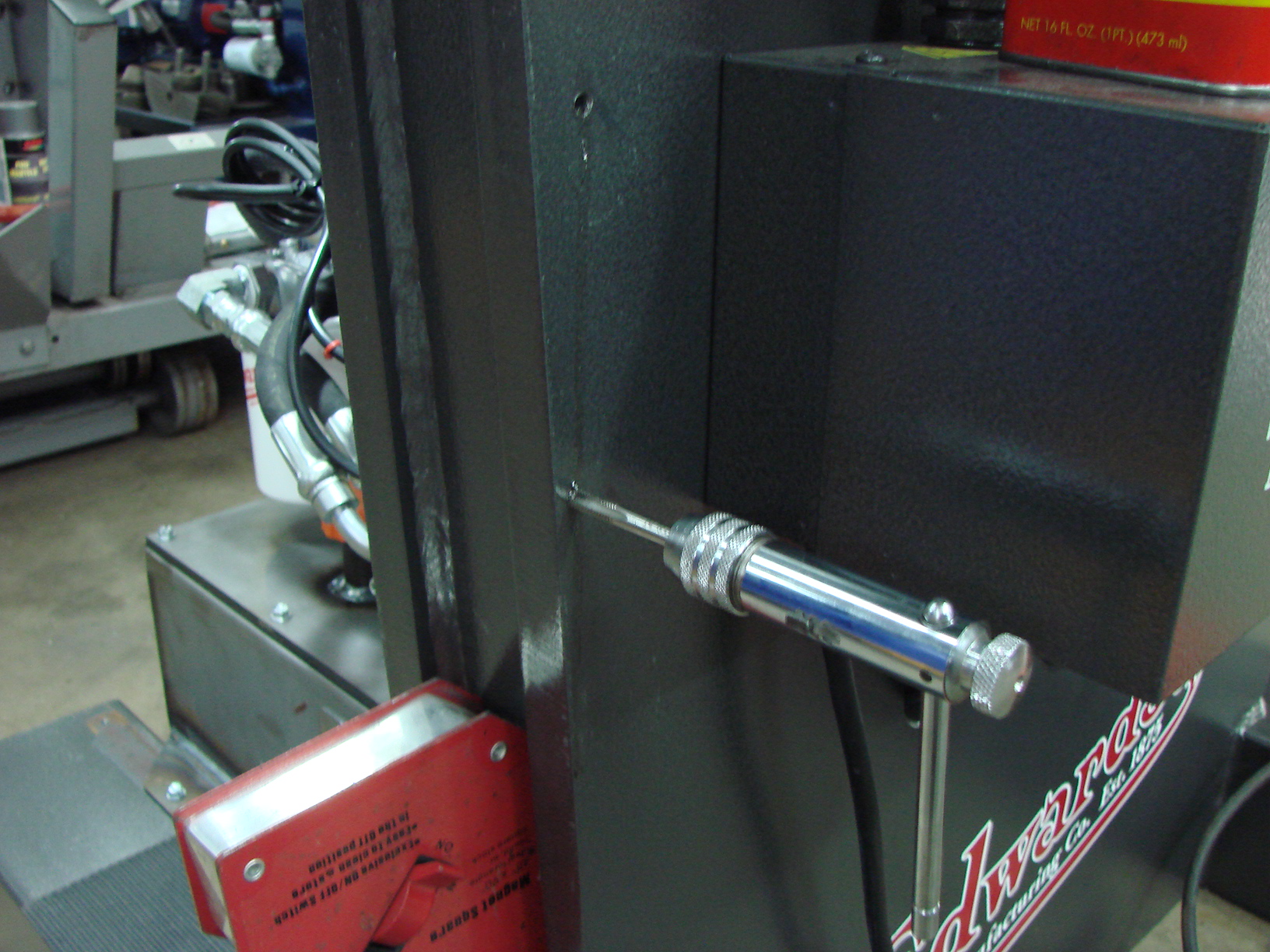

After I milled the slots in the mounting brackets I tiged them on the boxes and then put the boxes in the bead blaster to etch them with the aluminum oxide . I then used self etching primer and then painted them. The boxes will hold about a gallon of water so there's plenty of room for what i need them for.
