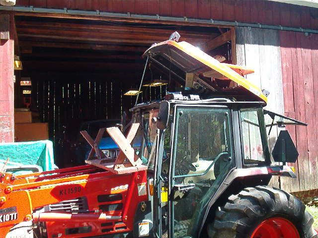

O2BATSEA, ITS QUITE SIMPLE THE ROOF OPENS LIKE A HOOD ON A CAR. UNSCREW A COUPLE OF BOLTS ON THE FRONT OF ROOF AND LIFT THE BACK IT'S HINGED. MINE ALSO HAS A PROP-ROD UNDER THE ROOF. IF YOU WANT THE WHOLE ROOF OFF ALSO UNBOLT AT THE HINGES. I HOPE THIS HRLPS FRENCHIE.

Thanks for the pic. I went and looked in the repair book and found this very thing. RTFM!
The repair book does take some creative interpretation...
