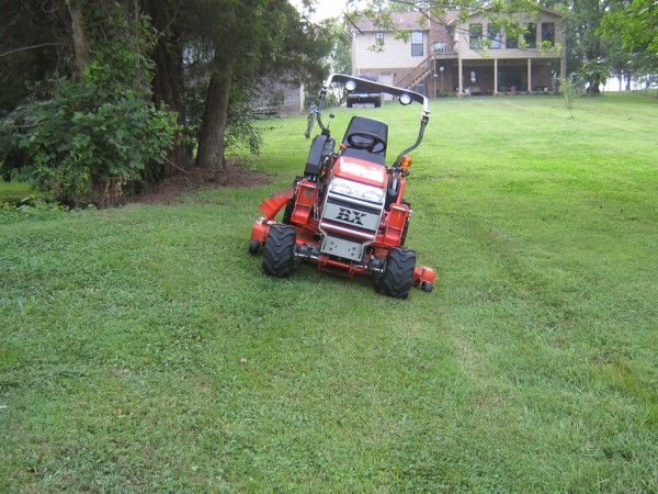

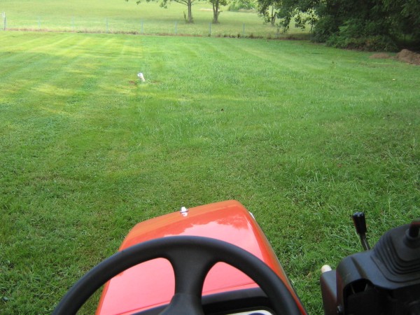

Don't know the angle but it's enough to make me shift my ample weight to counter balance :D
To the BX23's credit, it's not so much as lifted a wheel but going slow definitely helps.....

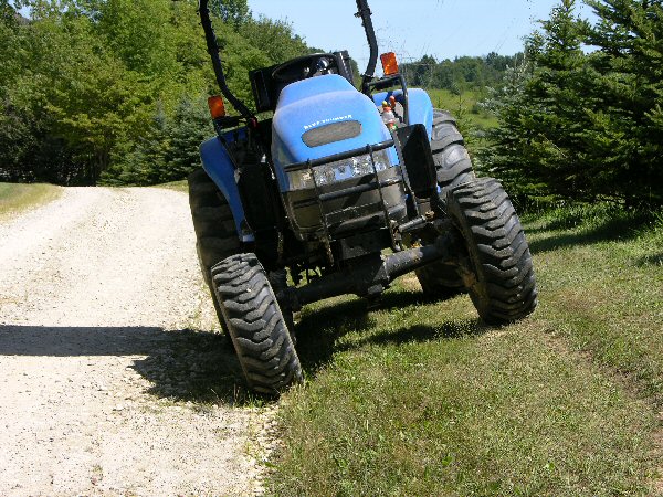

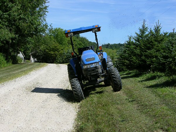

Our property has very few level areas. Most is rolling or hilly ground. The steepest area that I mow with the 40D runs parallel with the drive. The tilt-meter says it's only 18 degrees at this point, even at that it really gets your attention.
The back of the dam is most likely the steepest area on the property but I will only mow it running straight up and down as it gives my the willies otherwise.
Mike, I have one place along my frontage to a county road that is a little steeper than your 18º slope. It's covered in gravel at the top. My tractor will slip sideways on the gravel. I always think that if it were the same situation and I was mowing beside a pond dam, I couldn't do it. For example, if you driveway was a dropoff to a stream instead of a flat driveway, you would not dare mow the same way you do now. The situation and location of an 18º slope dictates whether it is safe to mow across or only up and down.
