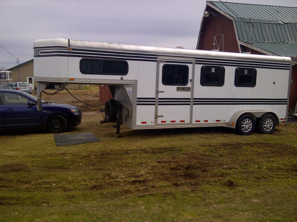

My older horse trailer had just this uphill slant when I bought my new truck, even after the gooseneck adjustment was compressed as much as possible. It is more of an issue than you are indicating here. When the trailer is slanted uphill the front axle tends to lock the tires a lot more easily. I found that when the trailer was empty I had to really lighten the power on the brake controller or it would lock the front axle tires under normal braking circumstances. That meant much more of the braking was left to the truck. It also meant that if something happened in front of me I had to hit the brakes hard and let the front trailer tires lock, just in order to get the back tires to give sufficient stopping help. It is not much better than having brakes on only one axle. When the trailer was loaded and the truck had squatted a bit it was better, but still not ideal. The front tires would still lock more easily and so I was stuck with a compromise between turning down the brake controller which gave less stopping power from the trailer brakes and was hard on the truck brakes, or turning it up and accepting that the front tires were going to lock in any sudden braking situations. Both settings meant that I could not stop as fast as I should in an emergency.
I did not make any changes to the trailer axles so I cannot comment on that, because I ended up selling that three horse and getting a 4 horse that sit level with the truck when adjusted properly at the gooseneck.
   / Can I "lift" a horse trailer #18
All of which is practical proof that your axles were not equalizing the load as God and Dexter intended. If I may ask, did you have TorFlex or conventional spring suspension?
   / Can I "lift" a horse trailer #19
Neither God nor Dexter have communicated their intentions to me, and I don't know anything about the axles. I do know it passed safety inspections every year and had at least one brake job done by a local trailer dealer during the time I owned it. It was in good shape and regularly maintained. Best I can do is show you what it looked like
and what it looked like after a tire shredded itself on the highway and ripped the fender off. Determine what you can from that.
also found a pic of the other side with the tire off, it shows the axle better.
   / Can I "lift" a horse trailer #20
As near as I can tell by going to photobucket and looking at the pic directly on the site before the "hosting" page pops over it, yes that used torsion axles.
