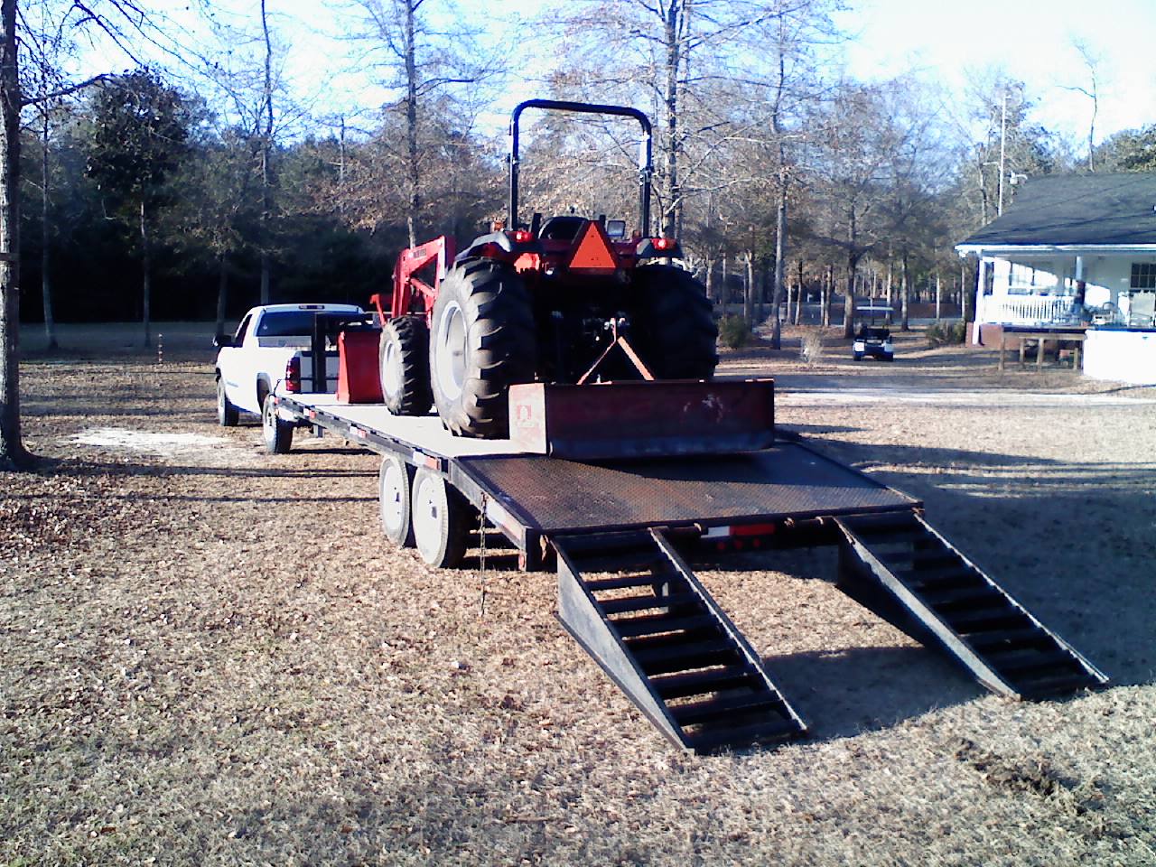

Thanks for all the replies, I'm new at this and see the reason for manufacture ratings to prevent liability issues but common sense has to come to play also........I don't understand how by having a diesel engine can allow you to tow 3-6000 more lbs. The chassis are the same, the brakes are the same so the diesel can pull up the hill or from a stop faster because of torque but how is it safer when it comes to sudden stops etc. Maybe I'm missing something here. I know a gooseneck will pull my 6200lbs tractor a whole lot better then a bumper pull and prob safer....but, it puts me overweight because of the heaviness of the gooseneck trailer. For instance I have a 6200lbs tractor, 1000lbs implement-chains-etc, and lets say 4800lb gooseneck....totaling 12000lbs.....by my vehicles specs 2003 chevy 2500 6.0l gasser I'm 1400lbs overweight but if I had the 2500 duramax diesel same truck it is ok. It makes me scratch my head with what to do............some of you say stay within manufacture limits and some say no problem...pull it. Thanks Mike

Heres my 2 cents. You will be absolutely fine with your truck.You only NEED a 9900 or 10K trailer,if you see yourself buying a bigger tractor or heavier attachments,go with a 12K now,otherwise most 10K 20 fters weigh around 2000-2300 lbs,leaving you 7500lbs easily for the load,which has you covered.In addition you will be putting close to 1000lbs on the trailer tongue,so your trailer axles will be under or around 4000lbs each,on a 5200 axle,no problem there.Your tow vehicle is plenty for the average user,a diesel isnt necessary at all,your setup is very safe,I would consider adding a stronger hitch than the factory one,thats the weakest link in your setup now.

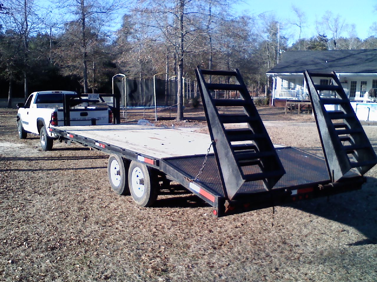

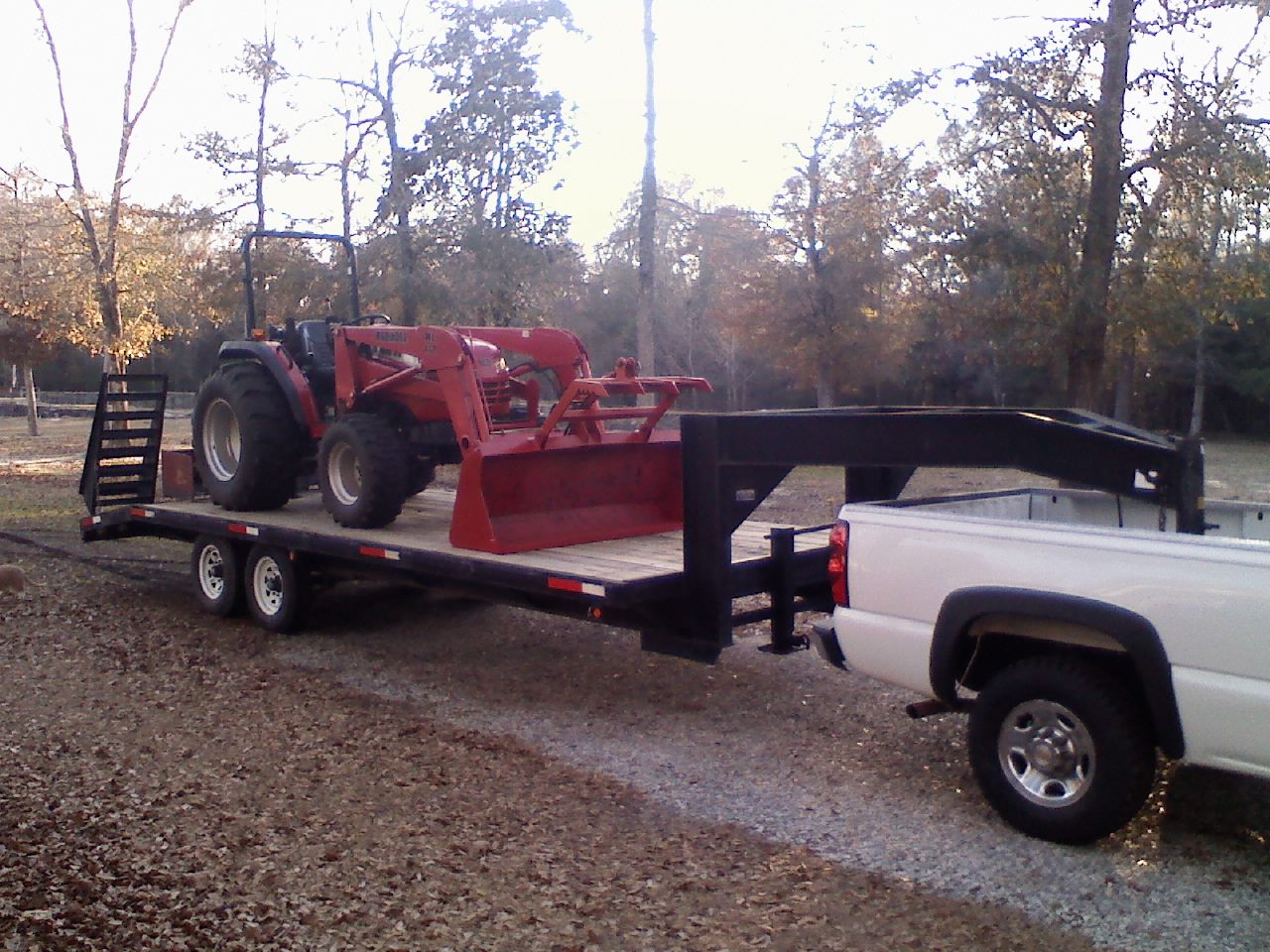

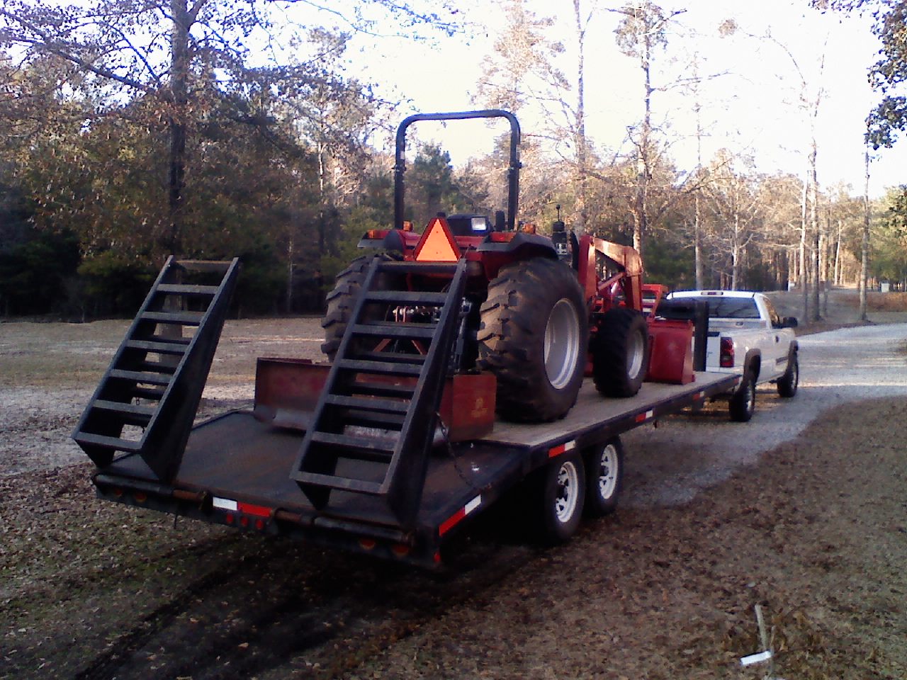

I went ahead and got a Gooseneck. It is a 8' x 20'+4' dovetail with two 7k axles with brakes. I bought it used, it is a 2005 (year) model and made by Black Brothers....never heard of them but the trailer seems to be made nicely. I was really impressed how well the trailer pulled behind my 3/4 ton Chevy and was alot more stable then a 10k bumper pull that I borrowed. I know I'm overweight with this trailer, like Diamondpilot said, " this trailer is half my tow rating," but the 6.0 gaser didn't strain to much and there isn't any mountains here and now I have a bigger trailer for when I upgrade my truck. Thanks for everyones input............Mike

Looks like a nice balance setup. Just curious what that trailer weighs empty? Looks like its on the lighter side for a GN of that length which is a good thing in you case. Thanks for the pics.
Also be careful with that diamond plate tail and wet wheels or frost.

Chris, I have no idea, I'm guessing 4000-4500lbs. Would it be on a data plate somewhere on the trailer? I will look tomorrow and see. Thinking of what I can weld on that diamond plate for better traction, maybe some angle or rebar........any ideas?
   / Can I trailer this tractor #20
Not sure on the weight but it is only on some states titles. May or may not be on the data plate. I weight all my trailers and trucks. I first take the truck with just me in it and 3/4 tank of fuel. I then go back to the same scale with my trailer on the truck and weigh the rig then do the math. I have a label make so I make up a sticker and put it inside the trucks door and then one on the trailer with the data. Kind of **** but I tow so much and own 3 trucks its the only way I can keep it all straight. I live 1.5 miles from a gravel pit and they weight me for free since I buy product from them time to time.
As for traction I would get some no skid black paint and try it first. They put a sand grit in it.
