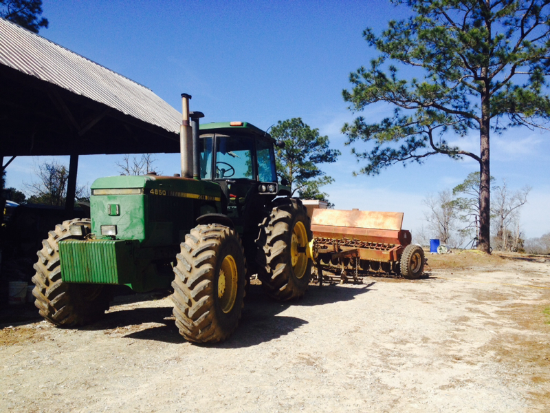

I agree with you TomSeller, but I don't use that set up for anything but decent sized limbs. If I've got something big I chain it to my 4850. I've got 20 weights across the front of the 4850.
   / Can I use this to drag logs? #22
<img src="http://www.tractorbynet.com/forums/files/attachments/377672-can-i-use-drag-logs-image-3026710683-jpg"/>
Nice tractor. I bet you get traction with that. Set for dials Ipoh the rear as well. Cool.
