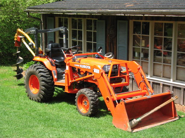

I need to put in a lot of fencing the summer and need a PHD. I have a BH on my B7500 with a 10" bucket and have been thinking I might as well give that a try first. Since the cost of shipping the PHD up here in Alaska brings the cost to over $1,000 I am seeking either confirmation or denial that this is a feasible alternative. I also have lot of rocks just a few feet or less down below topsoil so maybe the bucket would work better anyway. See I can rationalize any money saving scheme on my own. Seriously has anyone had experience with using a back in like manner to dig post holes for a bunch of fence posts?

LateBloomer: .....I think your B7500 & your BH with a 10" bucket would probably work nicely, especially if you're going to encounter rocks anyway. Plan on 30" - 36" diam. holes. or if your lucky a 10" x 36" slot.
I dug approx. 20 holes with a 12"auger / PHD last spring, one hole was clean and full depth (42") all the others had to be partially finished by hand because of tree roots or stones jamming the auger. Always plan on rocks effecting your outcome. And since you can only have one on your tractor at one time (BH or PHD) it's your call. /forums/images/graemlins/frown.gif /forums/images/graemlins/smile.gif....RayBee
p.s. Also not shown & needed is prybar and hand hoe & shovel . /forums/images/graemlins/frown.gif

Great responses all, I appreciate the input, especially about the rock encounters. Ray your picture kinda of says it all. I guess I should not drop over 1K on a PHD and think that my troubles are over. I don't mind the extra time to dig with the BH, suppose the backfill will be more time consuming however. Sure like the idea of just dropping a PHD in a line of fence holes and neatly finishing a section in short order but reality is reality. Judging from what I have found so far on my property there are going to be plenty of surprises a foot or two below the surface. This valley is all glacial moraine.
