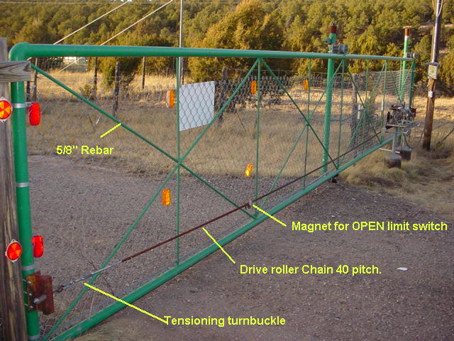

Pic 1
Overall picture of the gate.

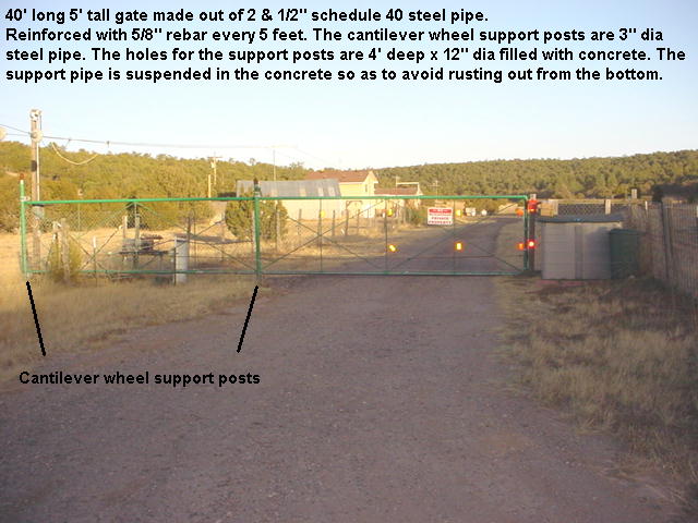

Anyway here are the basic details of the gate:
40' long 5' tall gate made out of 2 & 1/2" steel pipe.
Reinforced with 5/8" rebar every 5 feet. The cantilever wheel support posts are 3" dia steel pipe. The holes for the support posts are 4' deep x 12" dia filled with concrete.
The pipe is suspended in the concrete so as to avoid rusting out from the bottom.
This type of gate is “Cantilevered” I.E. suspended by wheels attached to posts and balanced by it’s own weight. The advantage is that it opens & closes no matter how deep the snow gets as it does not touch the ground. The disadvantage is that the gate must be twice a long as you want it to open + about 1-2 feet. And if purchased and installed cost mega bucks about 5 to7 thousand dollars. This was built by me at around 1 thousand.
The remote control electronics are from an automatic garage door opener.
The real trick was to interface those electronics to a more powerful 1.5 hp reversible motor with an electric disk brake and 90* gear reducer to drive the whole thing. Being an Electronics Engineer with access to some “Spare” relays, & SCR’s etc sure helped. The pipe, motor, disk brake and gear reducer are what I “stole” from the elevator.

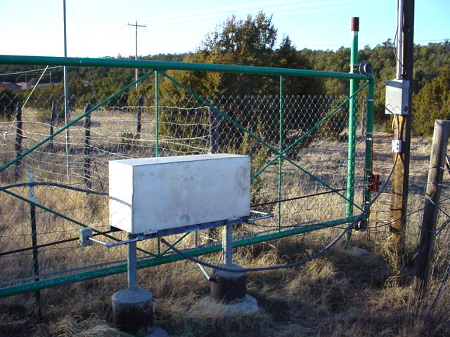

Pic 2

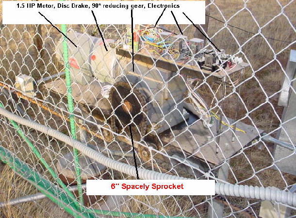

Mechanical & Electronics Control Box cover – Fabricated by a duct work sheet metal shop in Albuquerque, NM. Inside is what moves the gate and is cemented into the ground four feet. You might notice the drive chain in the background and the conduit that houses the magnetic limit switches

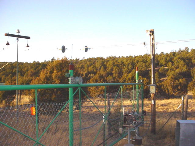

   / Cantilevered Driveway Remote Gate
Pic 3
Angle view of gate with drive chain, tensioning turnbuckle & Magnet for limit switch.

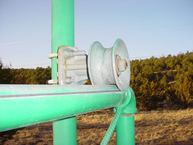

Close up of a “Cantilever” wheel – it has needle bearings that I grease.

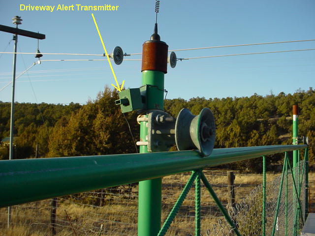

Pic 6
Driveway Alert Transmitter
I work out of a home office and my Wife is a full time homemaker. We need to know when Family, Friends, Neighbors UPS, FedEx & the “un-desirables” show up at our driveway. We installed a Driveway Alert Transmitter with a 1000 foot range. We also have a means of opening & closing the gate from the house as well as with any of our remote transmitters in our vehicles, tractors, ATV’s etc.

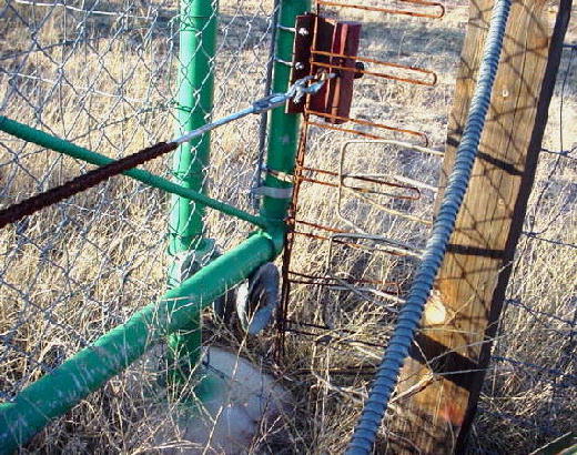

One of the lower Cantilever support wheels with drive chain tensioning turnbuckles.

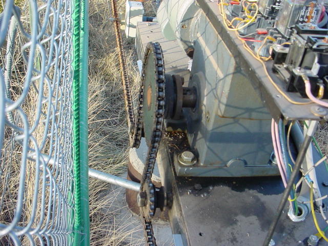

Pic 8
1.5 HP Motor, Disc Brake, 90* reducing gear & electronics.
One of the tricks was to get the disk break to disengage prior to starting the motor. I did this with an electronic time delay for the motor. The reason I used a disk break was to stop the gate INSTANTLY when commanded by any of the limit switches or the remote control. There is a large amount of inertia from the motor & the weight of the gate.

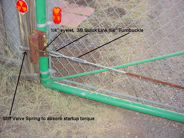

Details of how the drive chain is connected to the ends of the gate.
