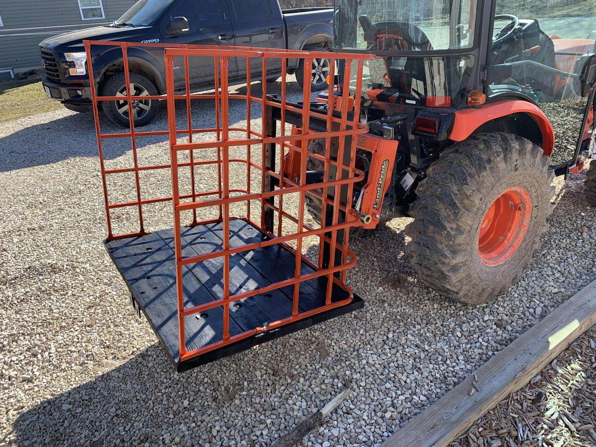

I keep adding chainsaws to my collection. I used to have terrible debris tines on my bucket, and they moved around all the time. I made my own debris fork out of them, and now I have no bucket when I use the fork. That means I can't put saws in the bucket.
I have a Titan ballast box I can put one saw in, sort of. I looked at the Sawhaul, but it seemed extremely expensive for what it was. It looks like it ought to cost $75 instead of $179. Also, I don't want saws hanging in front of my loader zerks, and it appears the Sawhaul will only let you carry one bar length. I have 16", 18", 20", and 24" at the moment. On top of that, the bar rests on the inside of a plastic scabbard, and I have no faith in that lasting long. And you can't put a gas can, chaps, a hatchet, wedges, tongs, a tow strap, files, screnches, or a chain in a Sawhaul.
The ballast box has a receiver in it, so I decided to try a folding cargo carrier, like the ones old folks use to carry their mobility scooters. Is anyone else doing this? The one I picked has a lot of room, and the side walls are solid so stuff can't fall out. It has no floor, but I can throw some plywood in there. It will fold up against the ballast box when empty, so I will still be able to get the tractor into my shop. It should hold two big saws plus a lot of junk, easily.
I was thinking I should have just dropped some goat fencing across my forks and put stuff on that. It would be free. I could fix it so the fencing hinged up against the vertical parts of the tines when not loaded, to keep logs and whatever from coming back at me. Maybe I should have gone that route.

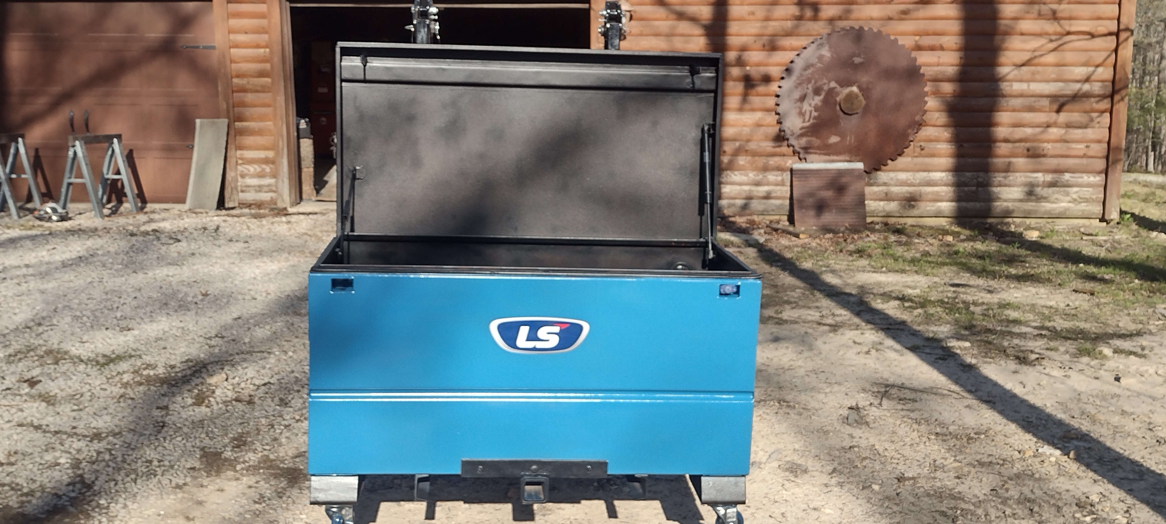

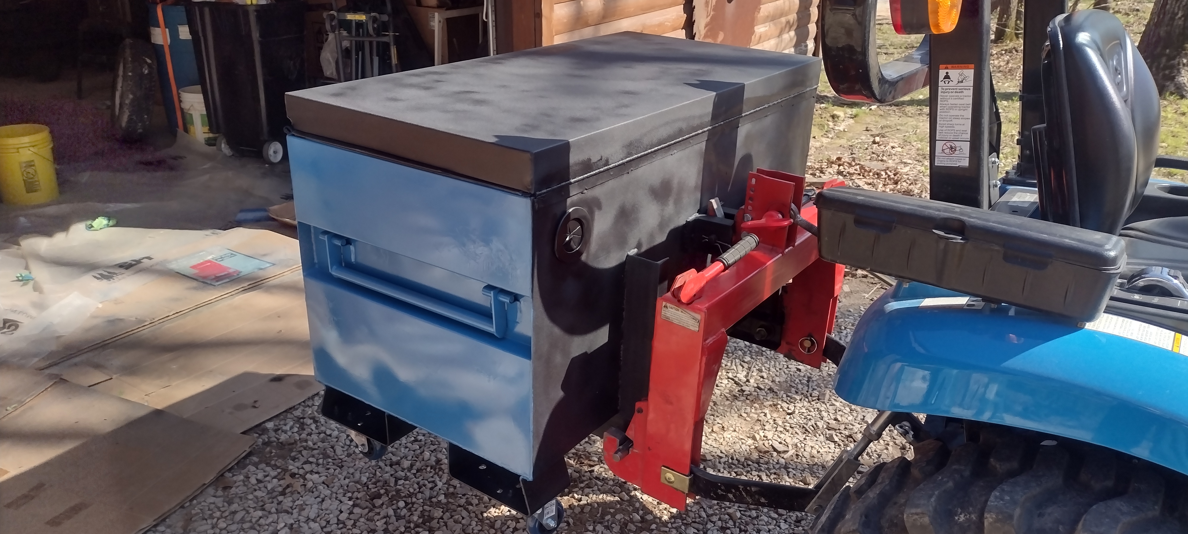

Here is what I did. I took and old job box and bolted/welded some 3 point attachements on in. Added a trailer hitch welded & bolted to the bottom. Added several hundred pounds of bagged concrete in the bottom for ballast. I have a wooden false floor covering the concrete. It comfortably holds 2 chainsaws, 2 gas cans, cant hook, and 2 buckets of chains. I have added larger 10” pneumatic castors since these photos were taken. Here is a link to my YouTube build playlist if you are interested in looking.

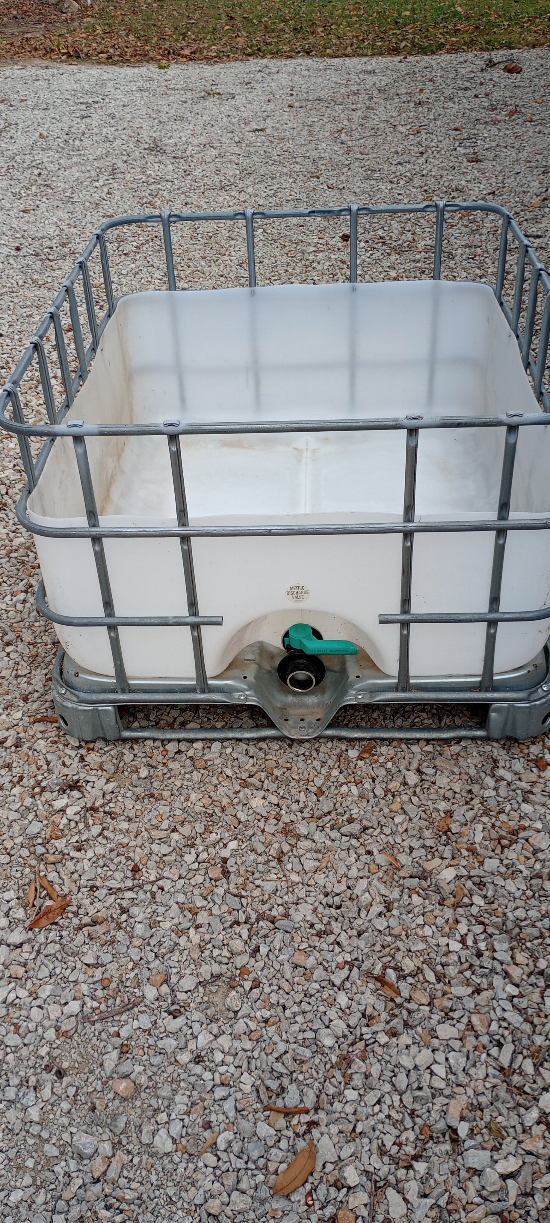

You can make a simple Carry-all out of an IBC tote. Then mount all the chain-saws, axes, shovels, etc in it.

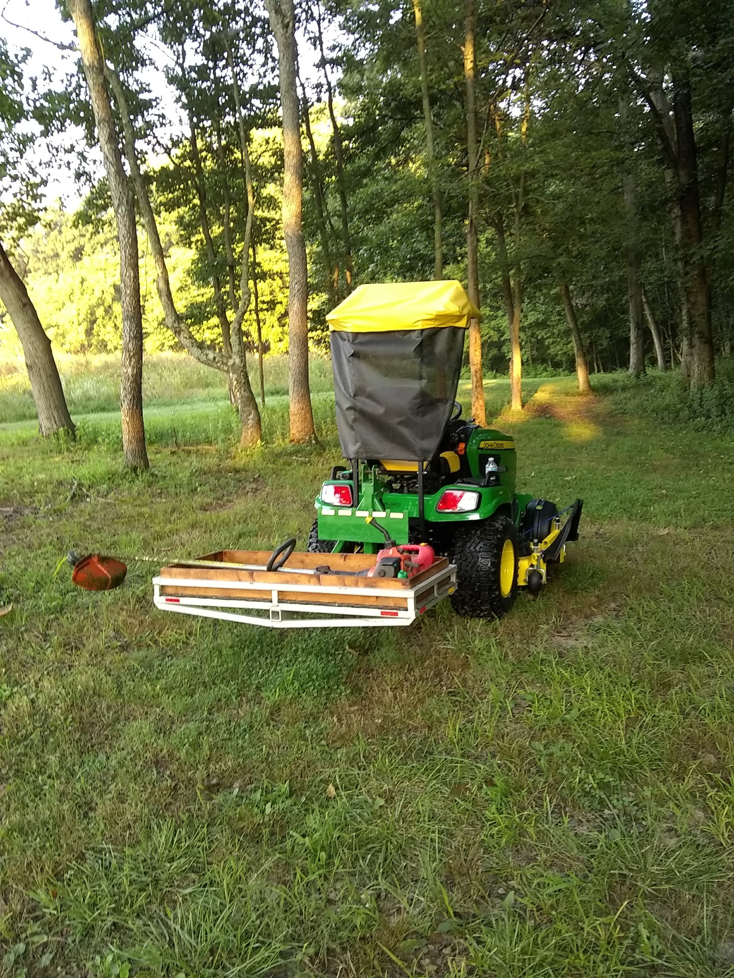

this plug into your ballast box. Add a wood frame to suit your needs
300 lb. Capacity ATV Cargo Carrier

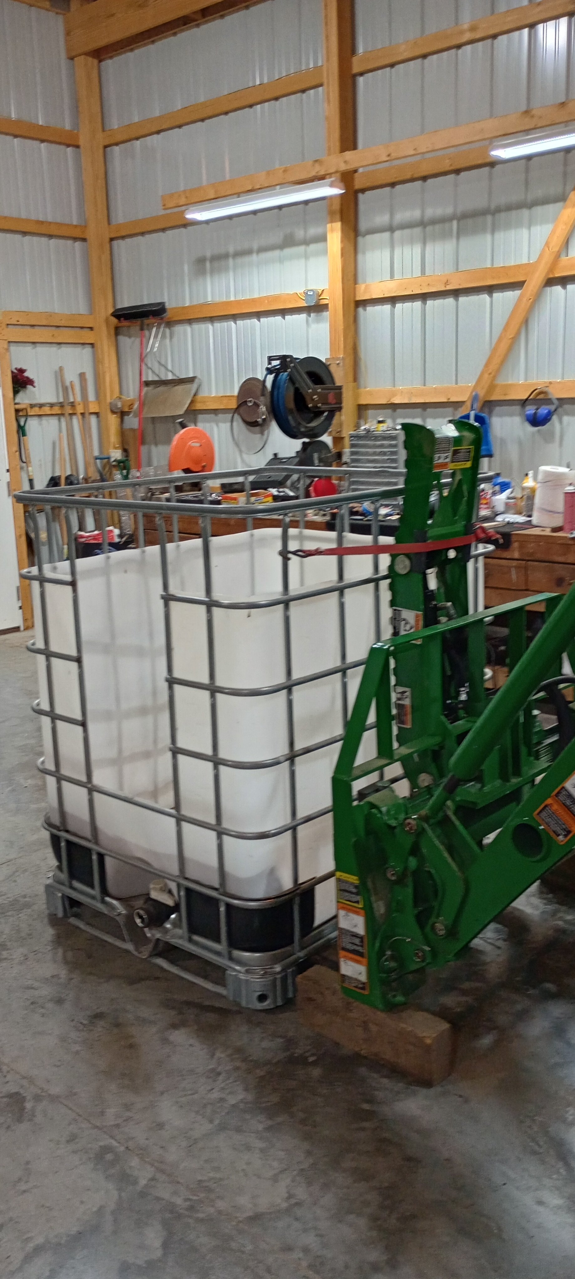

I agree with the IBC tote, they are easy to come by and cheap. I made up a couple, the short one is for chainsaws and tools in general. I put it on my pallet forks, carry tools to the job site. Back out from under it. Then use the forks to stack the trees. The other one is for getting up to other tasks safely, of course you need an operator, works good for higher tree limbs or blowing out gutters safely. The basket works good on the x758.
