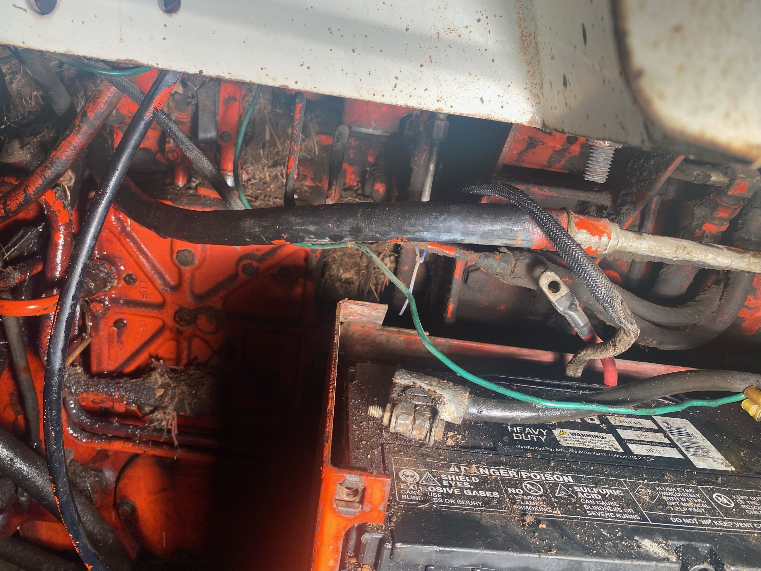

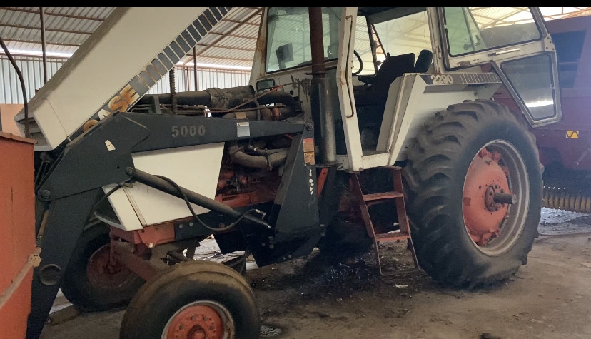

trying to fix my case 2290's hydraulic leak
ive identified the leak to the hose that runs from the hydraulic pump to the main controls in the cab, i cant for the life of me figure out how to remove the hose, it spins freely but doesnt unscrew, and its not a push pull release

#11 is the hose i need to replace

If it's the hose in your photo, it's not mean to come apart. You replace hose, line,and all as a unit.

including the hydraulic pump? if not where could i find a replacent?

No, not the pump. The line will separate on the end of the steel portion.

it’s been to many years to remember exactly which ones but some of those lines you have to lift the cab to get them out. It’s a long days work. The maintenance book tells you which ones.

how would i get it off the hose thats connected to the hydraulic pump, spins free but doesnt unscrew

This really doesn't make sense. I could see the hose turning but if the nut turns counterclockwise it has to unscrew. Do you have a wrench on the nut?

Are you able to provide us with some more pictures where the hose enters the pump?
