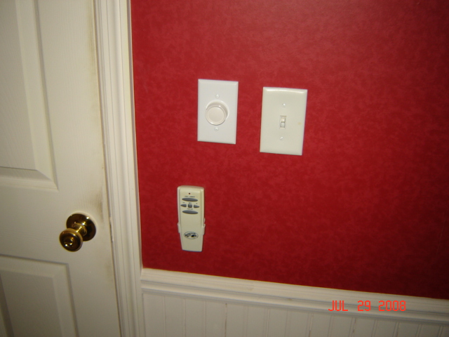

The easiest solution at this point would be an add-on wireless RF remote. I installed half a dozen fans in our current house much the same as yours (most are Hunters but different models). The only fans I didn't add remotes to are one in the living room that has a built in remote & two that have too small a base to accept the remote unit (I could have put the remotes in the attic I guess). These make the chain problem a moot point. I used the Hampton Bay remotes & they all work correctly & are still on their original batteries (almost 4 years old).
My GF's office fan pull switch failed in the full-speed position. Slapped an extra remote on it & she now has speed control again! MUCH cheaper than replacing the fan, & much easier than replacing the switch!
Pulled the globe on my Hunter & I agree, that pull chain routing (comes out of the unit on the side, about 2" off center, goes through a plate with a nylon bushing about 1/2" off center to keep it away from the bulbs, then through the hole on the globe center about 1" off center) is hokey, but it's something I've never had to deal with because of the remotes!
Attached is pic of the remote, which sits in it's hanger below the light switch & exhaust fan control.
