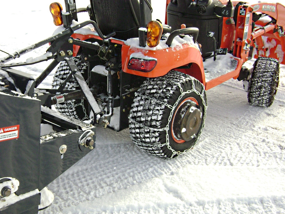

   / Chains for BX #5
This is my rig, no issues besides fantastic traction. Just have to make sure that the front chains are TIGHT.

What are those disc looking things on the outside of the hubs?
   / Chains for BX #7
Wheel weights...for more traction. They look like old cast iron weights from a free weight set to me.
Can't get a lot of liquid fill in those small tires of the BX series tractors.
   / Chains for BX #9
Ah ha..... would this help in the dry?
Depends on what you're doing. They help with loader work (but ballast on the 3PH is better, IMHO). They also aid in stability of the tractor.
Might not be so good if mowing is the primary function of the tractor though.
