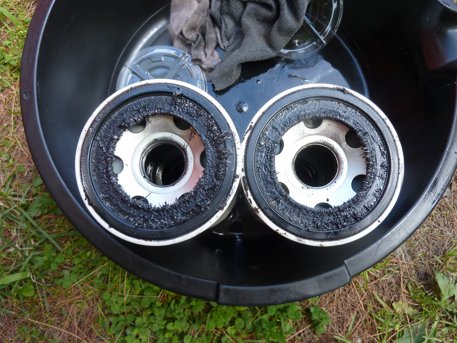

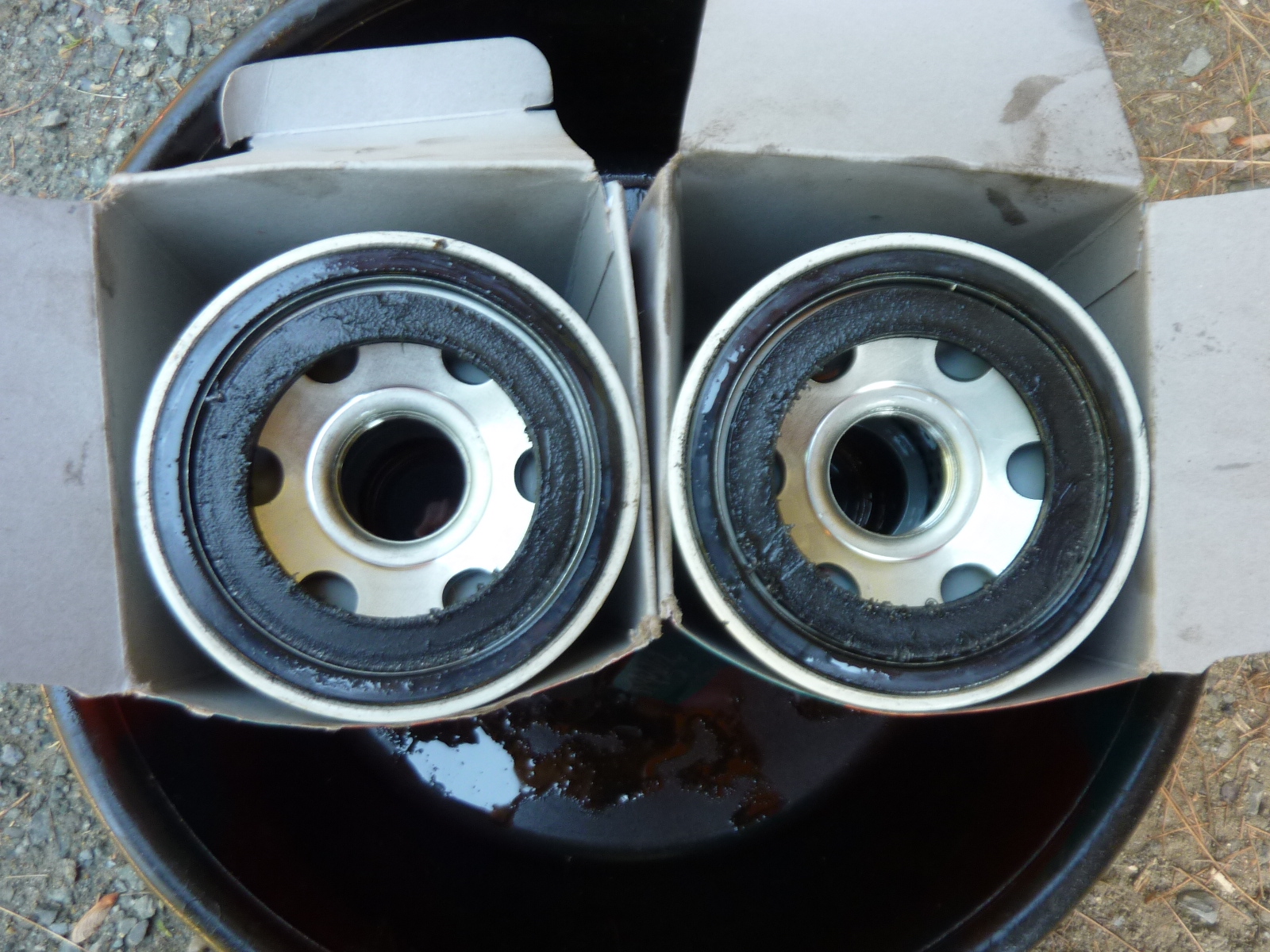

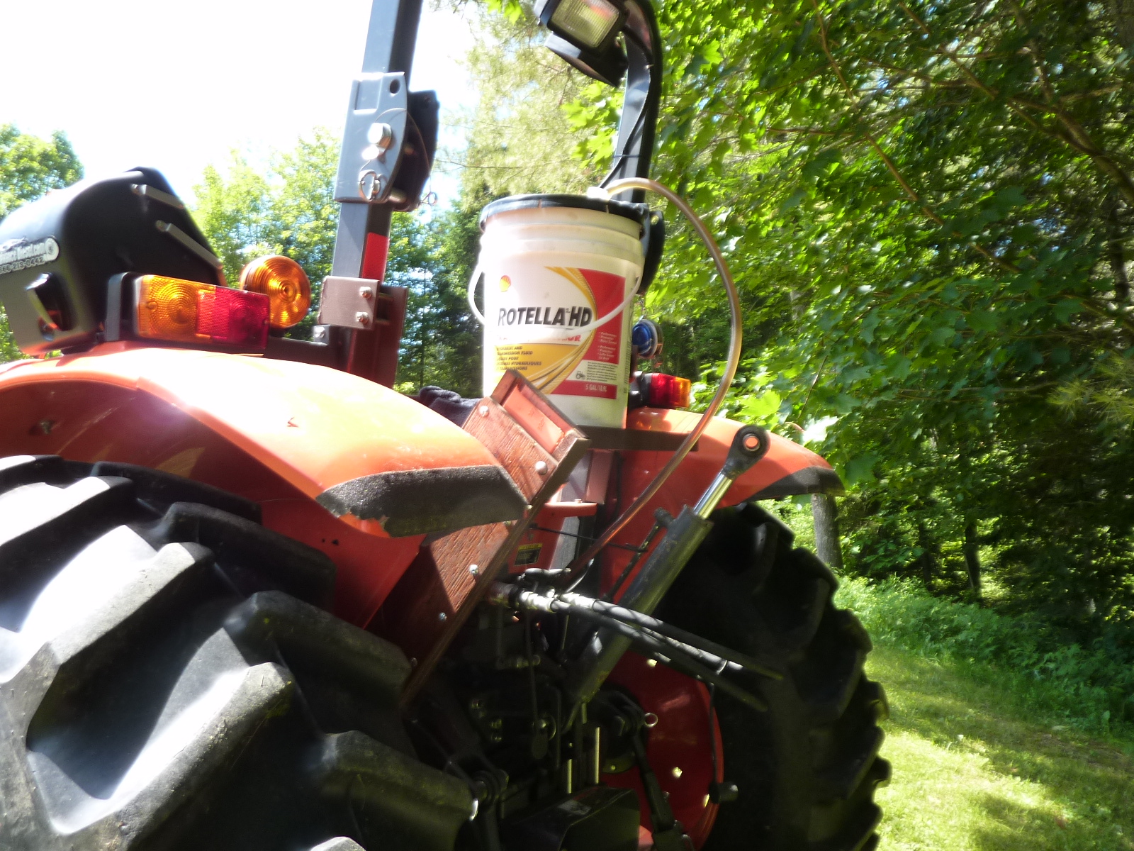

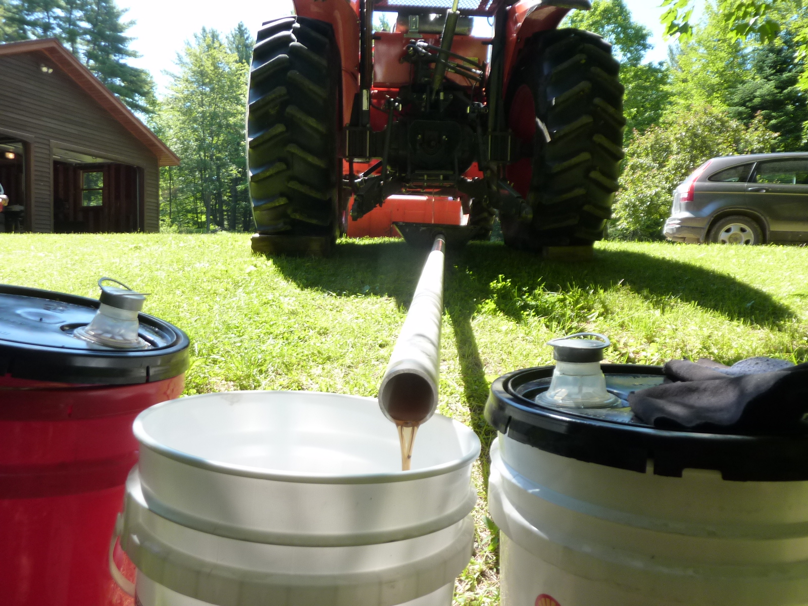

On my M5640 I have to change the hydraulic filters once between Hydraulic Oil changes. The filters are at the bottom of the sump so I have to drain the oil and then put it back in after the filters are changed. I back to the top of a bank and place my oil pan connected to a 10' pvc pipe down to my clean buckets. The system holds 10 1/2 gallons so I partially fill 3 buckets. I cut a hole in an old pan and used a standard shower drain for the pipe connection. When I'm done I use a rattle siphon hose to replace the oil I drained out. It leaves less than 1/2" in the bottom of the bucket. Every thing is easy to handle and no mess.
It is normal for newer Kubotas I guess but still disconcerting seeing this much crud on the filter magnets but it is way less this second change than it was the first filter change.

   / Changing Hydraulic Filters w/o Changing Fluid #4
Using the pcv pipes and gravity, it was looking like a maple syrup operation. At least you didn't have to cook down the oil before you put it back in the tractor! :)
I never thought of it like that but you are probably right - buckets and pipes are in my genes.
