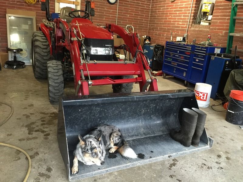

I posted this up on the New Holland forum a few days ago but have not had any responses, let me know if you have any ideas please!! I don't want to damage a hydro pump.

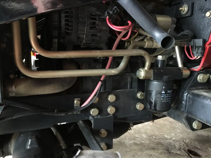

I have a Case DX33 FARMALL (TC33DA in red paint) and I have noticed some chattering type noise from the line that connects the HST filter housing to the cooler. I have checked the hose clamps that would typically cause air leaks in the system, I changed the HST filter but I am not sure where the suction screen is so I didn't clean that. The fluid is at the correct level from what I can tell, I have been checking it with the FEL on the ground.
I have not yet tried a hydro fluid/filter change as I plan on picking up some AMSOIL but just have not wanted to spend the money on it yet. I did want to get the synthetic AMSOIL in there before winter and I guess this will just be a reason to get it in there now. I would like to rule out other possible problems as I don't want to get the new expensive hydro fluid in there and have to drop the filters again or remove any lines to wast fluid. Ill pose a pic of the line I am referring to in a few.
its the longer line in the front view pic and the lower line in the side/filter view pic. My pup was just trying hide from the rain that we were getting when I took the pics.

Have you checked the hydraulic pump suction line for leaks? That is where I would start and it may be hard to find since it would be under a slight vacuum. Somewhere air is getting in the system or the pump is starved for oil is the most likely scenario. I would not use the tractor until the problem is fixed, limit the running time to diagnostics for the repair.

I did check the main tee in the hydro suction line but I guess I should look more closely and follow the suction line and inspect closely.

This shines some light on my issue!!! its an old post but good old Jim is still helping people after his time has passed!
I may (knock on wood) have quieted the noise some by tightening the hose clams on the rubber union above the filter housing.
