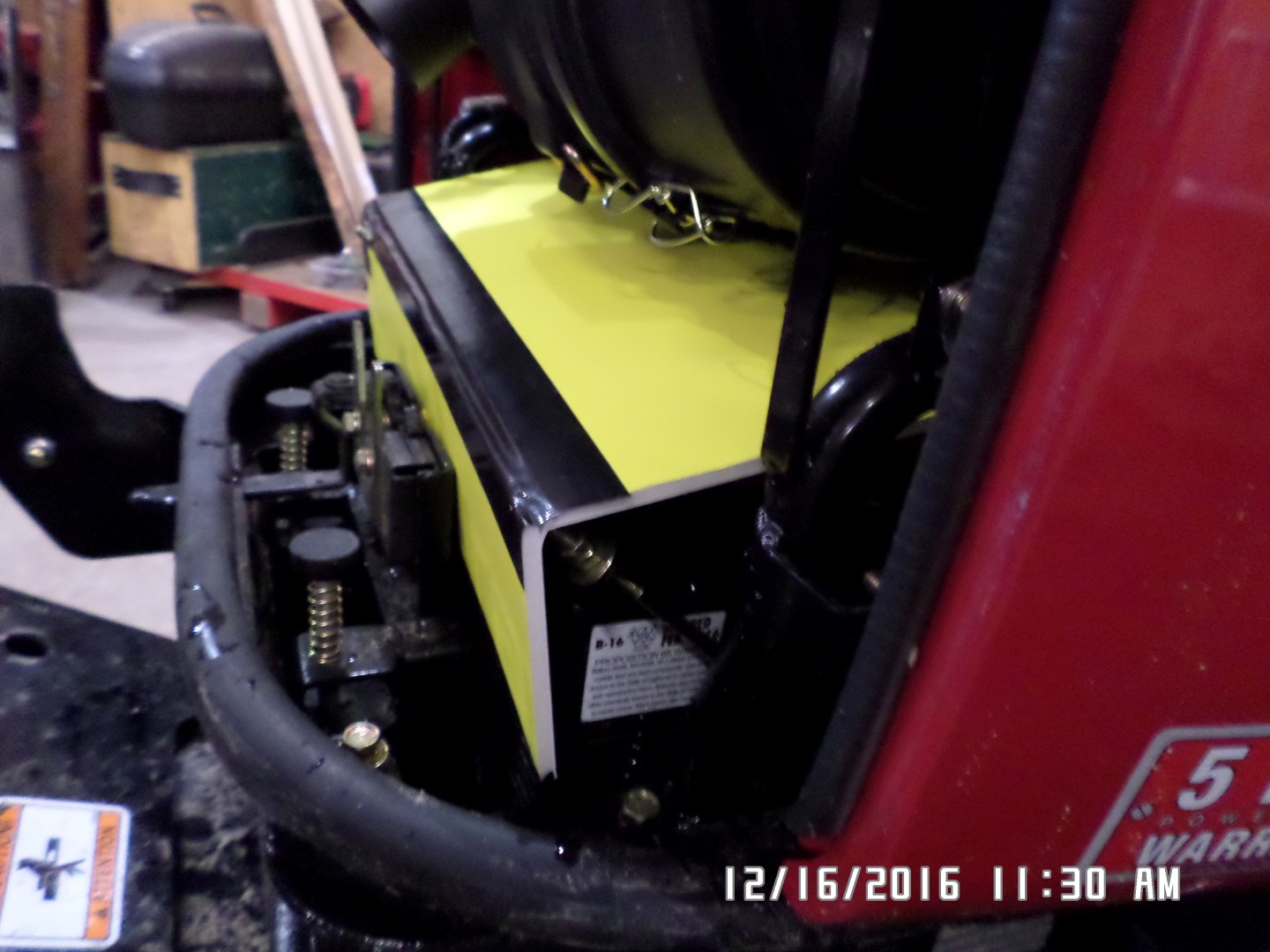

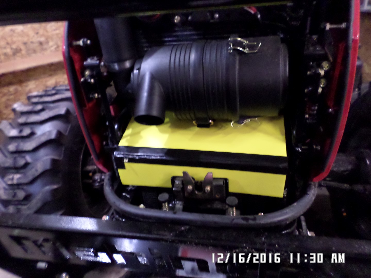

I had some left over Wally 1/4" sign foam board and made a quick cover/snow deflector for the battery. Whilst snow blowing the lake effect stuff, my battery was getting blasted with snow sucked into AC/hyd/intercooler/coolant radiators. Was finding icy blob on top of the battery at the end of running the blower. To keep this from possibly effecting the posts and connectors, I just covered it with some left over foam board from the radiator cover I had made earlier [ 12" center hole ]. Anywhilst, we will see if this keeps the top of the battery dryer. Getting a day off from the everyday road clearing duties today... :)

That looks good. Real nice. As long as it's not gas tight so hydrogen has a way to vent, you're good to go. That is unless you've changed the battery to an AGM type.

Nice job, Jerry, but I think I'd like to be able to see the terminals so I can see how badly they're corroding.

I will take it off in the Spring, if I am not too senile to remember... along with the cover I put on the radiator... AND, if I am still kicking... [[ :) ]]
