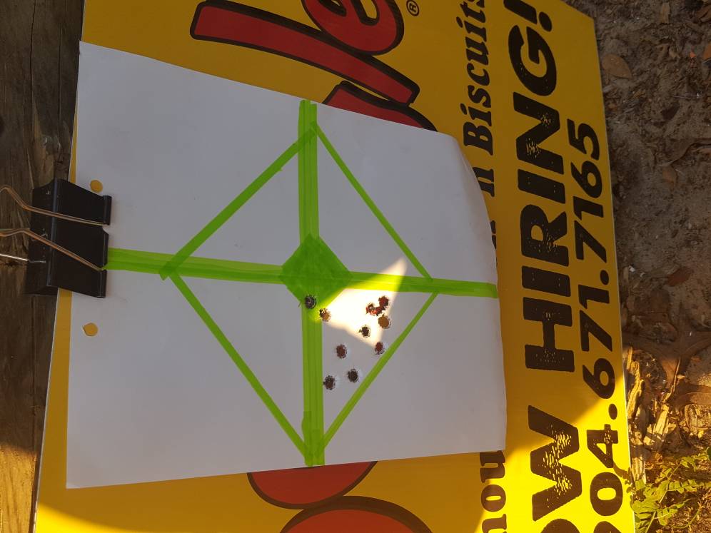

I just loaded up 50 of the 124 Gr Xtreme plated hollow points. 5.0gr CFE Pistol, 1.123" OAL with Winchester small pistol primers.
The Xtremes weight between 124.1 and 124.9 gr on a 10 bullet sample and diameter was 0.3545".
Just tested out 20 of the 50. 19 of 20 on function, one caught on feed ramp. Accuracy from the Hi point 995 at 15 yards was pretty fair for unsupported standing. uploadfromtaptalk1525909418245.jpg
Ejection was pretty weak, some landed maybe 18 inches away, so next time I may drop to 1.100" OAL, or possibly up charge to 5.2gr. I think I need to shorten OAL to help feeding, but 5.2gr seems to be the magic sweet spot.
I might load
10 at 5.0 gr at 1.100"
10 at 5.2 gr at 1.120"
10 at 5.2 gr at 1.115"
and see how it works.
I'm also intrested in if the Xtremes expand, might try that later, but they punch holes in paper...

Shoot some Xtreme 124 gr plated HP, 5.3 gr CFE Pistol, 1.100" PAL, Winchester small pistol primers today. Group was between 2-2.5" at 25 yards, with iron sights. Final round of the 20 test didn't lock bolt open, but could i dont know that was a power issue
